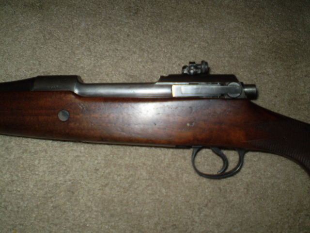

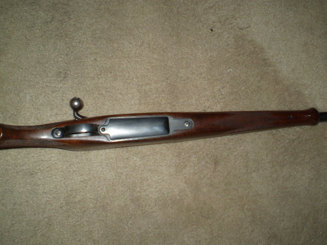

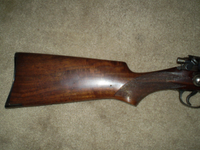

Here are pics of it.
- P7100038.JPG (166.84 KiB) Viewed 1871 times
- P7100034.JPG (166.7 KiB) Viewed 1871 times
- P7100037.JPG (163.77 KiB) Viewed 1871 times

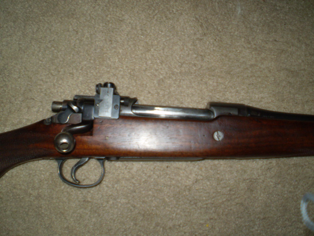

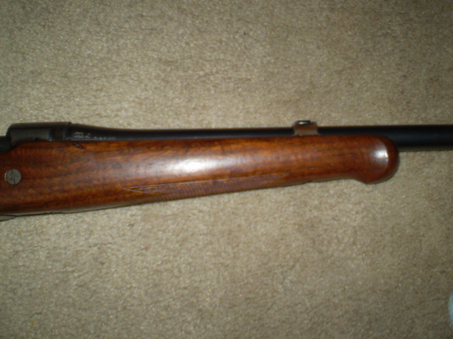

Two more.
- P7100040.JPG (168.02 KiB) Viewed 1870 times
- P7100039.JPG (167.01 KiB) Viewed 1870 times
