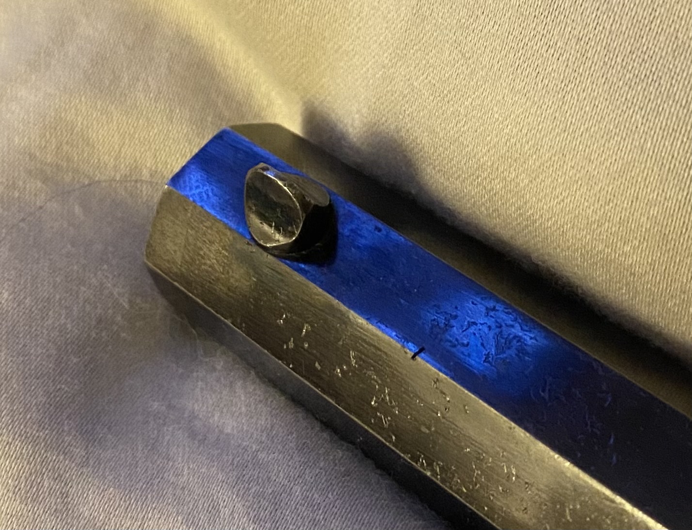

The sight is pinched see photo
The barrel S/N is clearly marked 7570

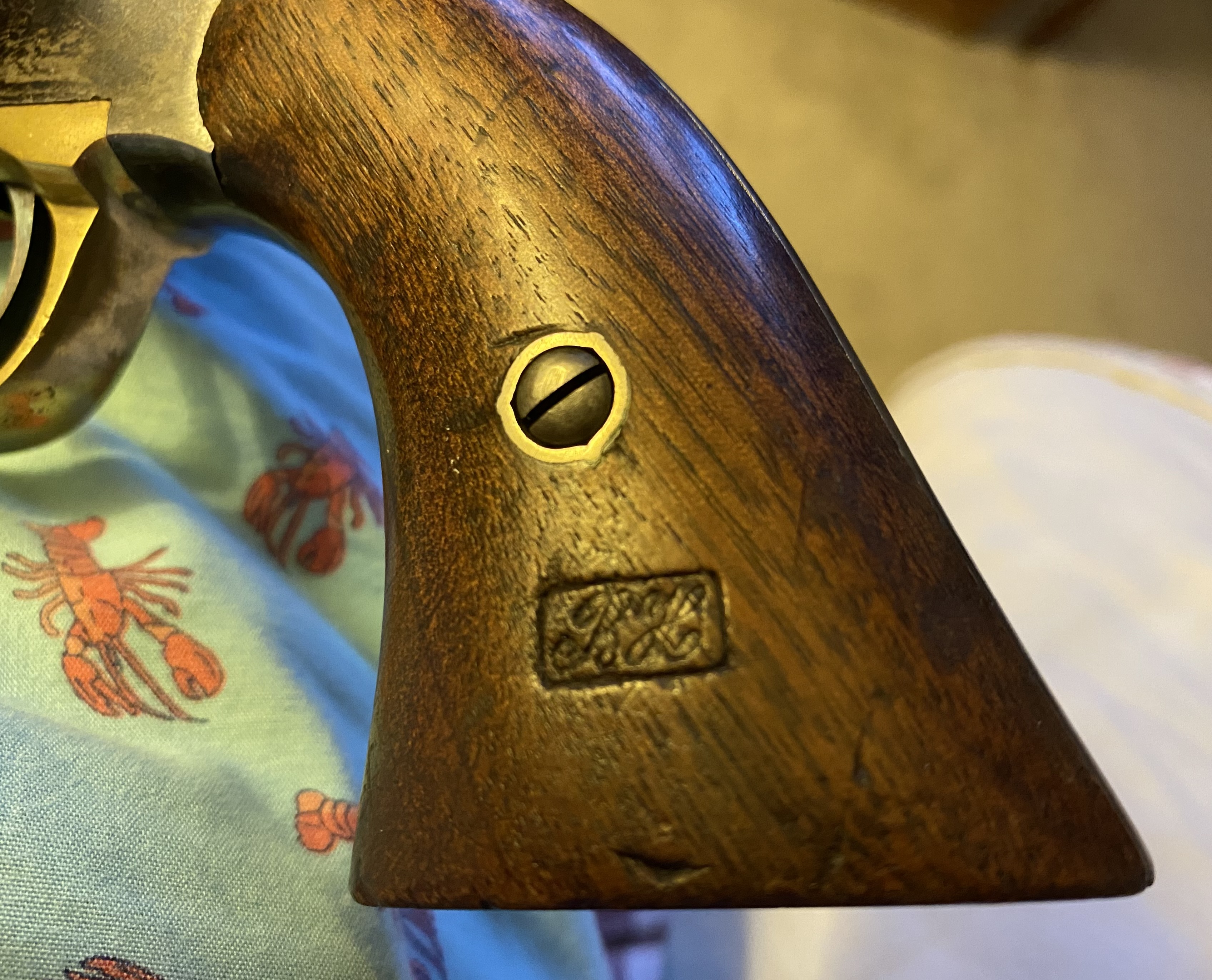

I have attached a further picture of the mark on the grip hopefully this matches records and a date can be identified

The ref 3734 should be ignored, it was the dealer’s catalog number sorry for confusion

Hi I think the first initial is either a R or a B and the second letter is possibly an L , hopefully someone who is familiar with such marks can identify

I think I have solved the inspectors mark , I believe this to be B H, for Benjamin Hannis', US Civil war inspector's grip cartouch

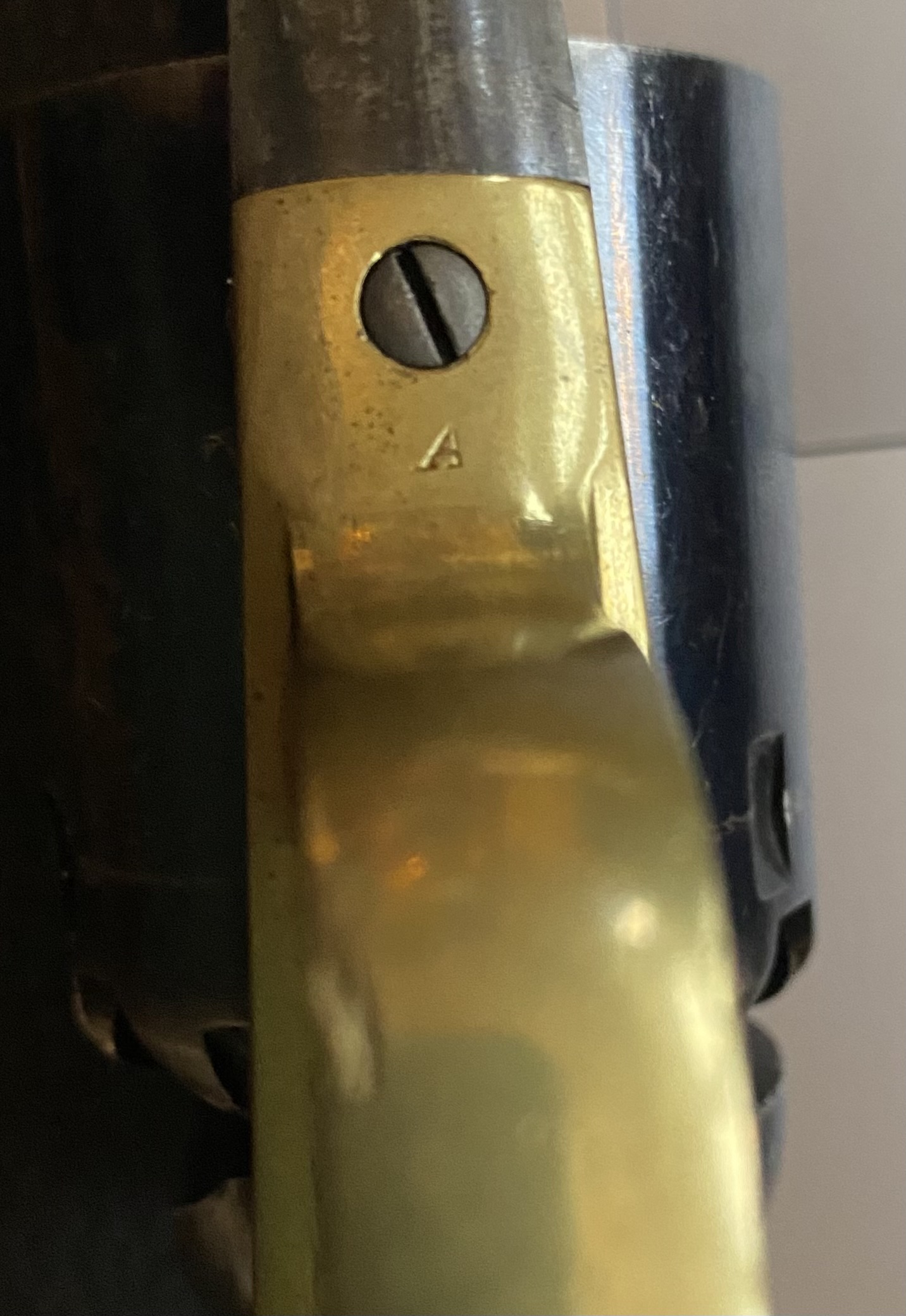

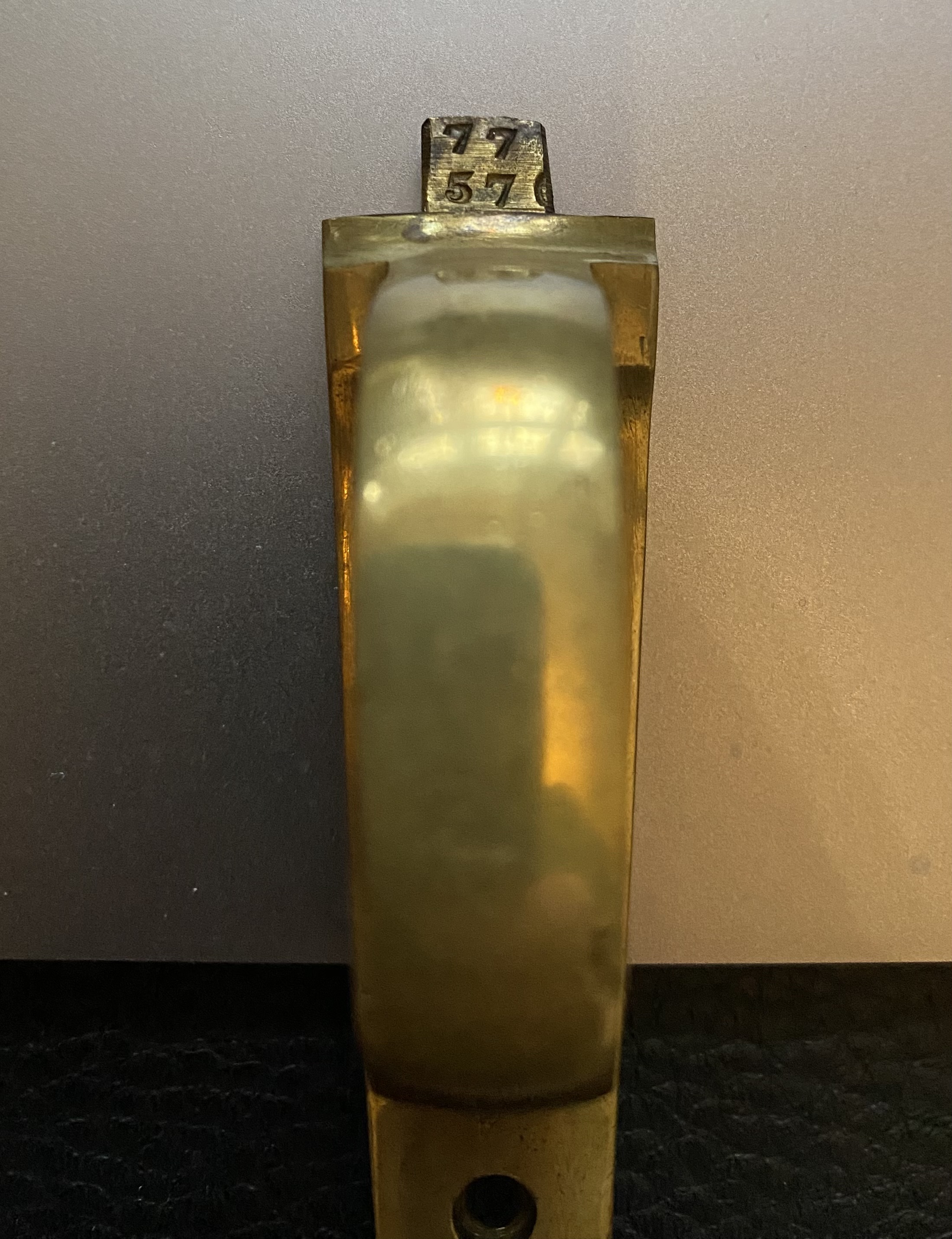

Did you have an opportunity to check the S/N on the trigger guard tab? You'll have to remove the trigger guard to locate the S/N.

Hi not had opportunity to do remove the trigger guard , will have a go tomorrow

Hi could not resist or delay, see attached photo
77570

Re: Dating 1858 Remington
Hi Stewart, and to all following this thread,
The serial on the tab, 77570 solves everything. the gun was made in June 1864.

It isn't unusual for a digit or two to be missing from a serial number. It really screws up things with today's collectors, but back then it was nothing.
