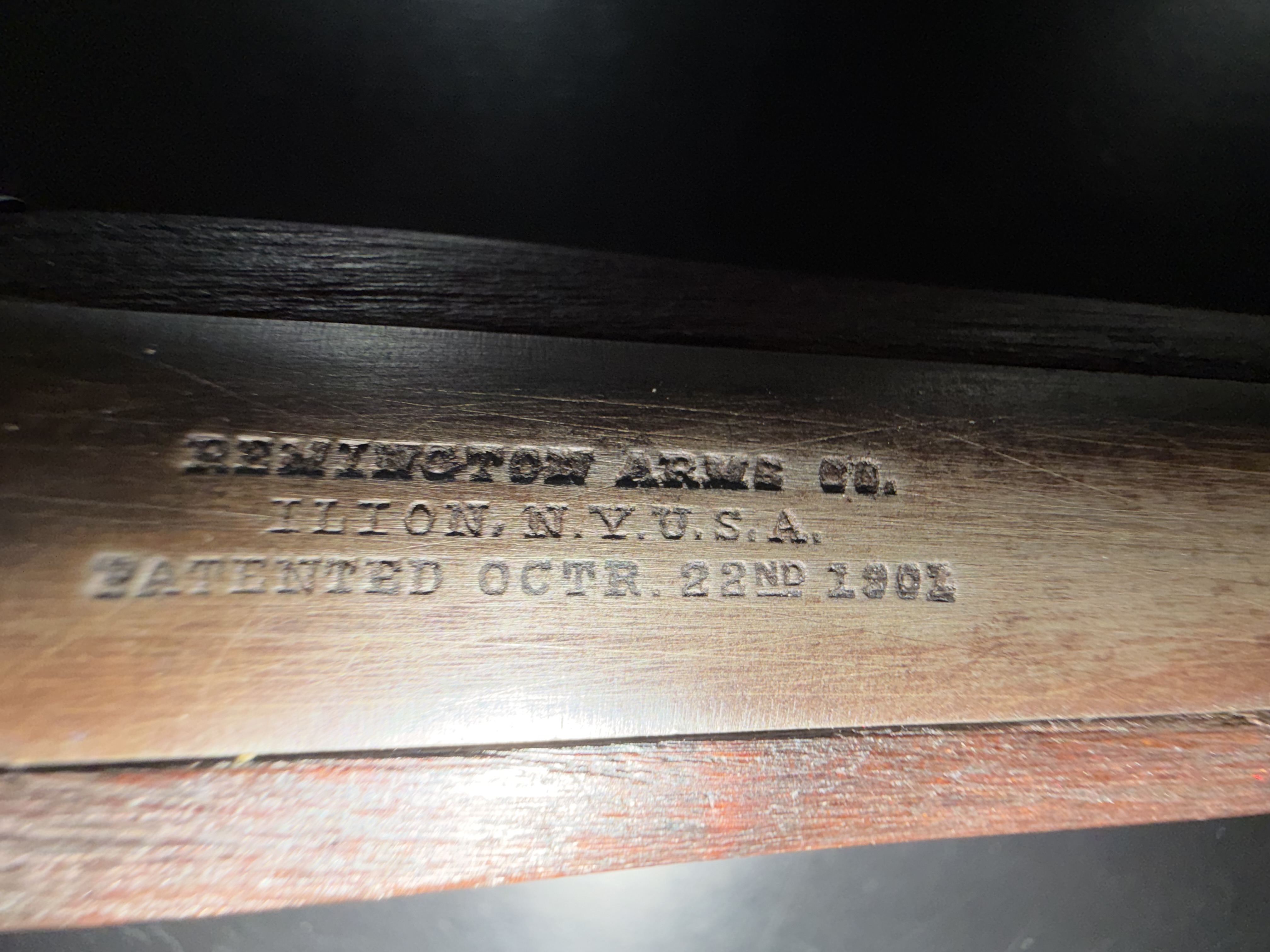

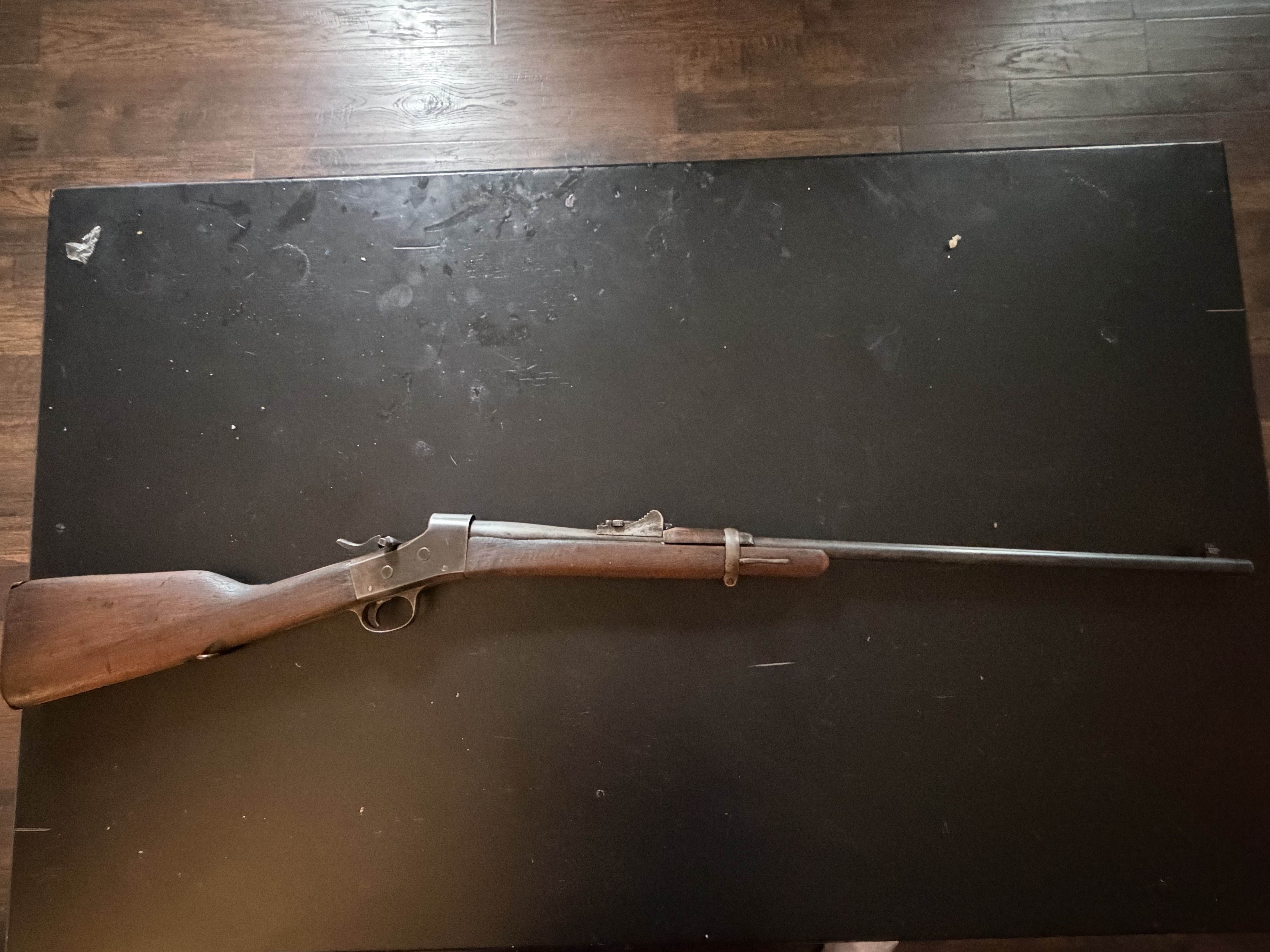

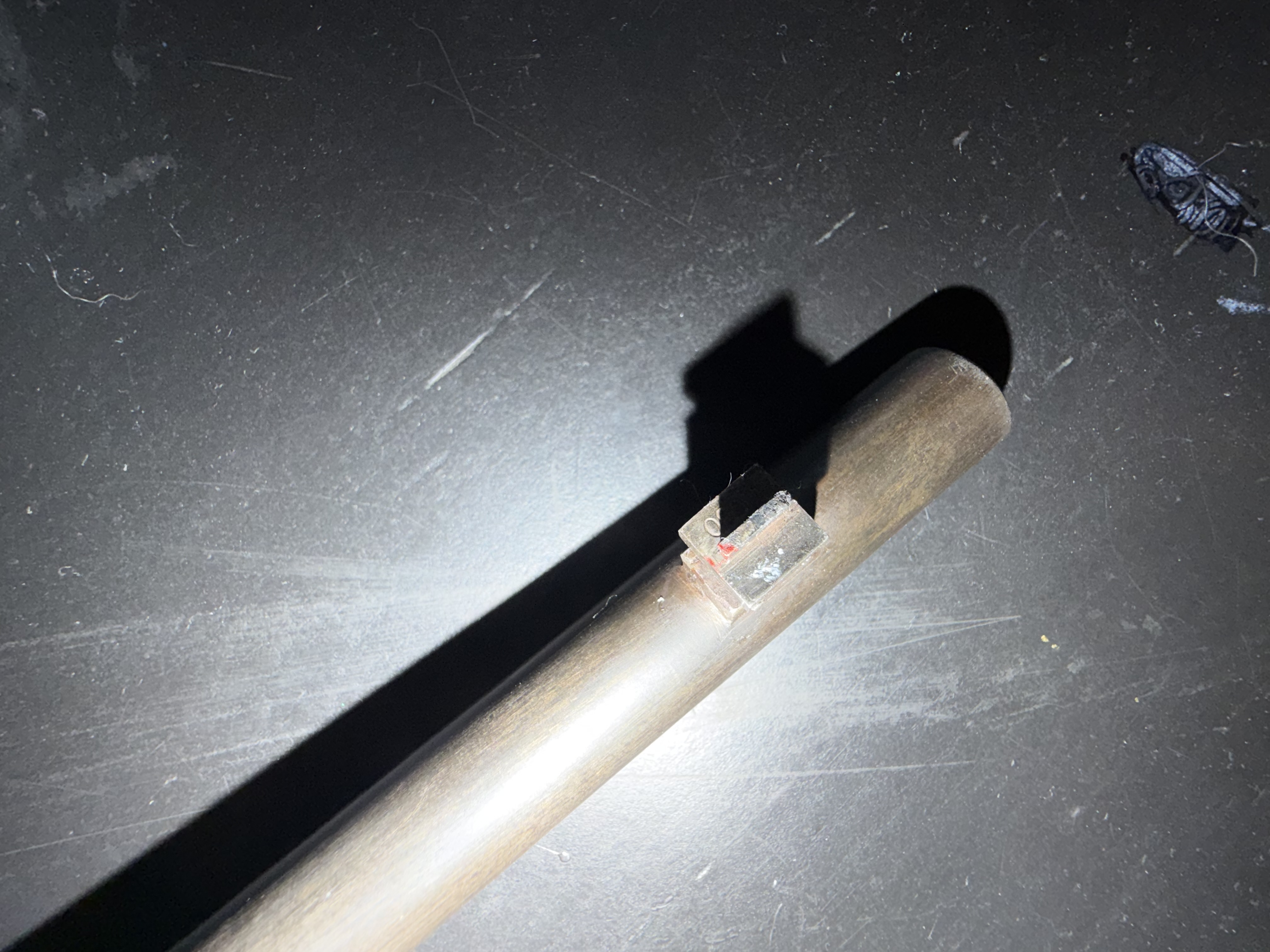

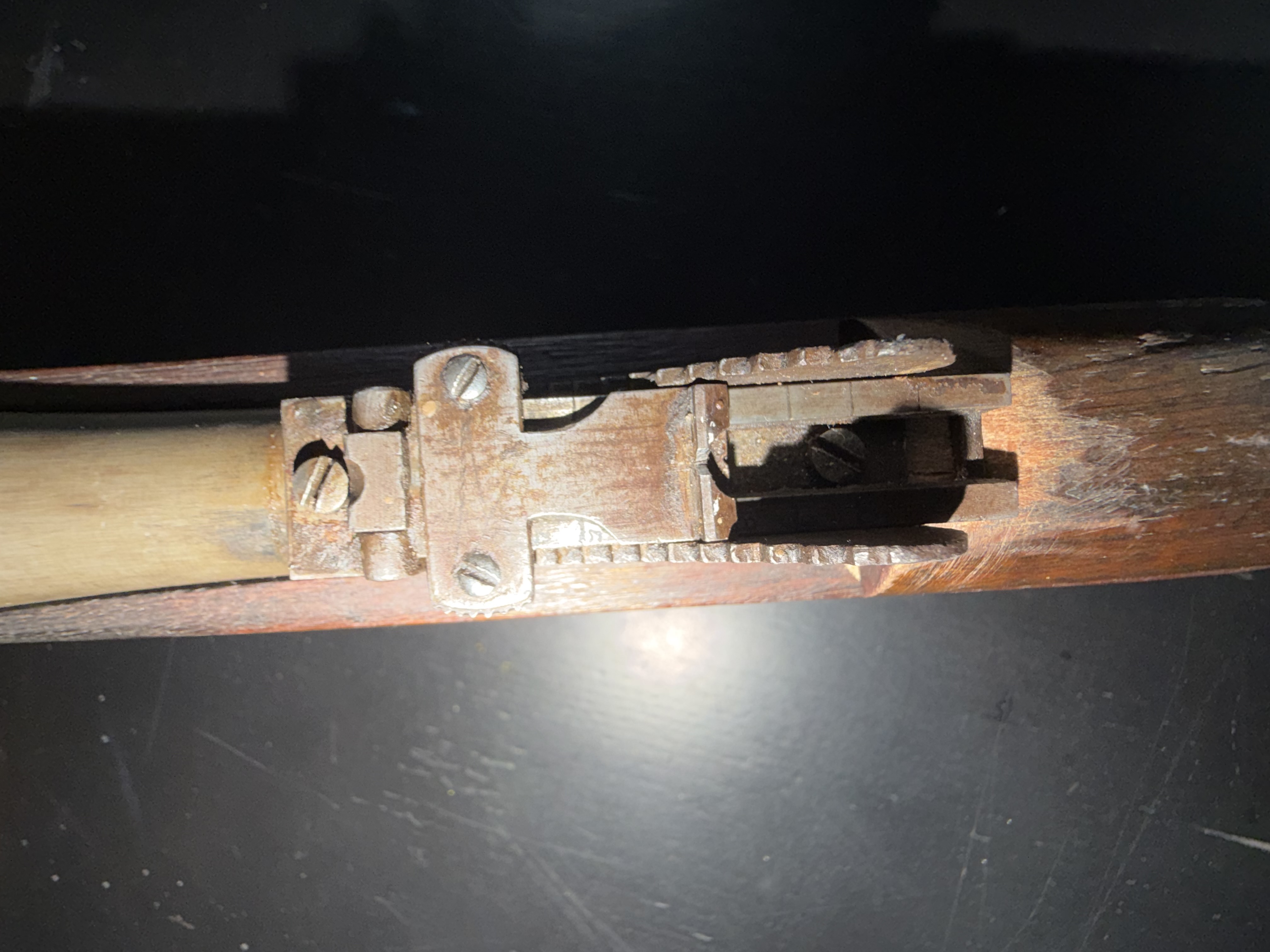

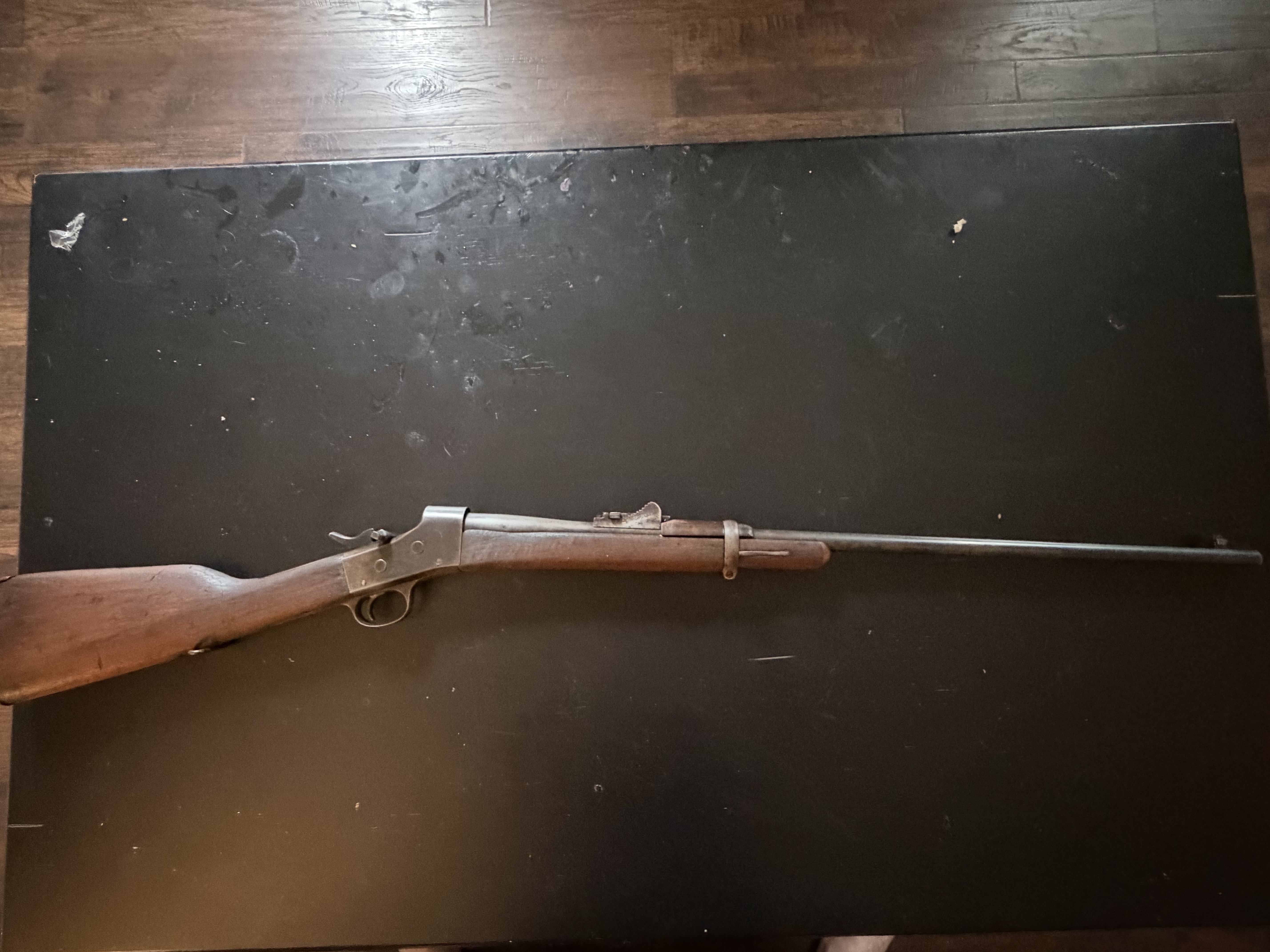

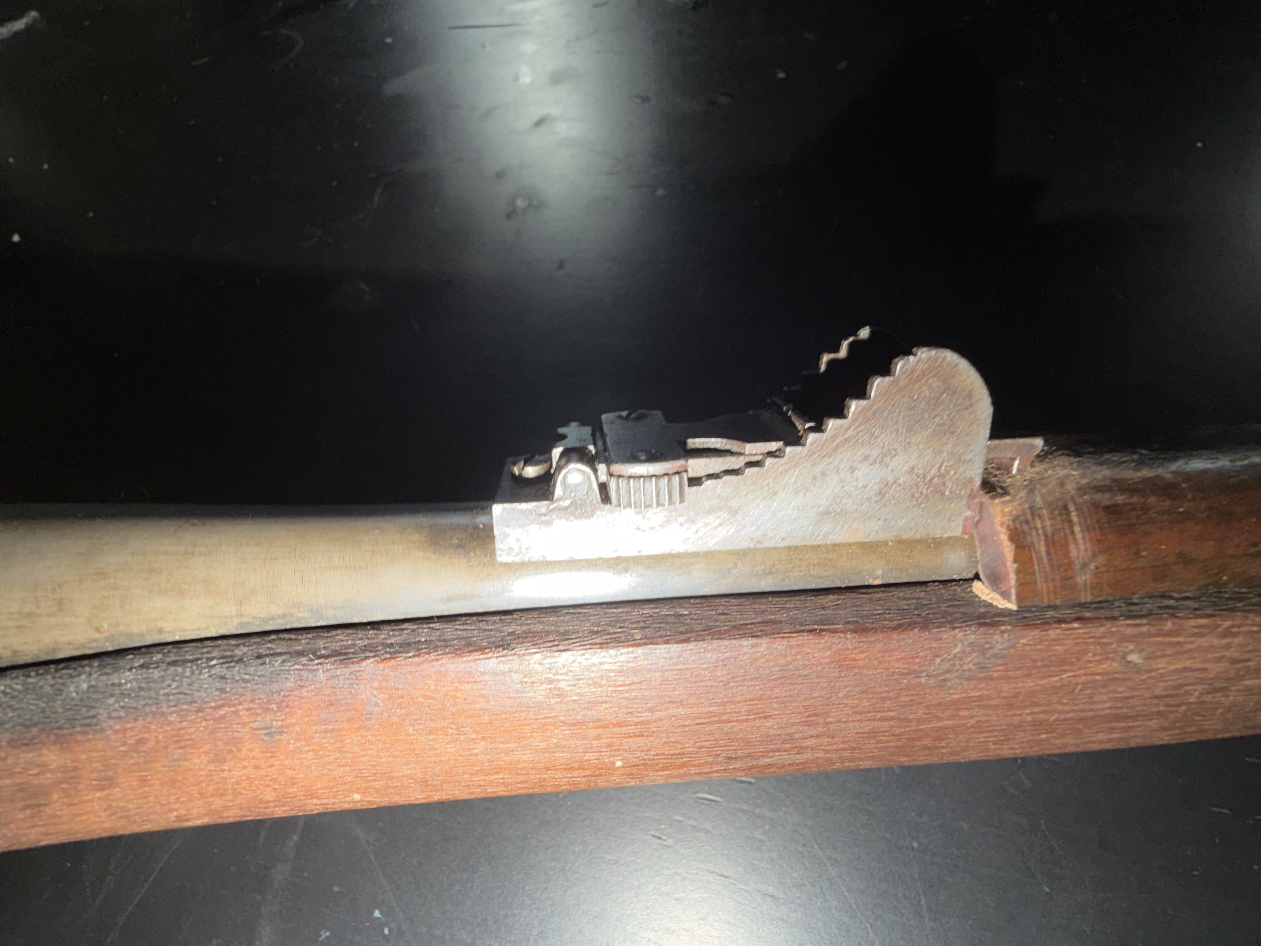

This rolling block followed me home a few weeks ago. I assume it is a #5. It’s chambered in 7mm and the receiver, barrel and what remains of the stock are in pretty decent condition. I’ve shot about 25 rounds through it with no drama, however I can’t hit the broad side of a barn with it. I can’t seem to focus on the front and rear sights together. The notch in the rear is so small, how did somebody pick up a target quickly? The other alternative is that my eye glass prescription doesn’t work for these sights. That said, I have other old rifles that I can shoot well. I would like to restify the gun but not if it’s not accurate or accurate for me

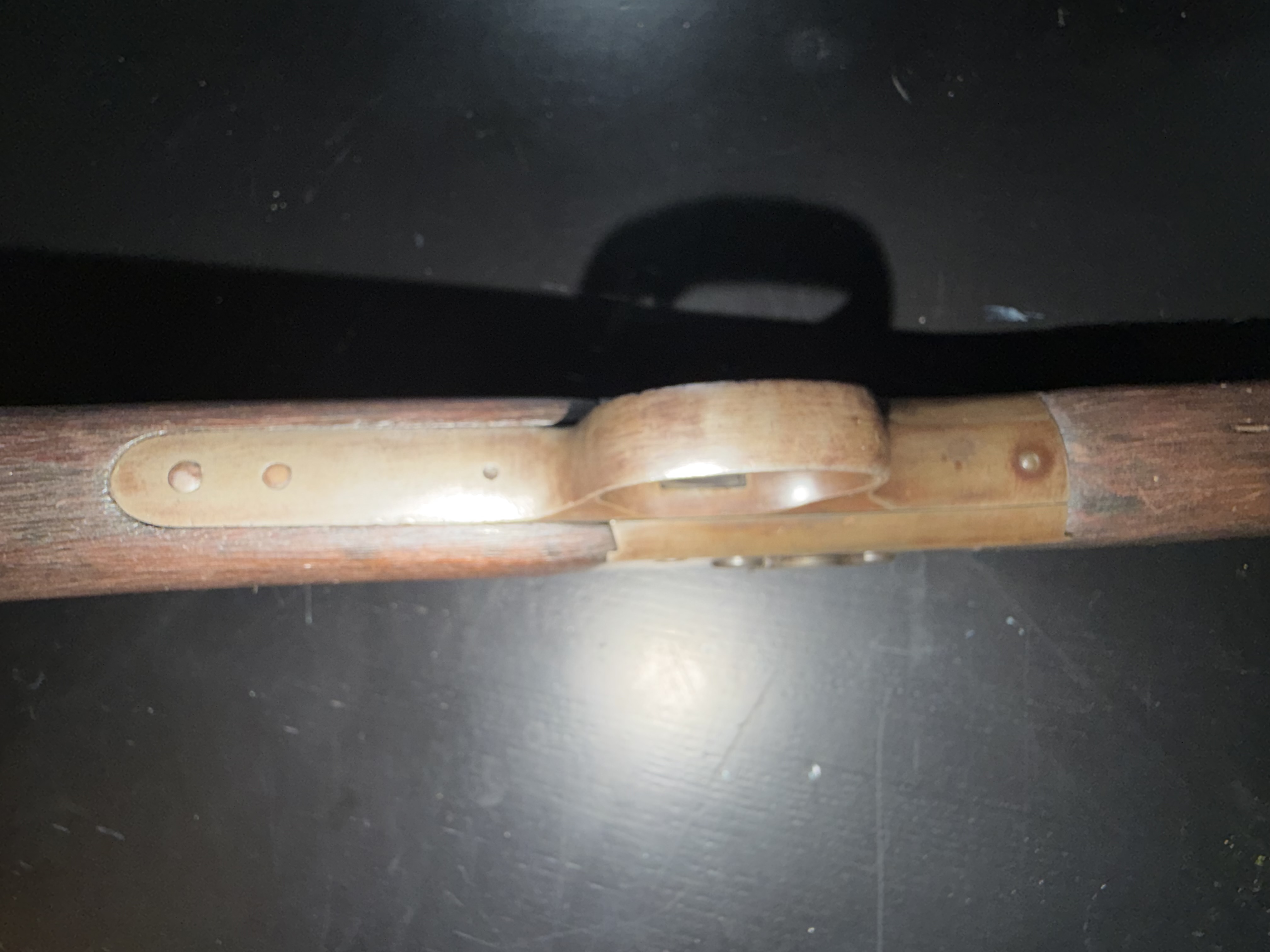

More pictures of the RB. I do like the gun!

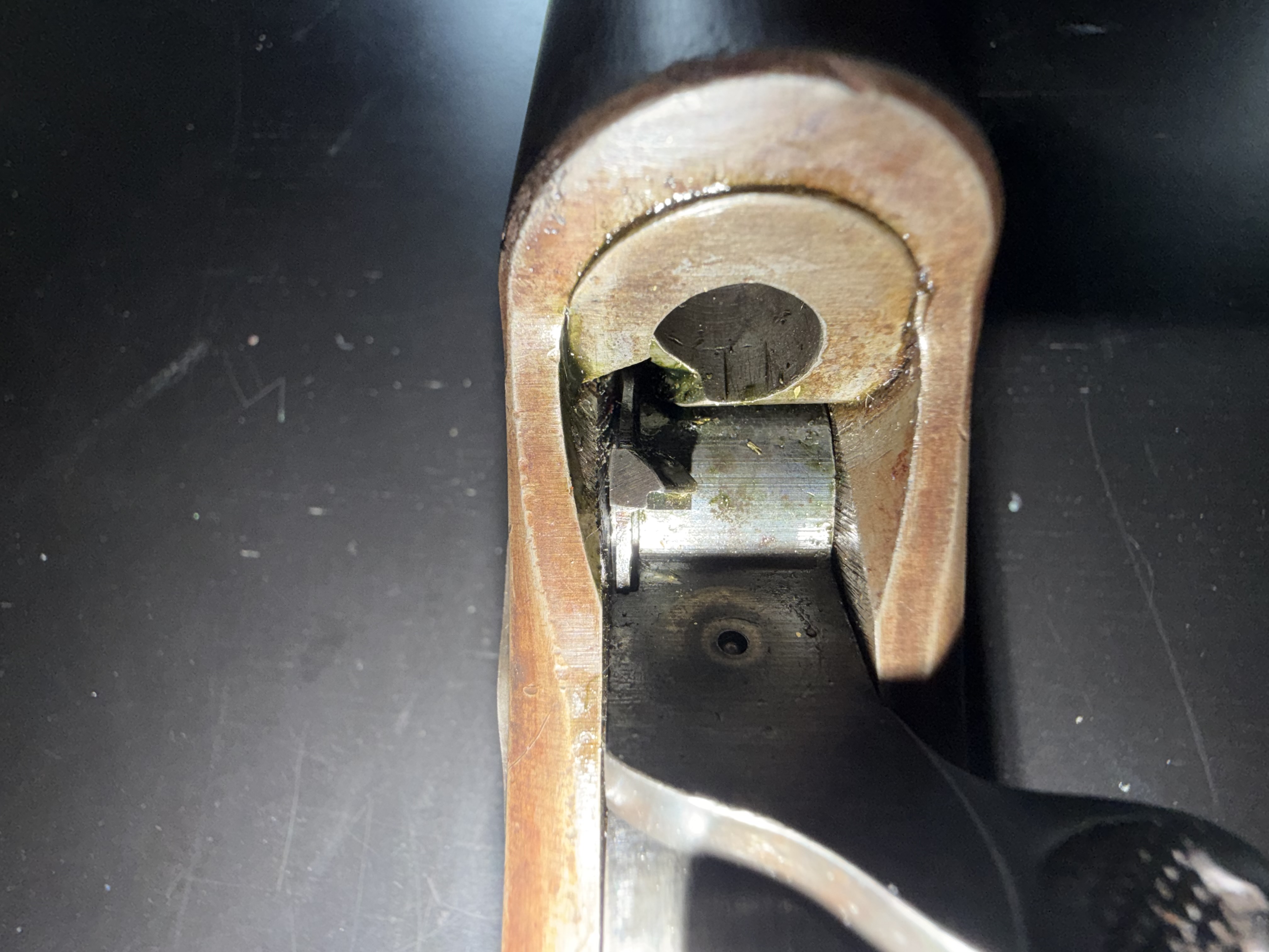

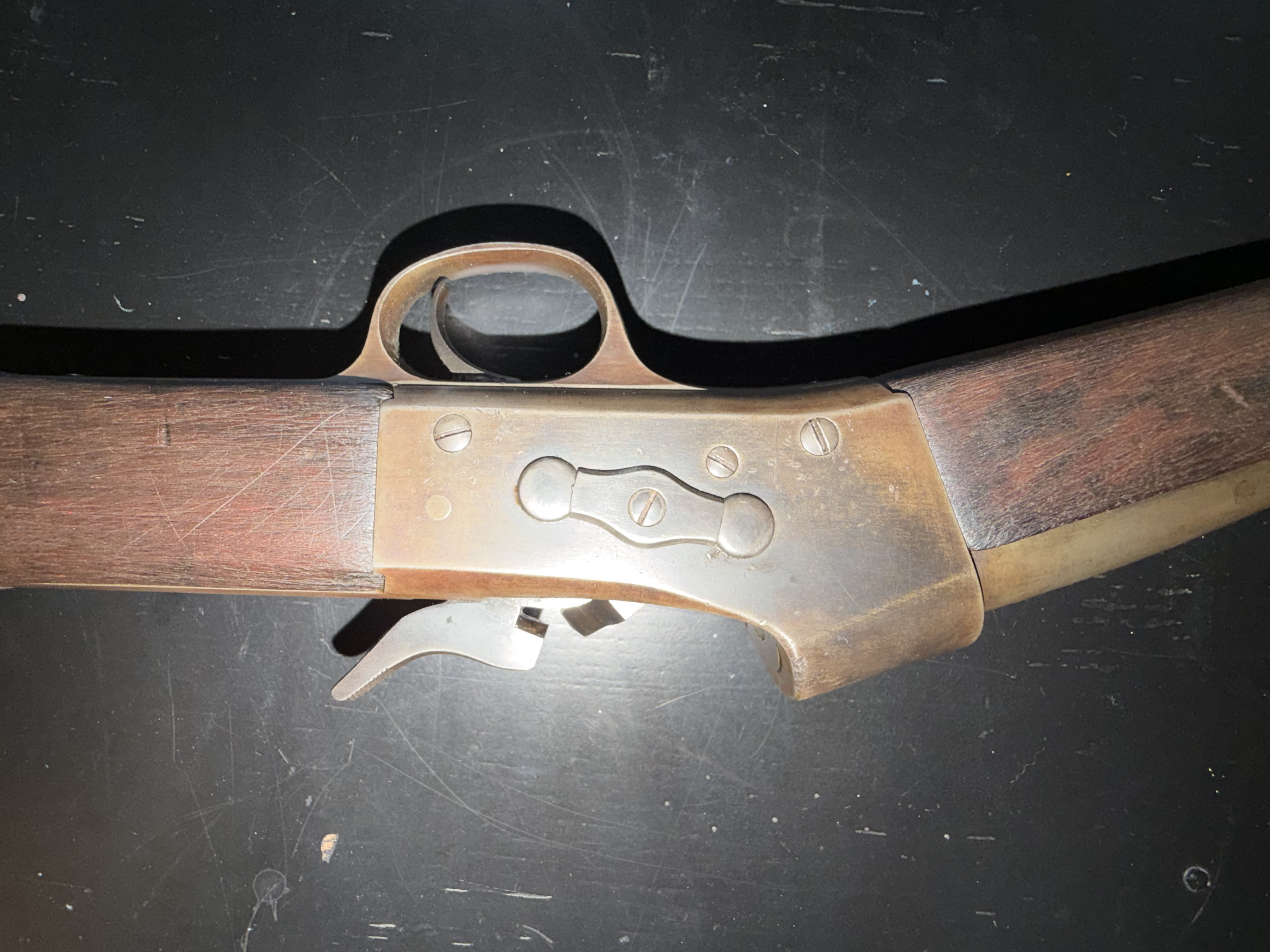

And a few more pictures to post for identification verification

The original front sight was a blade that was thinner and easier to line up in that rear notch. You might try removing the front blade and use a file to make it ore of a knife edge shape to work better.
These military rifles with the rear sight located so far away from the shooter's eye are really tough to ever get a good sight picture. The solution will require modifying this rifle, and that's not always something owners want to do. Either a second sight back farther on the barrel, or a tang sight. Both will make it shoot easier, but ruin any collector value. I'd try thinning the front blade first and see if it makes it better.

These were military rifles, not target rifles, so pretty tough to really get target type accuracy. But a thinner front blade will help get it more like it was when it was new.

mikemiller69gs wrote: Sun Aug 16, 2026 8:19 am . . . . . I can’t seem to focus on the front and rear sights together. . . . . . .
Concentrate ONLY on the FRONT sight . . . .allowing the rear sight AND the target bull to be “fuzzy”.
