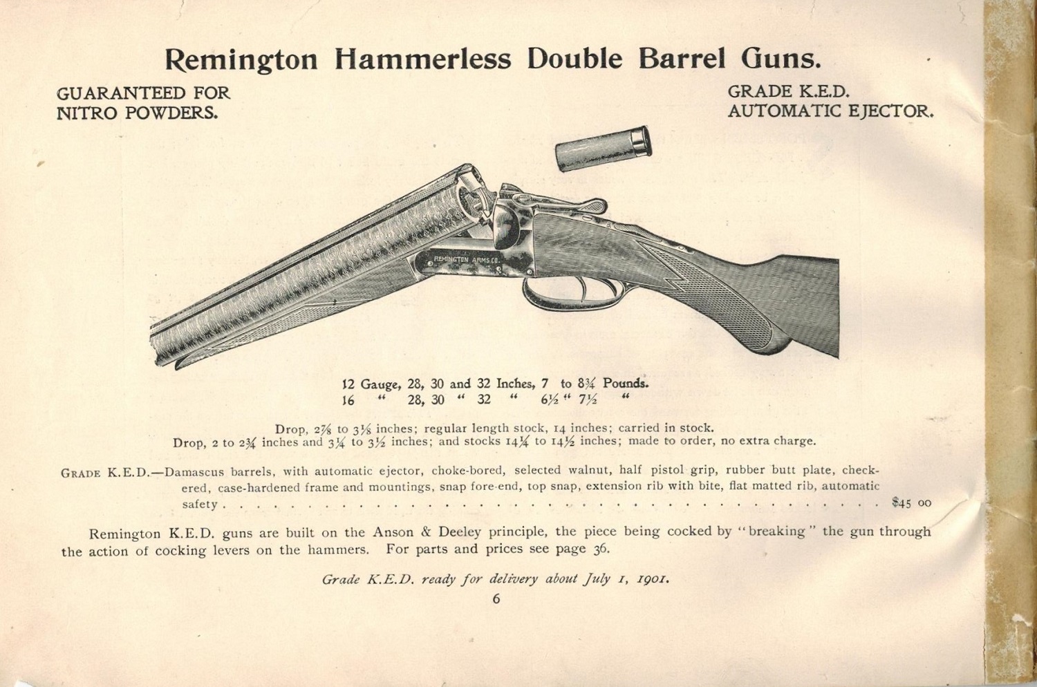

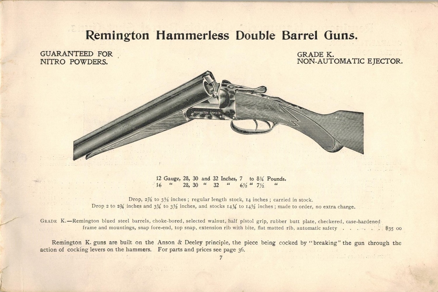

I have an old side by side from a relative that I’m trying to learn more about and it pre dates the alpha numerical date codes.
On the side it just says Remington Arms Co.
Stamped on the metal behind the trigger assembly is 329330 and stamped into the metal of the trigger assembly is 9517.
Is there anywhere I can look this up?

No production records for Remington Arms Co. doubles have been found. The late Charles Semmer created/interpolated serial number chronologies from surviving shipping records for his book Remington Double Shotguns. From Charles' serial number chronology your gun would be of 1902 vintage. It could be a K-Grade if it has Remington Steel barrels and plain extractor --
or a KED-Grade if it had Damascus barrels and automatic ejectors --

Thank you very much for the help researcher!
