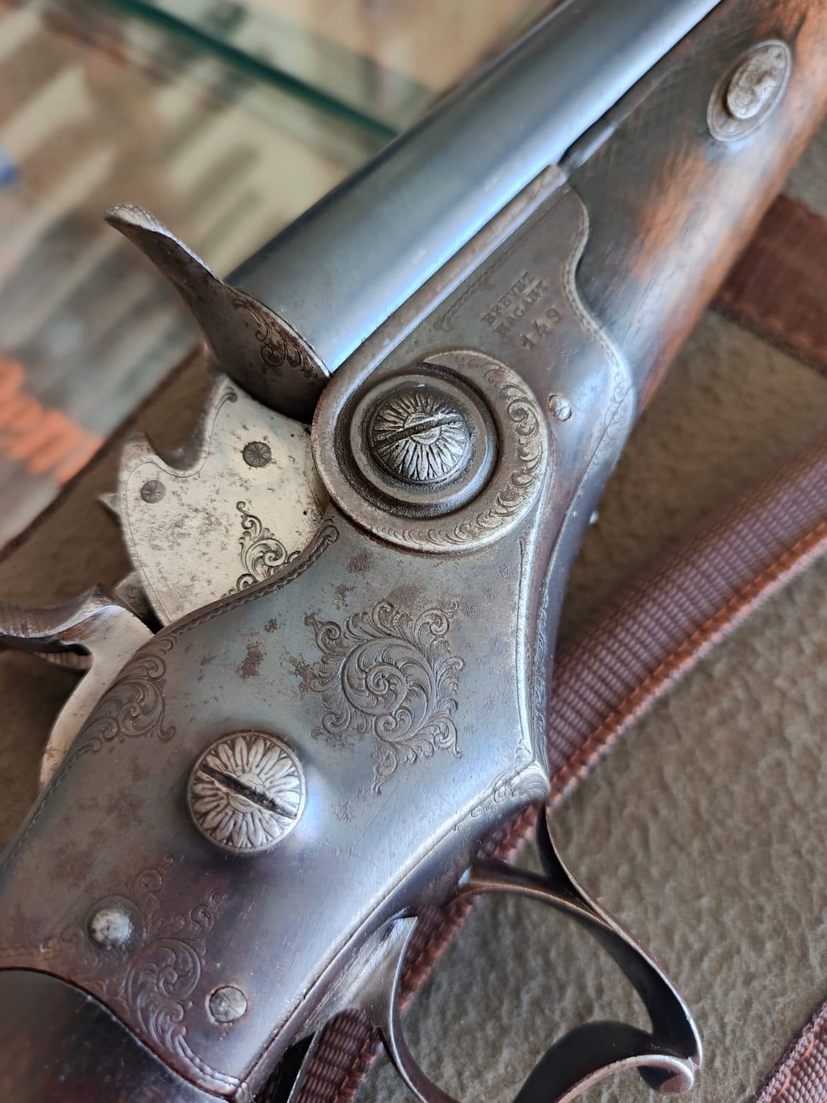

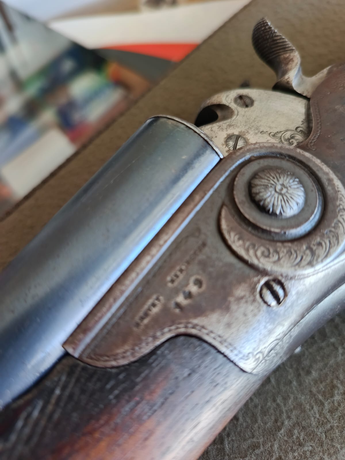

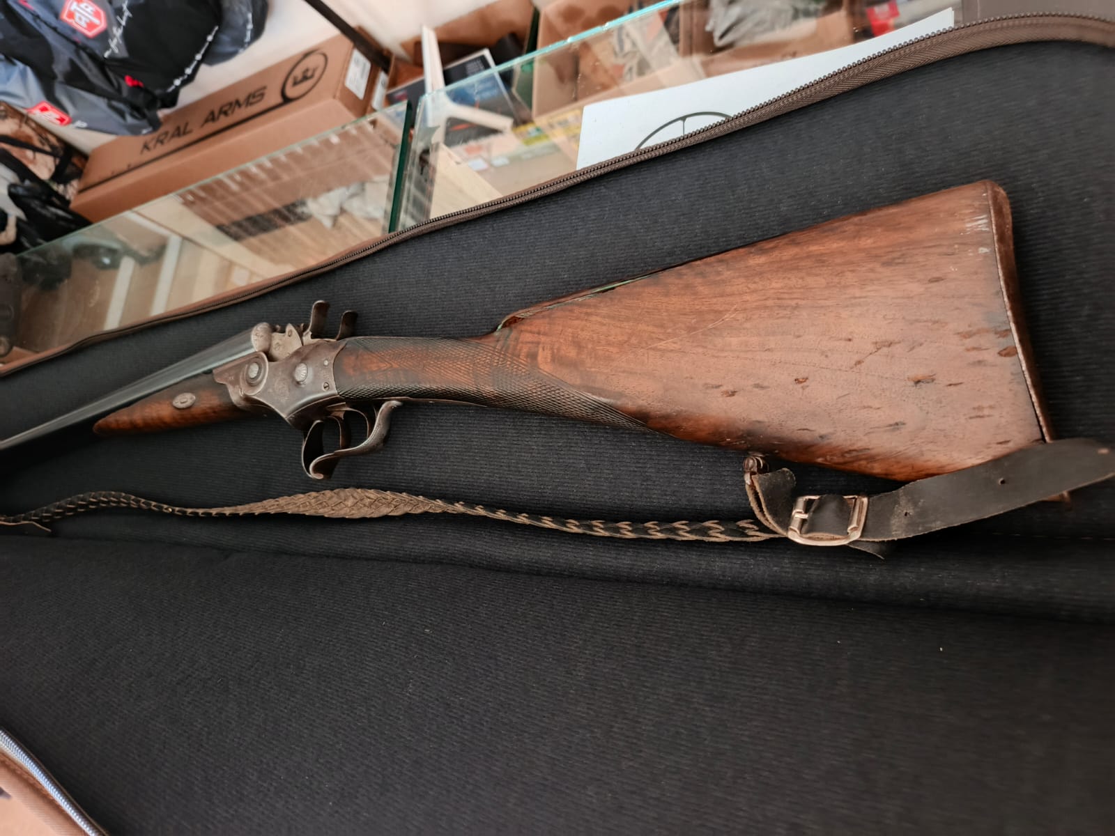

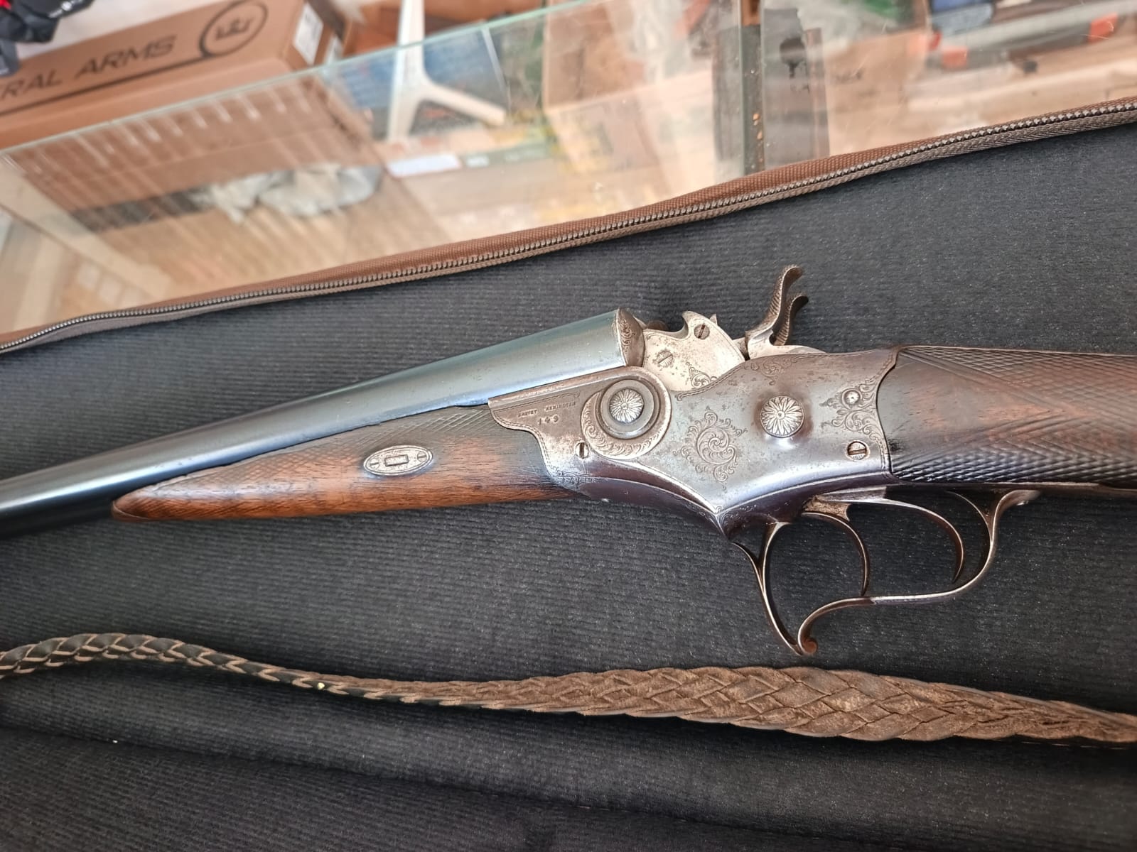

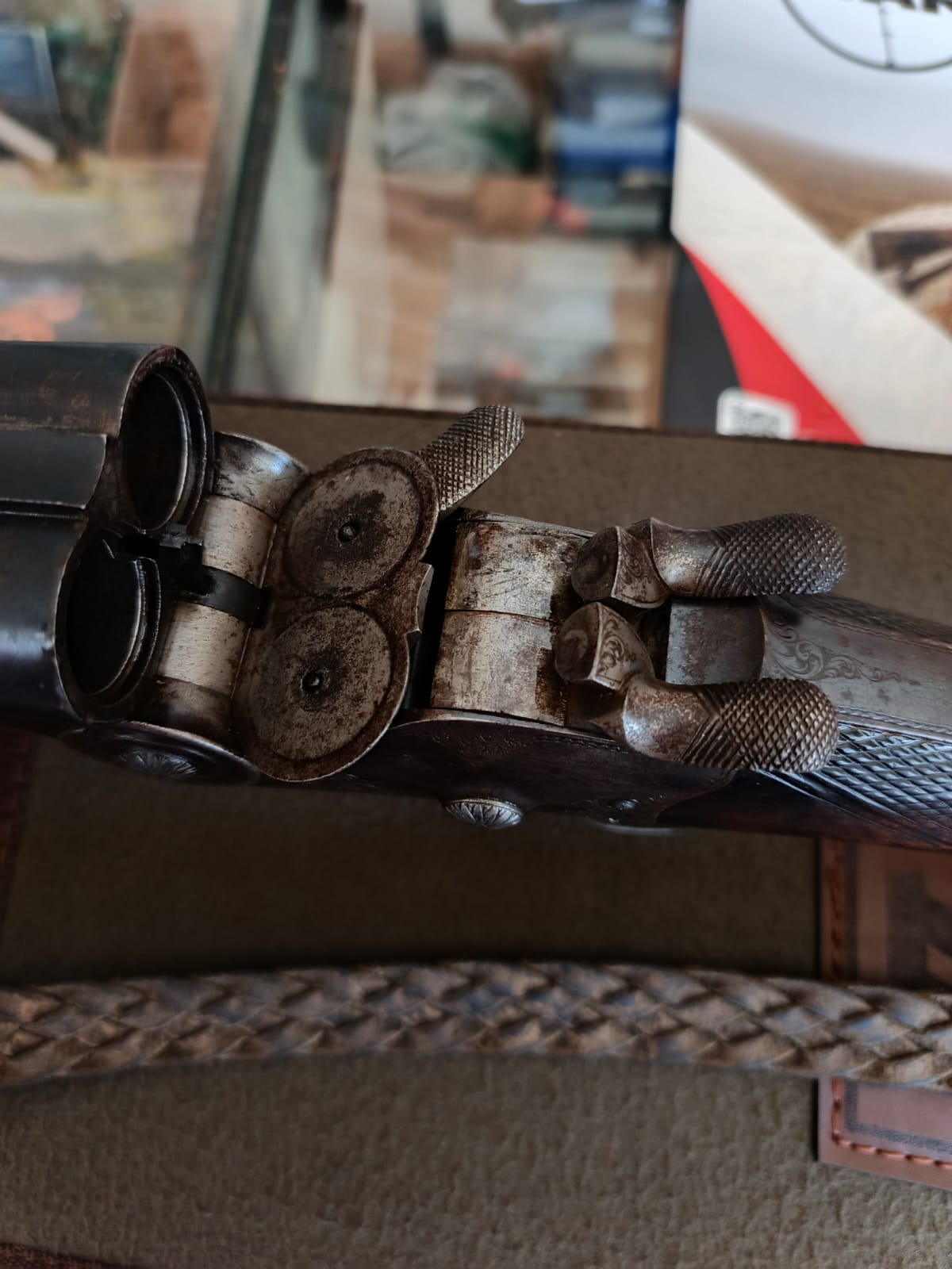

ChuckD wrote: Sun Apr 07, 2013 9:04 am I agree with researcher, more photos are necessary to identify this model.
To the best of my knowledge, Remington never made a Rolling Block Double
Barrel shotgun. A photo of the action would probably answer the question
as to which model this is.
[*]HASAN ŞAMİL AS 0542 787 07 46

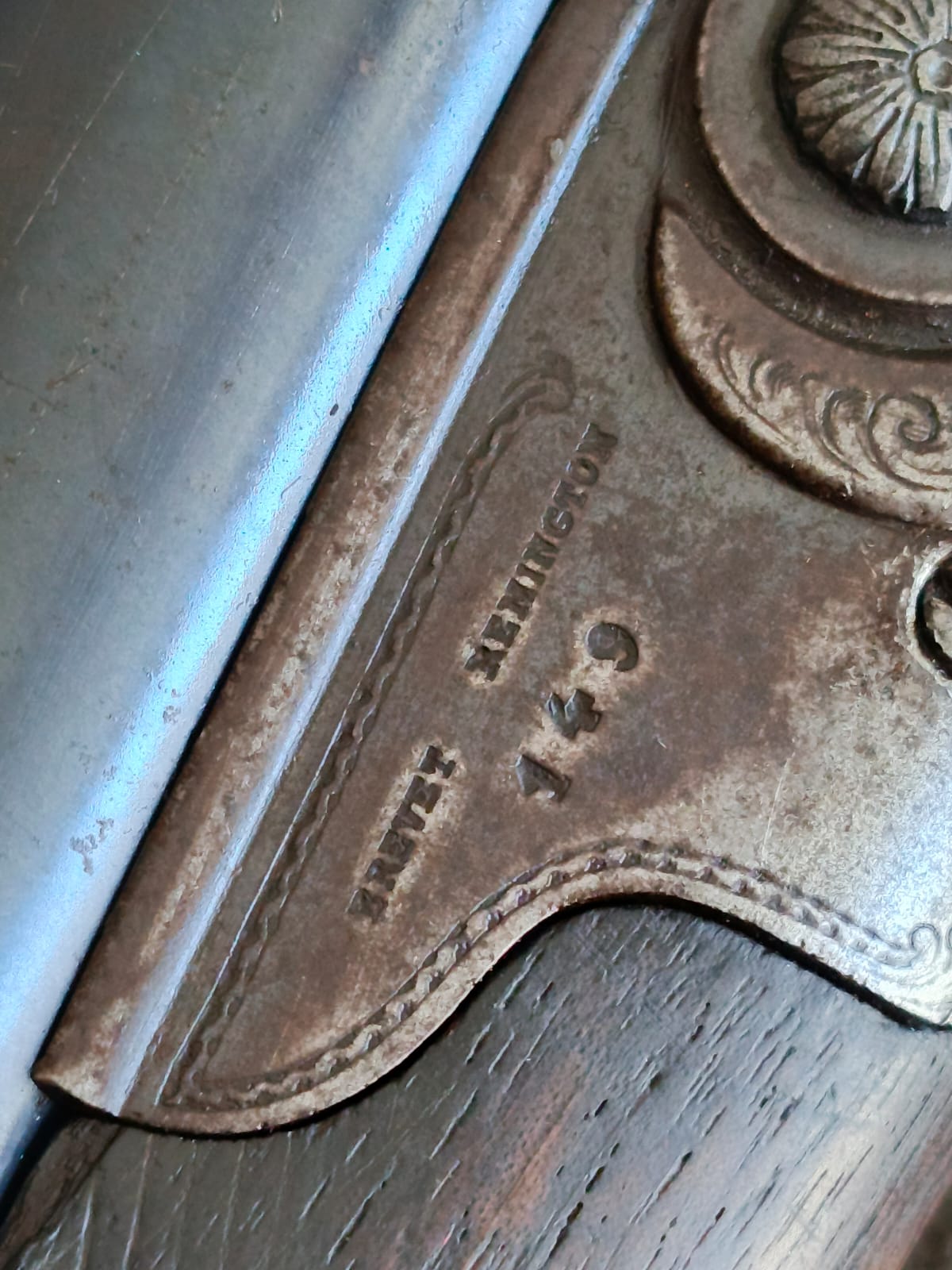

aardq
Posts: 588
Re: Old Remington
Post by aardq »
