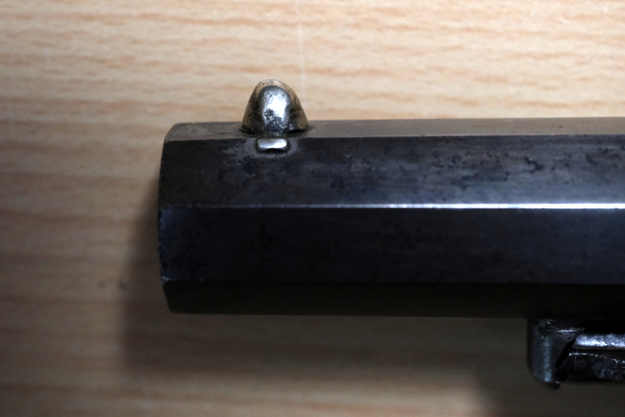

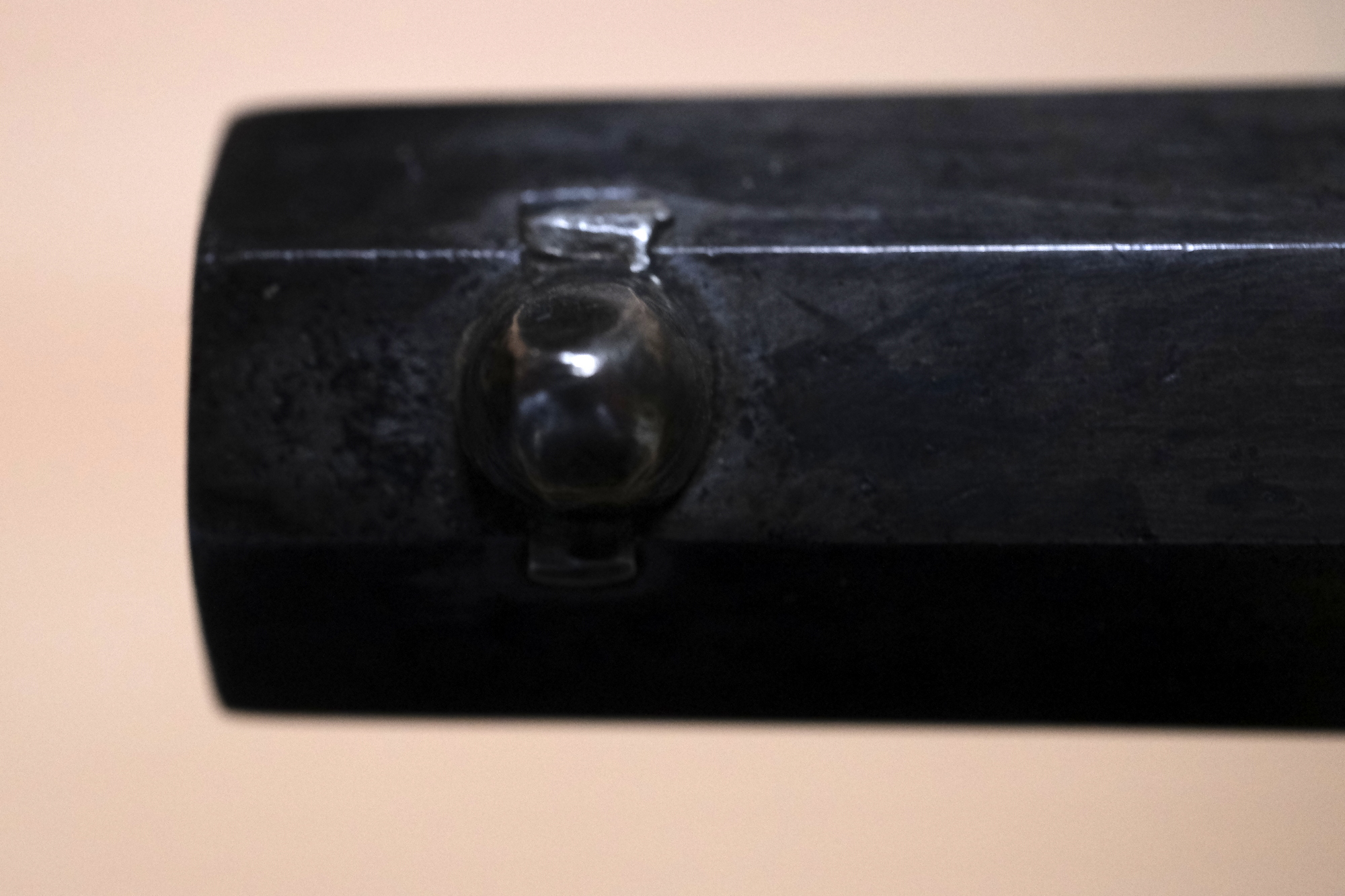

Hi Daniel, Yes I am Looking for pictures if any, of an Original German Silver Cone sight that was dovetailed into the barrel. I have Donald Ware's book but there is practically nothing about the sights in that book, and no real pictures of them close up. And everyone seems to say "German Silver" , was it real silver, cast then machined to fit the dovetail ?. would like to see someone send me a close up of that sight as I can't seem to find one anywhere. if you know of such a picture available please send me the link, would be greatly appreciated. thanks Gilly

Here are photos of the german silver cone sigth on my 1861 barrel :

thank you, those pictures are exactly what I needed, great pic's

You already got some pic of the cone sight, there are many more on the internet if you want more. German Silver is an alloy of 60% copper, 20% zinc, and 20% nickel. The sights were cast in molds with several on a "tree," then they would be separated and "cleaned up."
