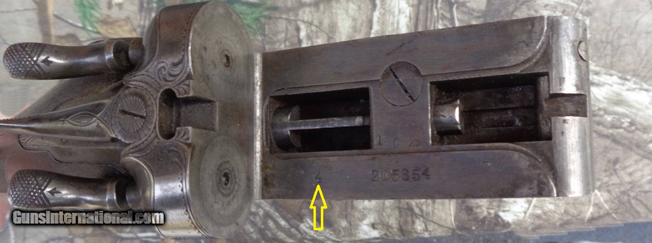

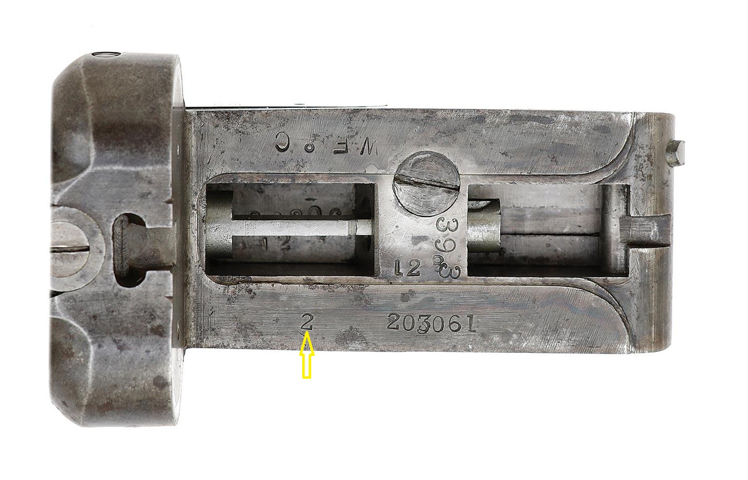

The Model 1889 was made in seven grades. No. 1, 2 & 3 were plain with no engraving, but differed by barrel material, No. 1 decarbonized steel, No. 2 Twist and No. 3 Damascus. The higher grades No. 4 to 7 had increasingly more engraving, finer Damascus barrels, finer stock wood and fancier checkering. The grade number was stamped on the barrel flat to the left of the serial number --
203061 01 grade number annotated.jpg (348.41 KiB) Viewed 10152 times
203854 00 grade number annotated.jpg (146.98 KiB) Viewed 10152 times
