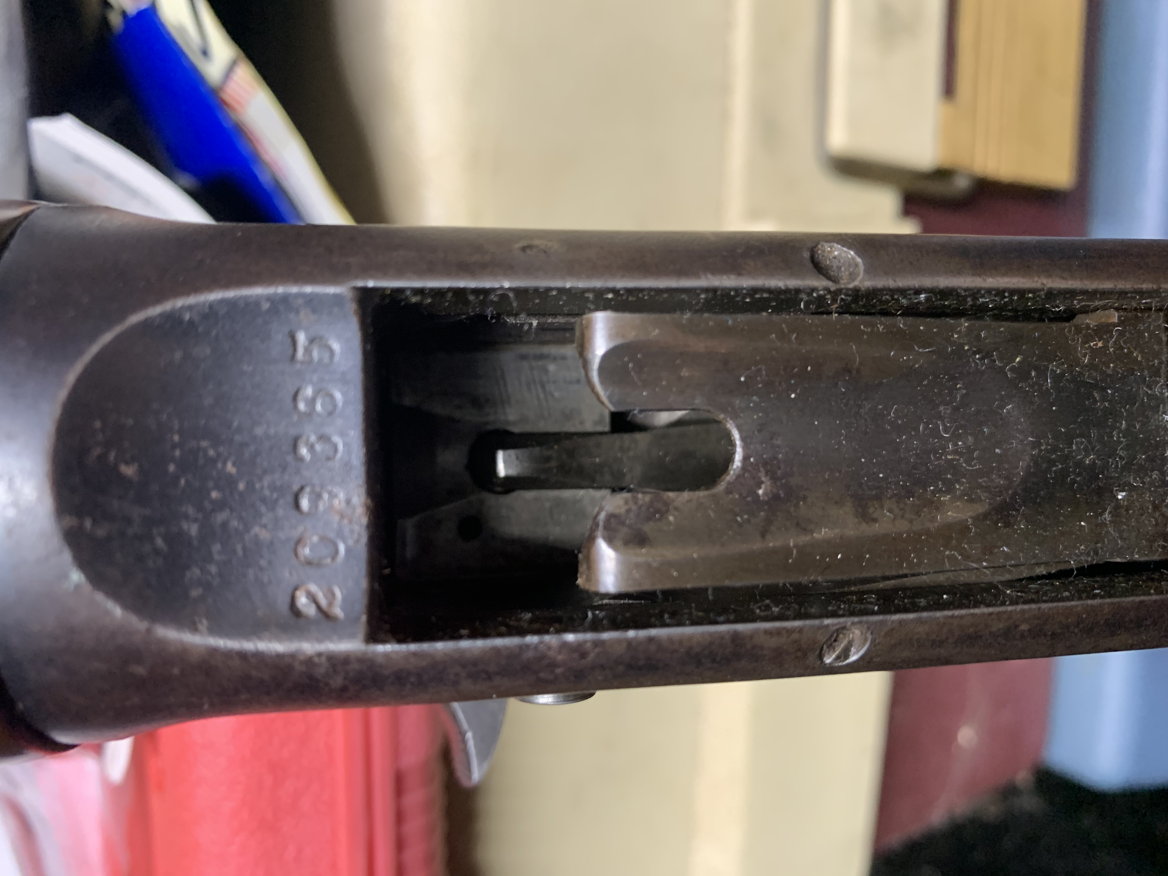

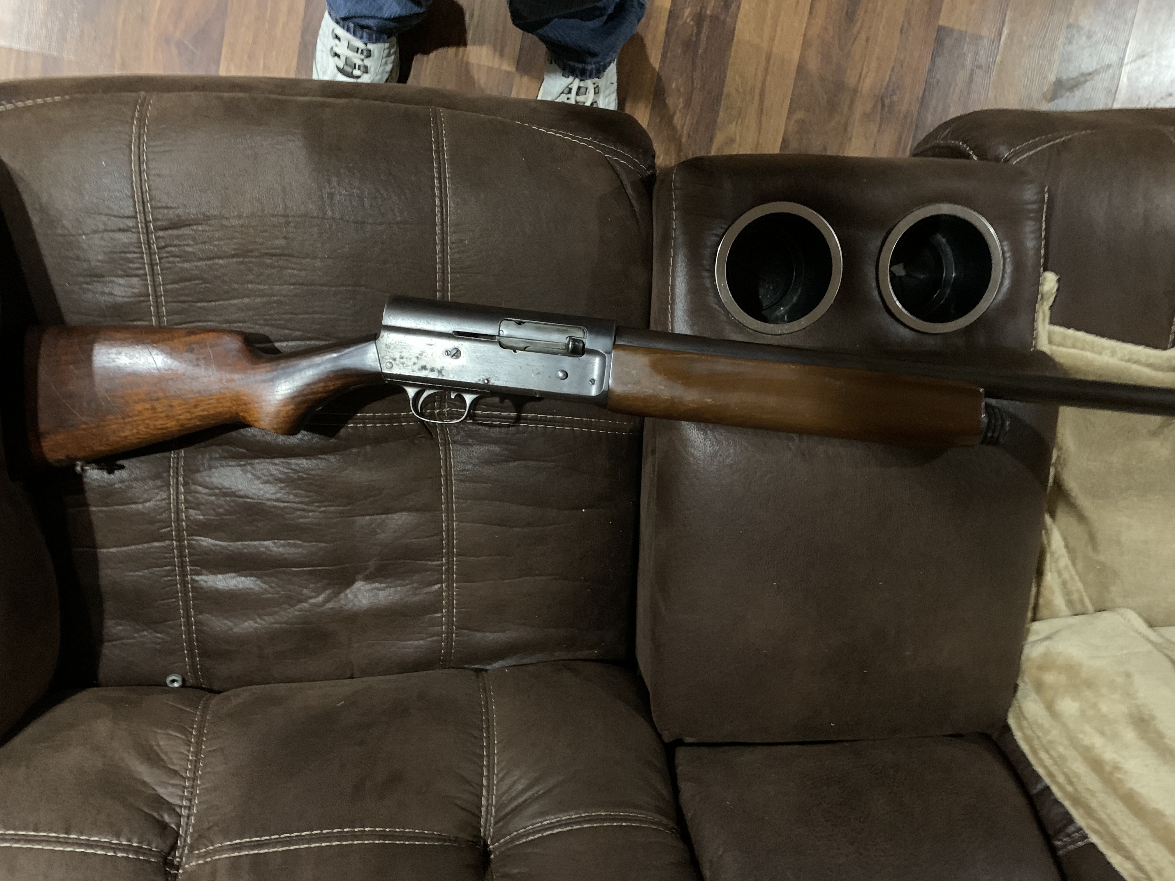

Just inherited a model 11 and i can not get it to accept shells into the magazine tube they almost all the way in than hang up about 3/4 of the way in. this one has me baffled.
- 74B8F0CD-FD12-49B4-9C8E-9DE606826586.jpeg (3.08 MiB) Viewed 1877 times
- 6FB9069E-4EE3-439D-8182-EF8BE6CC820C.jpeg (2.27 MiB) Viewed 1877 times

Have you had it apart?
It could be any number of things restricting travel in the magazine tube.
First order of business is to take it completely down removing the forearm and barrel then the magazine spring retainer cap, watch the spring and possible plug and finally the magazine follower.
This should tell the tale, if not, a qualified gunsmith should be incorporated into the solution.
