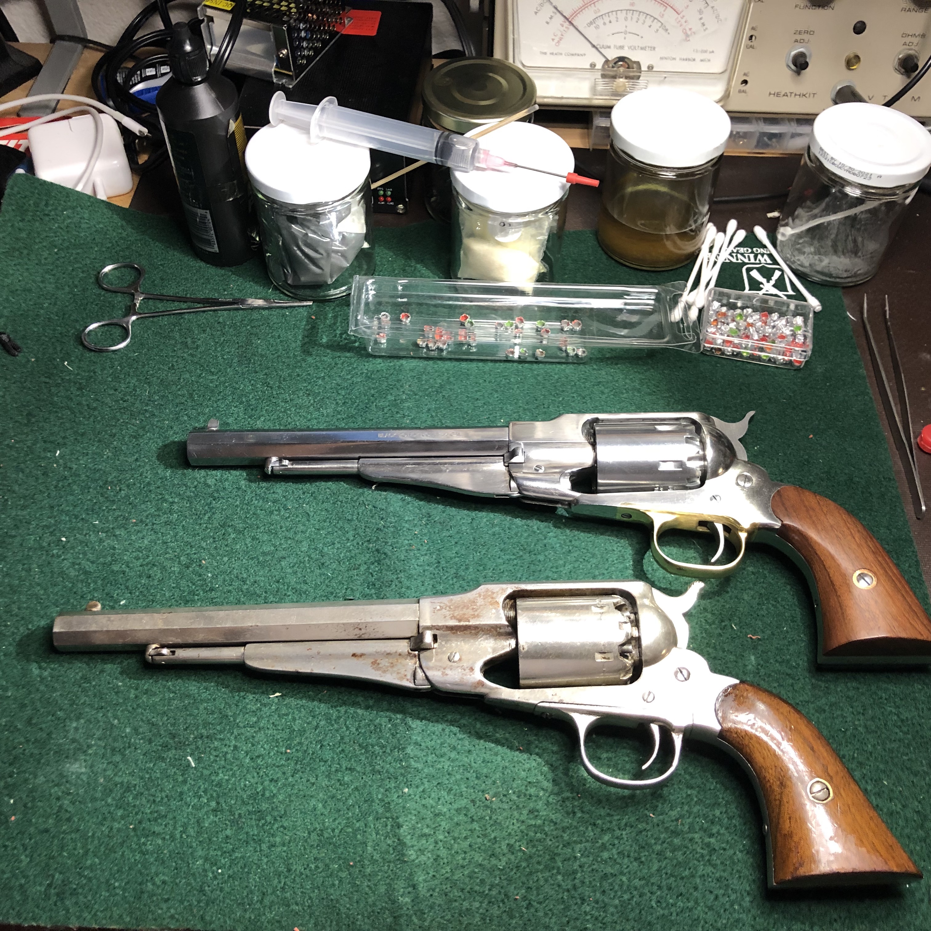

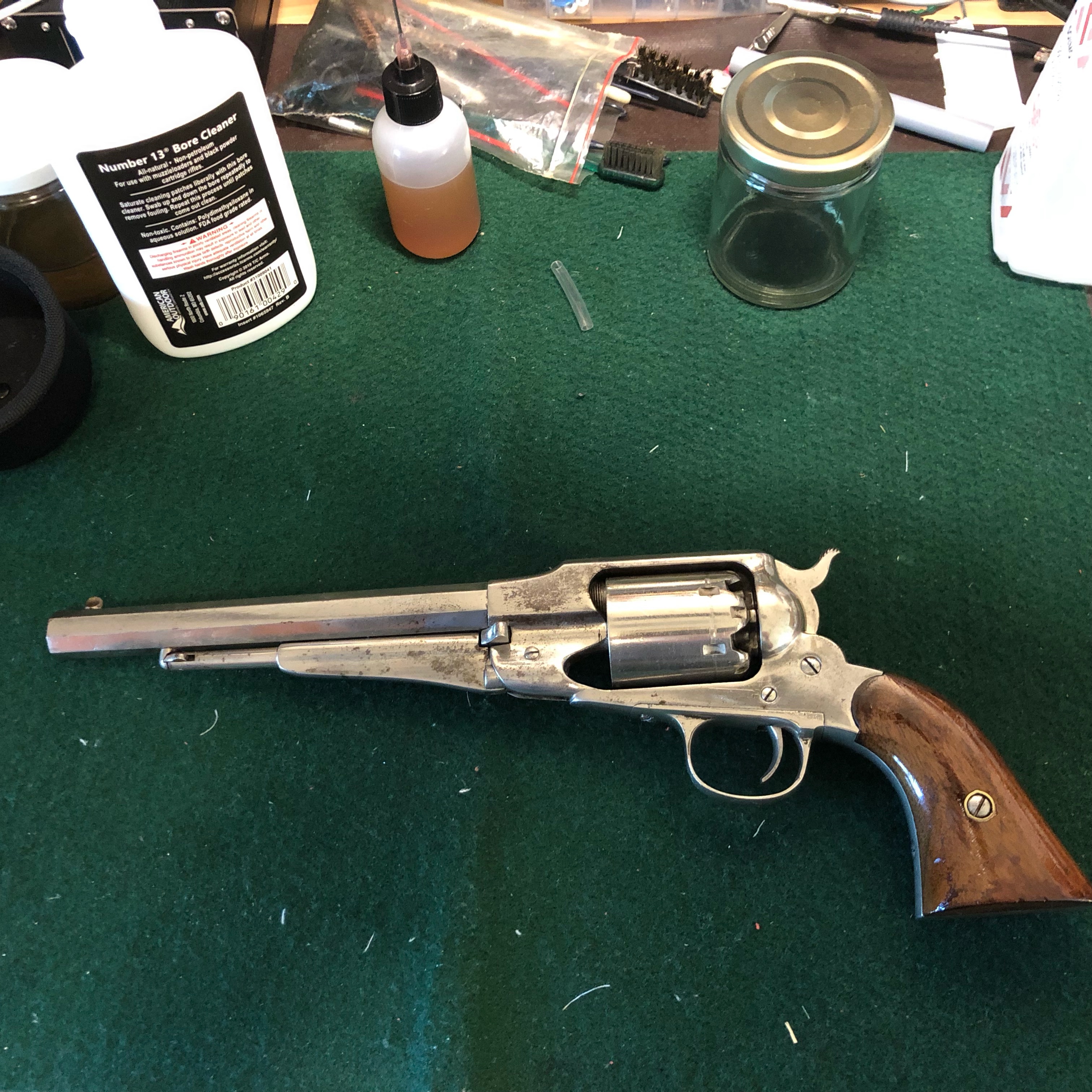

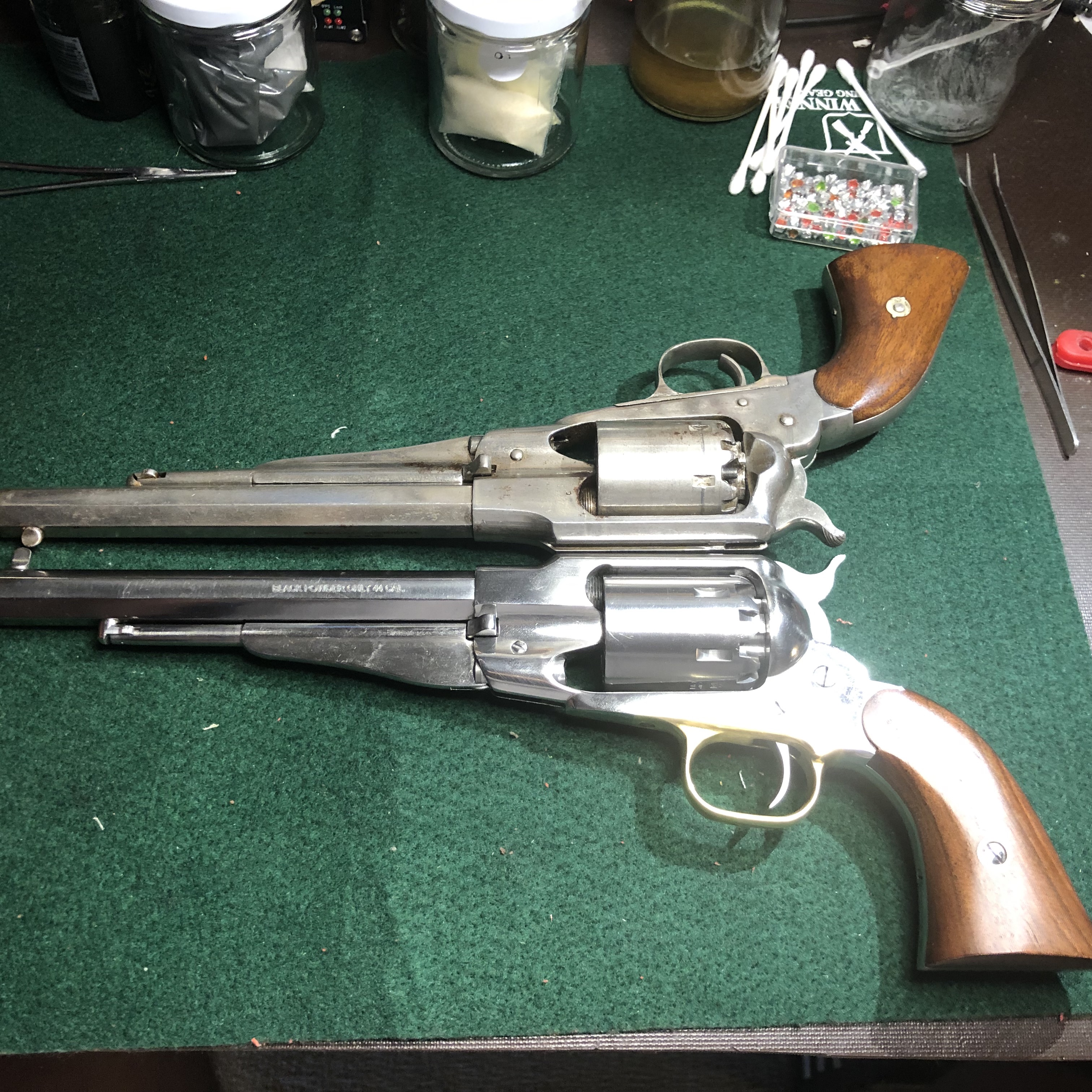

I decided to take her out and have some fun today. Which led to a bath and a lot of scrubbing. Which knocked off patina, but I'm not much worried about that given it's pedigree and Nickel plating. It ran well with 24 gr of 777, 15gr of corn meal and a Cabela's felt pad with a .451 ball on top. This kept the pressures down, but it was much more accurate with .454 ball. I did a mix of homemade percussion caps and CCI #11's that I necked down to #10. No issues at all. So, I'll be taking her out with her much younger brother also in the pics below. Before and after my fun.

Thank you aardq. That is helpful and I appreciate the info. The gun mostly sat in the back of a closet for the last 90 years. The oil used to coat it turned brown and waxy with age. I completely disassembled the gun and bathed it and most of the old waxy build up came off. On the left side, there appears to be some light printing but there is enough patina that it really is not readable. I see an S and remnants of letters and what looks like DAR, but I could be fooling myself. If anyone knows of any images of guns with printing on the left side, it might aid me to pattern match what is there.
