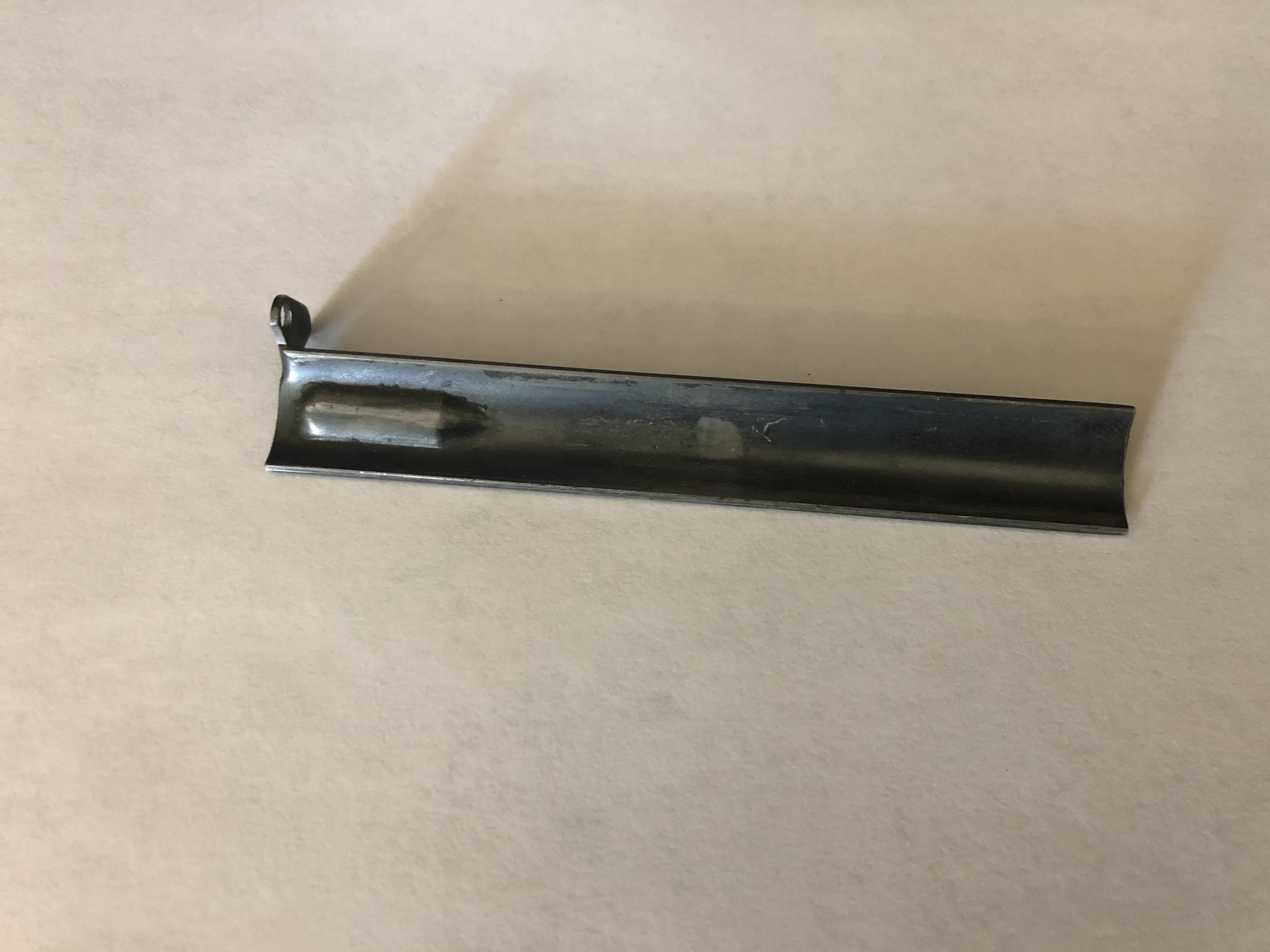

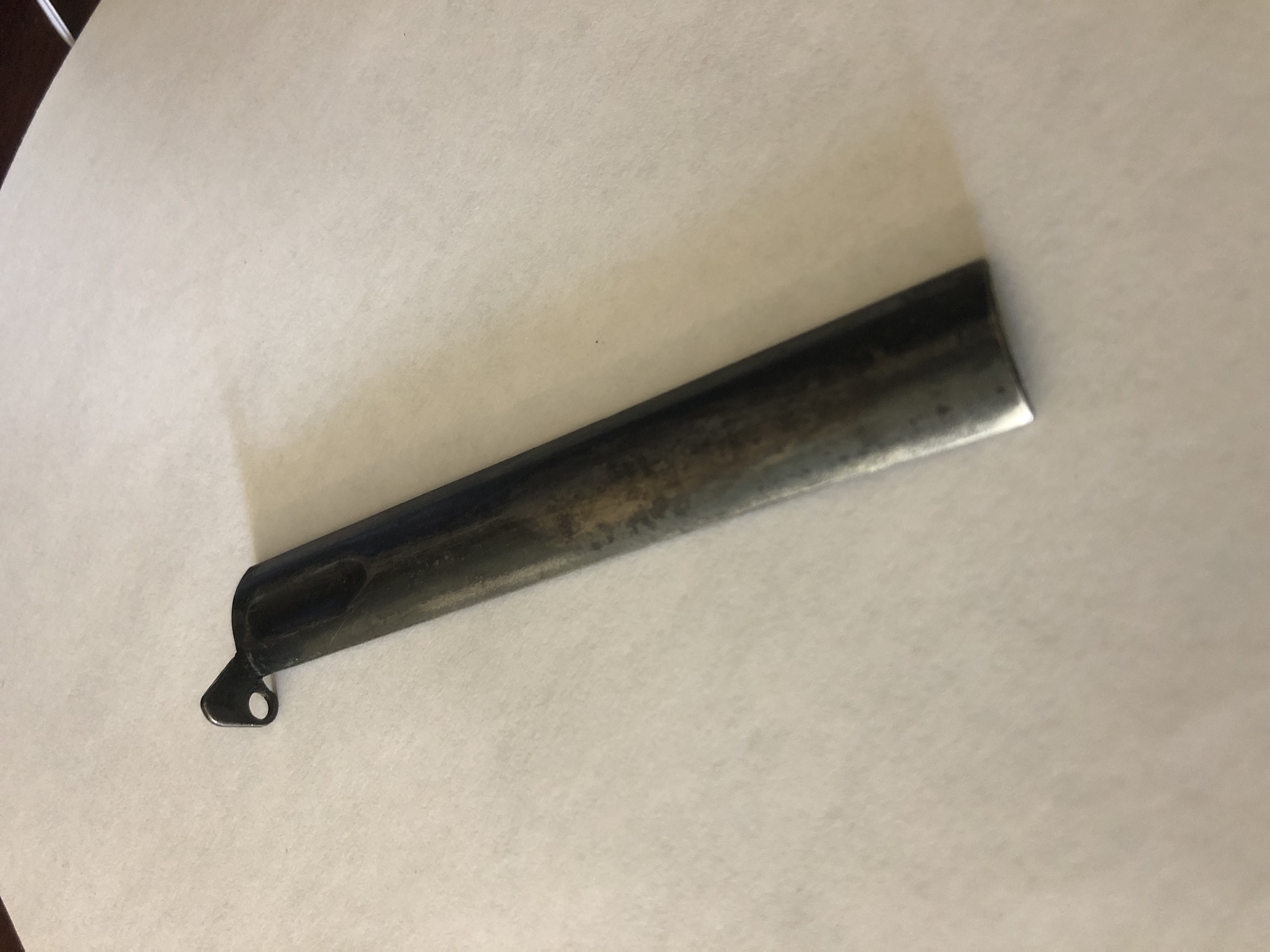

New to the forum with a question I haven't found an answer for yet.
I have a 141 (.30 Rem) with a broken tab on the action bar cover. I can't locate a replacement cover (straight surface with a "bedding" groove) but I can find one for a 14 (deep recess at one end). Here's the question....Can I swap out my action bar for one from a 14 that will accept the model 14 cover without any issues?
Thank you for any and all input and advice!

The action bar cover is the most broken part on the 14/141 and has become the most expensive to replace. There is one listed right now on Ebay for a Model 14 but its actually for a 141, the bad news is that they are asking $185 for it plus postage. I have found that It is "almost" impossible to weld the tab back on once it breaks off.
No, action bar covers for the 14 will not readily fit a 141, those for the 141 have the indentation running the length of the cover to compensate for the thicker barrel. You can try to machine a groove into a smooth 14 cover and try to make it work but finding one of those to work with will be a chore as well..........and expensive.
The early Model 14 action bar covers with the large indentation near the flange (tab) will only work on guns with serials under 25,000 at which time they re-designed the action bar itself and went to the smooth action bar cover.
The last three (3) action bar covers for the 141 that I sold were priced at $158 plus $9 postage. Been doing repairs on these rifles for 40 years and know of no after market replacement, rather just a bunch of guys from time to time that think they can "mill" a cover to fit, problem is that a milled cover won't flex and using new steel would tear apart the action bar itself. Bottom line is the only way these things show up is from parts guns.
OH, its worth mentioning that on "late" Model 141's, 65,000 serial and up they dimpled the underside of the cover, dimpled so hard that it left an impression on the underside of the barrel, and making the cover useless for any other 141. Hope all this helps!
