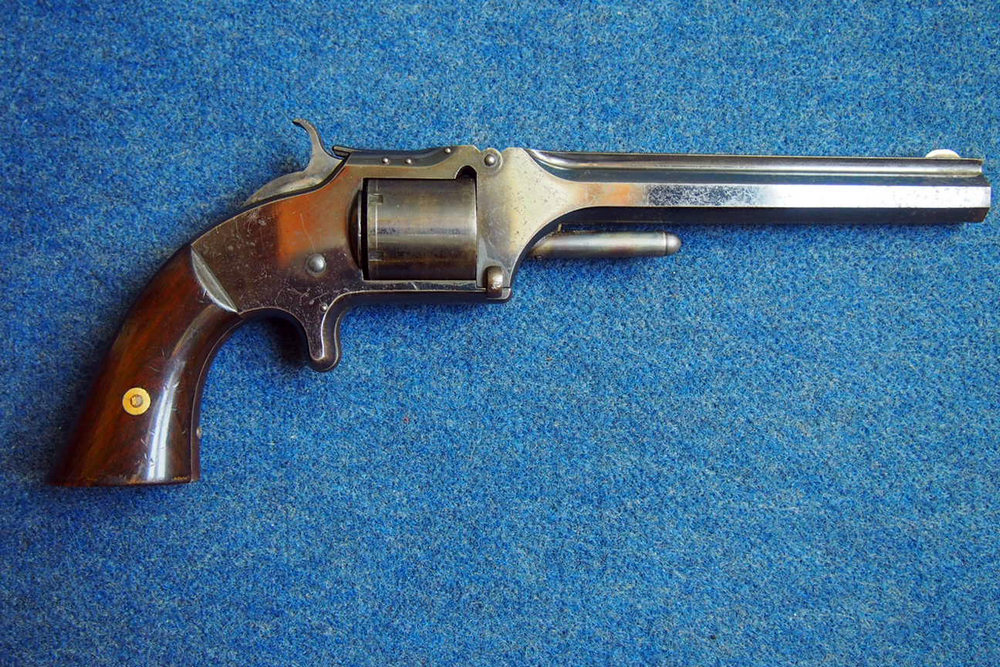

Hi Karu,
We shouldn't forget that we are one the REMINGTON SOCIETY website and stop talking about French 1873, Moore teat-fire, Spencer carbine or Smith and Wesson no. 2.
But I must say that I feel exactly the same as you about this last gun. The S&W no.2 is my favorite American handgun ! Its design is really beautiful !
Two or three years ago, I was lucky enough to get one in practically mint condition for 680 € ($750).
Have a nice day too.

- S&W n 2 n 55730 droit.jpg (306.75 KiB) Viewed 7367 times
Re: Remington 1861 Army with a late address
Hi Patbar,
You're rignt! Sorry to have drift away from the study of Remington firearms..
I will do better next time.
Your gun is really nice and you got it for a good price (mine was 850€).
Have a good week end my friend,
Karu
