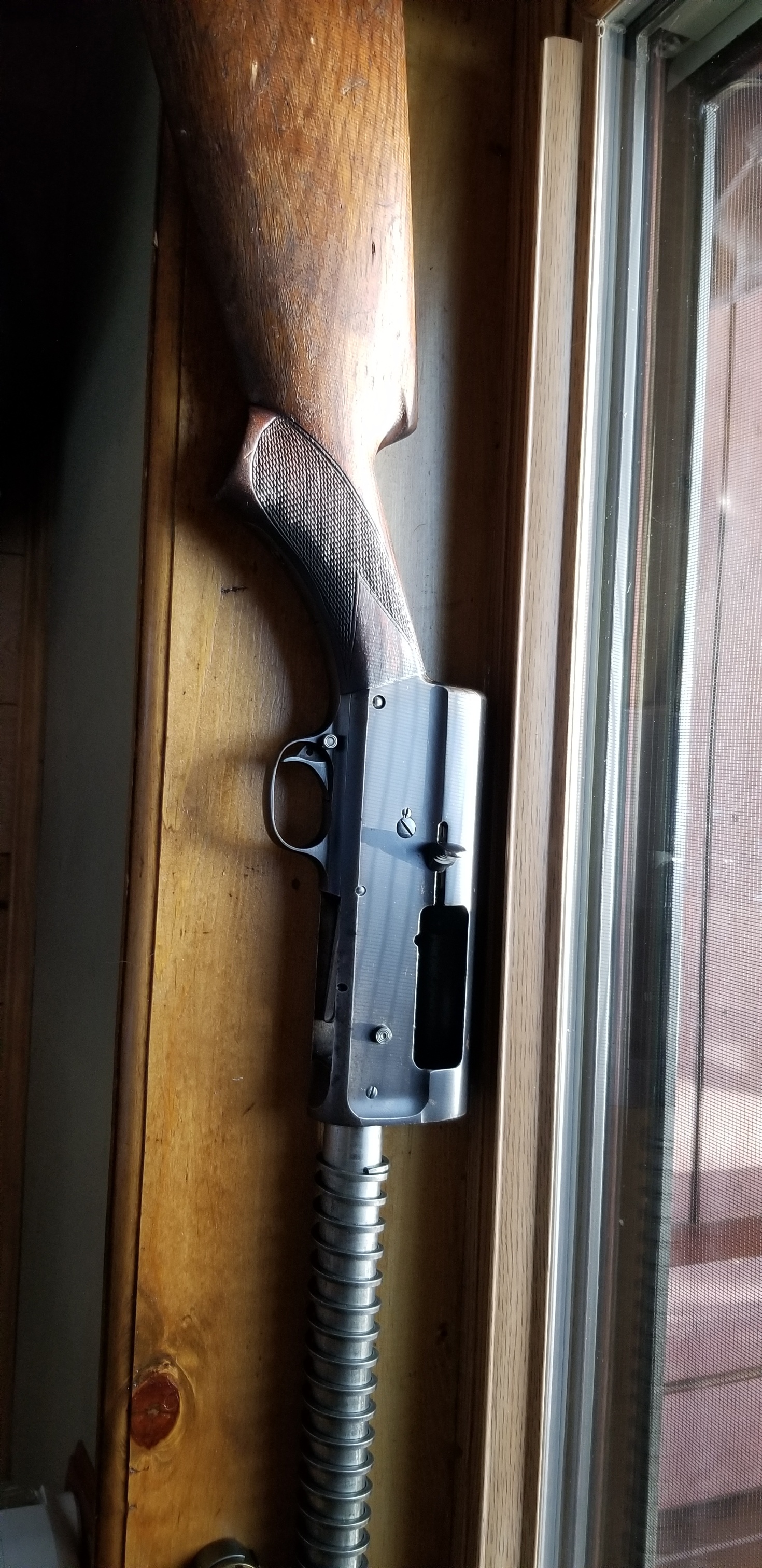

Hello gentleman I have a Remington that I inherited model 11 ,12 gauge shotgun with ser#355349 ,right side of barrel has REP marking left side FULL,safety is within trigger cover assembly.

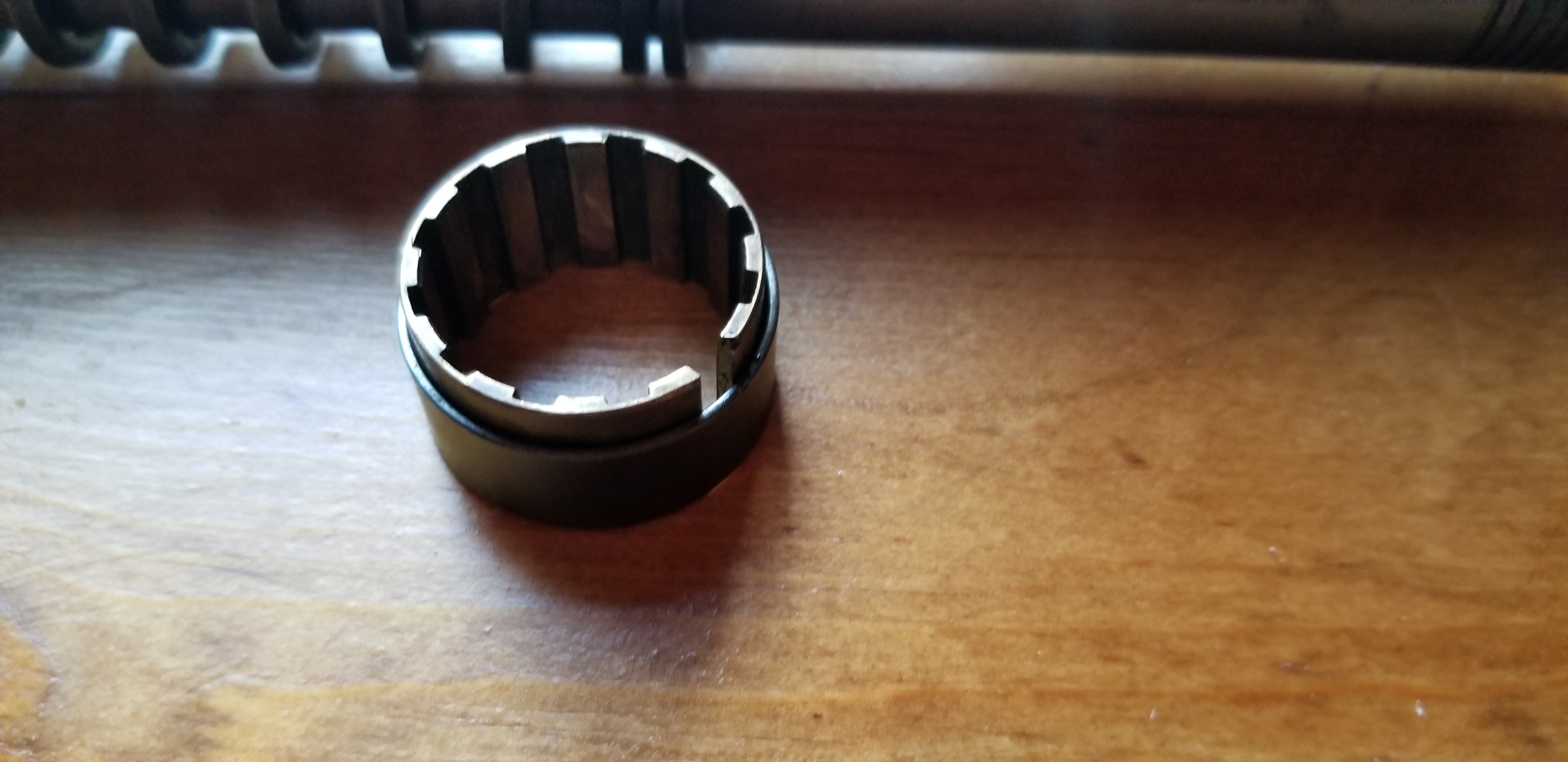

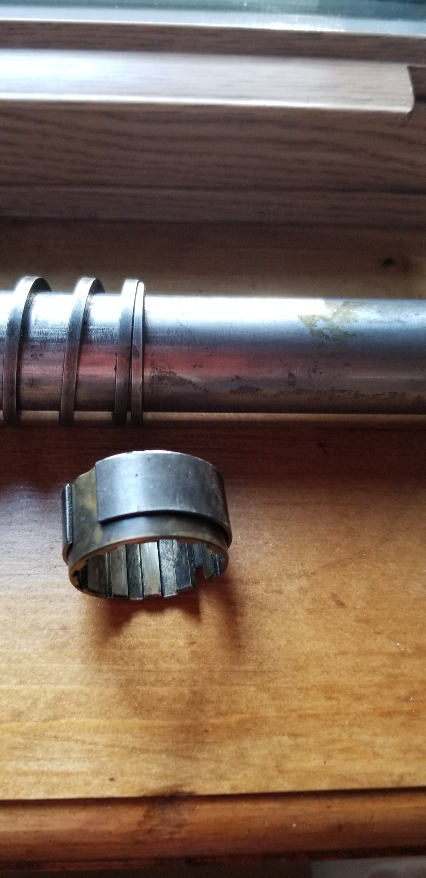

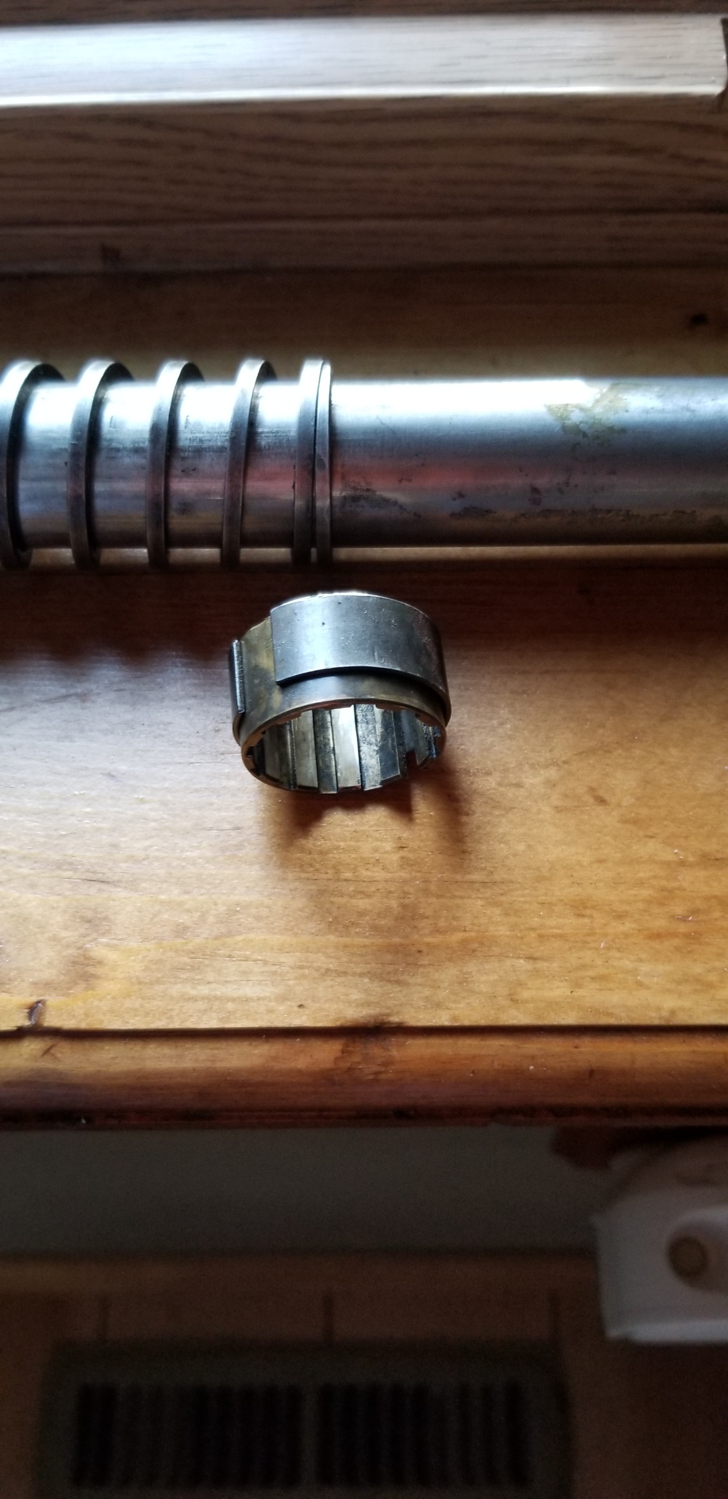

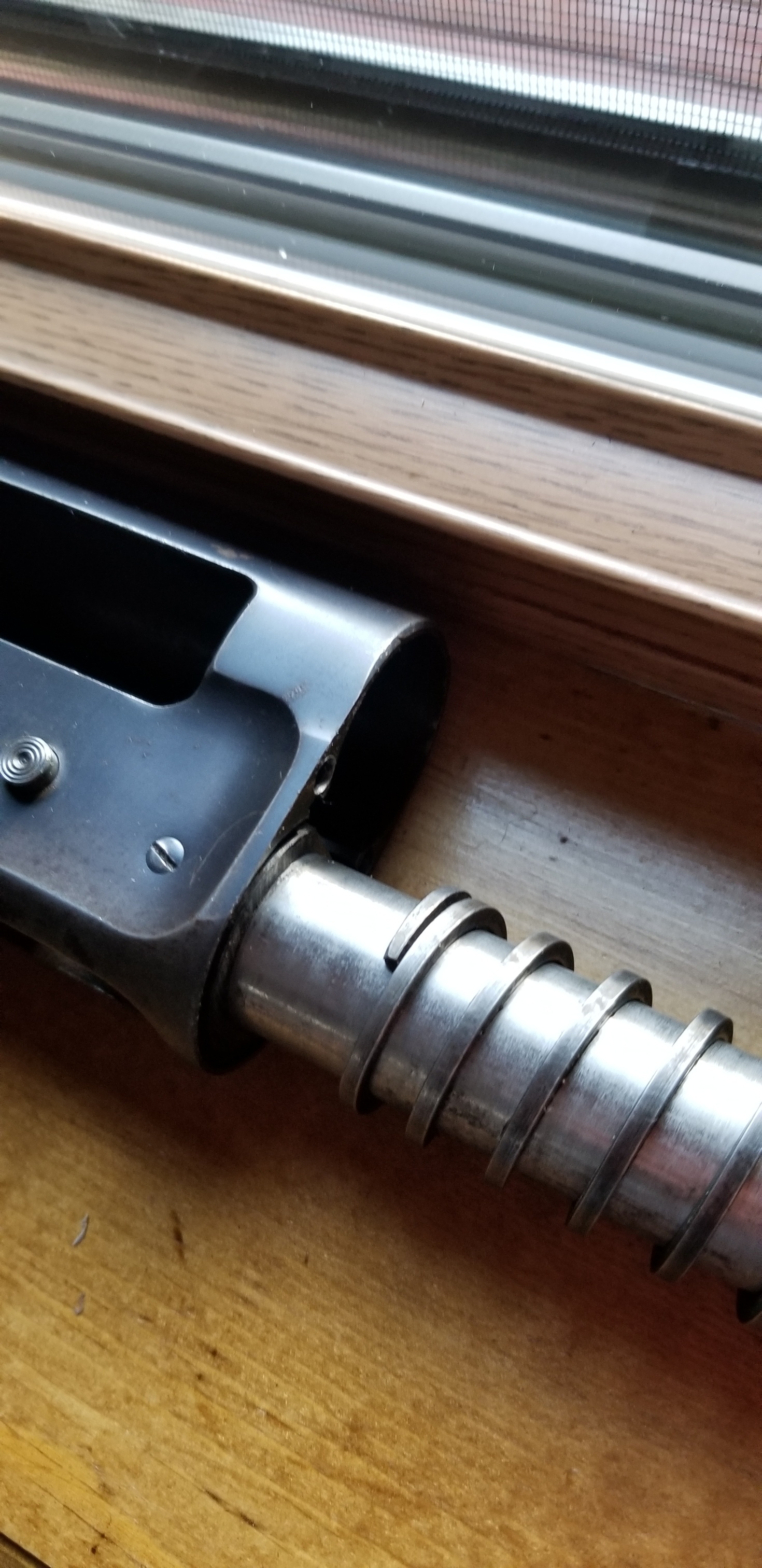

I decided to disassemble for inspection and cleaning and I found that the compression ring was missing ,only have the friction ring.Did this particular model had a compression ring and if they did can one of you gentlemen recommend a place were I can pick up one.Also will it fire without it.
Really appreciate the opinions and help
thanks
Mates64
