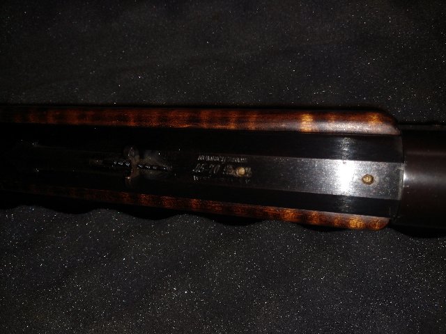

Need some experts to help ID my Remington Rolling Block. Numrick Arms .45-70.
From researching I believe Numrick Arms made kits with the new barrel and stocks.
The serial number, which is hidden behind the stock, is a low number three digit 1xx.
Can the experts advise what my Remington is and its value? I know from researching the action was very strong and could handle smokeless ammo.
What ammo would you recommend me using to fire it?
Thanks for your assistance,
Robert

Hi There,
I believe what you have is a later rolling block action.
They are called the No. 5 action and these were made
for higher pressure cartridges (like 7x57) originally.
Seeing that yours has the bar type extractor, it is an
earlier version (made from 1896 to around 1901 or 1902).
In 1902, the action was updated to the Day extractor
system that was more like an ejector than an extractor
(it will kick a spent shell completely out of the action).
The number stamped on the left side of the tang is not
the serial number. It is a lot number. Rolling blocks were
made in lots ranging from 10,000 to 35,000 units. Once
a lot was completed, the numbering was restarted in the
next lot. frames and trigger guards were mated and the
lot number made it easier to keep the two parts together
through manufacturing process.
As to value, I feel inhibited to put a price on it. It is mostly
subjective to the whims of the market. 45-70 is a popular
cartridge and the rise of BPCR shooting has made rolling
blocks in large BP calibers more popular (but I don't know
the quality of the Numrich Arms barrels and their suitability
to this sport). The action by itself is probably worth between
$300 to $500. The rest will depend on the quality of the work
done.
Good Luck!
-Blue Chips-

Thank-you for the response. I looked the No. 5 up in my 39th Blue Book, and it indicates on p. 1548 "Very few made - possibly only 300." The values are pretty high.
Please keep the responses and assessments coming.

Hi There,
blocks were made. Most were 7mm Spanish Mauser
(7X57) caliber. Other calibers are more rare (depending
on the caliber). According to the sales records of Shuyler,
Hartley & Graham, one of the largest distributors of
Remington rolling blocks, they sold over 40 thousand #5's
in 7X57 between 1896 and 1901. This does not include
#5's bought directly from Remington.
Seeing that yours has been re-barreled and stocks have been
changed, original caliber is moot.
Good Luck!
-Blue Chips-
Webb

OK, I'll disregard the note then in the 39th Blue Book.
Thanks for the information.
Robert
P.S., I was looking at this Black Hills Cowboy load for it: https://www.midwayusa.com/product/100190084?pid=860270
Seems tamer than some of the other loads. I assume it would be OK?

The mistake in the Bluebook of Gun Values might be based on the difference between #5 military rifles and #5 Sporting Rifles. The #5 in a Sporting Rifle is very rare, but military versions are plentiful.}
Yours is a military that someone reworked into a Sporting Rifle. Possibly Numrich, since they built some, but they sold kits, so it could be someone else bought the kit and assembled it.
Prices vary according to how well the gun was done, and fit and finish, plus wood quality are big factors. Not to be mean, but your gun doesn't have professionally fitted wood, as the rounded edges where it meets metal are more amateur workmanship. And since it wasn't color cased again, that reflects a lower quality build also.
Hard to say a price, as the market will determine that. But I'd be pretty surprised if it got over $750 in today's market.

I did see a Numrich sell recently on Gunbroker for $799:
https://www.gunbroker.com/item/851134125
Not sure about the model and other features differences, but the caliber was .444 Marlin.
Robert

I think you might see the difference in that GB rifle's stock fit and the case colors on the receiver also. Not sure the .444 Marlin caliber might not add to the value or not? Some love the caliber, while others would prefer the .45-70.

Also, the one on GunBroker is a later #5 action
with the Day ejector system.
