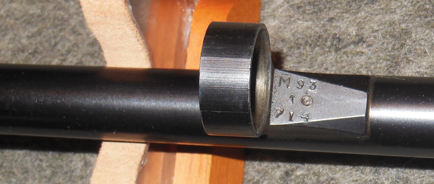

The REP in an oval is Remington's proof mark Remington Explosive Proof. The serial number of the gun should be stamped on each barrel at the base of the ring that goes around the magazine tube.
M93714 20-gauge barrel
The M stands for one million, so the serial number is 1093714.
