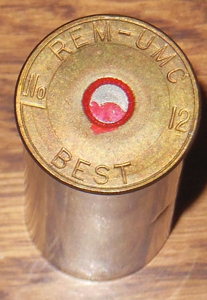

Not a shotgun question, but a Remington shotgun shell question: I have several old 2-1/2" all-brass 12 gauge shot shells marked "REM-UMC" and "BEST." They use a large pistol primer.
Can anyone tell during what period of time these were made?

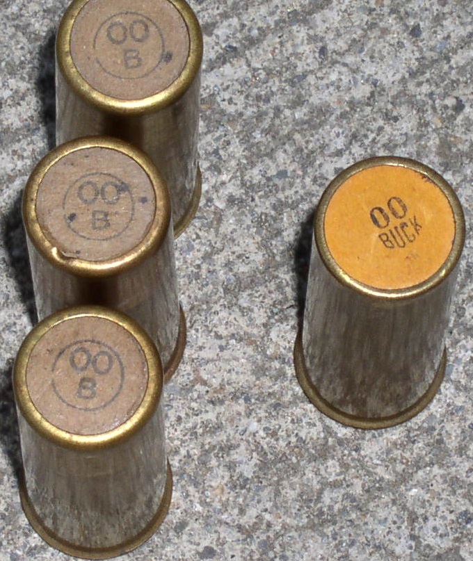

Both Remington and Winchester loaded brass 00-Buck shotgun shells for the military from WW-II into the Viet Nam era.
Winchesters left, Remington Right
Military 00 Buck Winchesters left, Remington right.JPG (230.27 KiB) Viewed 7761 times
Rem-UMC BEST
Rem-UMC BEST
REM-UMC BEST No. 12.JPG (278.97 KiB) Viewed 7759 times

Anything with a Rem-UMC headstamp would be from 1911 or later
