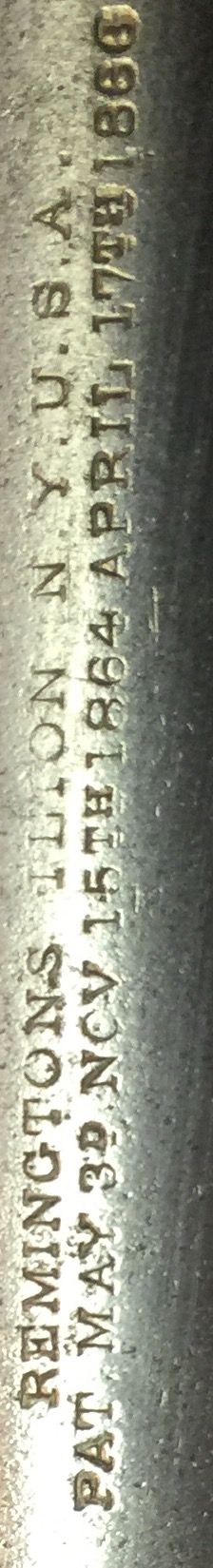

Hi all, my first post here. I'm trying to identify my newly acquired rolling block. This one has very few markings, and appears to be Spanish, or perhaps Egyptian that went to Spain or?
I have poured over the G. Layman collectors book, and am still unsure. By measurements, I believe it to be chambered in 43 Spanish. As soon as I can find my lost block of cerrosafe, I'll do a chamber cast. The bore and action are in pretty fine shape, and my intention is to shoot this gun, and not modify it in any way, other than to make sure it's safe.
The two line patent info on the tang reads Remington's ilion ny USA
Second line: Pat May3d Nov 15 1864 April 17 1866
The 3 brass bands are the slip off type with push tang retention. All are marked with a crown with a cross above. there are two more crown/cross stamps on the left side. One high on the receiver, and one on the barrel. There is also a 2" round impression on the left butt stock, basically unreadable. Just to the rear of that is an oval with what appears to be "JOB" in old English script. I have taken pictures of these areas, and attached them here.

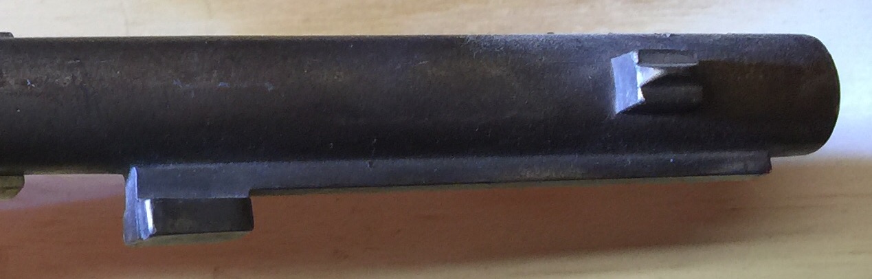

Barrel band and bayonet lug.

This looks like the standard "Spanish Model," made circa 1871. The caliber confirmed that. The two line patent marking is the early style, while the flat based breechblock was introduced in mid 1870. The rear sight is the Spanish style. The crown stamps are the same as on the Danish rifle, but that probably means that these parts were available in the parts bins and racks in the assembly room at the factory. The G by the number on the tang is typical of the alpha-numeric markings the factory used to track the assembled rifles.
