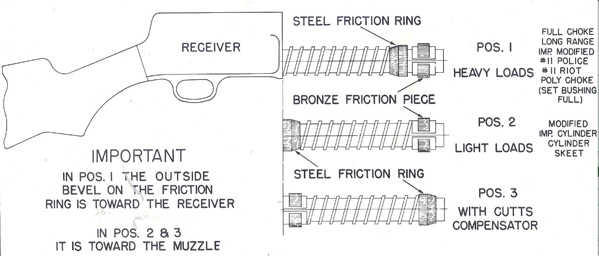

Hey TDodge7 -
Try and take a look at the friction ring settings document I have attached. This may be of help. Not sure what to say on a 20" barrel that has a comp attached, but maybe you can get started with this diagram.
Adam
friction rings model 11.jpg (63.58 KiB) Viewed 4987 times
Wherever you go, there you are!

TDodge7 wrote:Thanks, yes I've seen that diagram, that's what got me confused, is it suggesting that if you have a Cutts compensator that you're supposed to leave it on that setting for both heavy and light loads?
I think I wouldn't worry about the setting - just grab a selection of your favorite "shotgun food", bring along this schematic for reference, and experiment to find what works for you and your gun!
