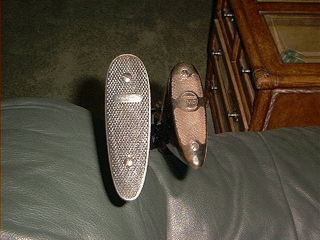

They are around on the auction sites mainly Gunbroker & Ebay but you need to know what you are looking for and none of the 141 buttplates had UMC on them. Most Model 14 buttplates had the UMC logo on thme but the 141 is either made of checkered steel or checkered aluminum with "Remington" embossed in it just below the upper screw hole. The early plates were steel, the later plates were aluminum and were numbered to the rifle, the steel ones were blued, the later aluminum ones were painted more of a gloss black.
I picked up one off Gunbroker last week for $20 which included the shipping.
I will attempt to attach a picture, if successful ..... the 141 plate is on the left, the one on the right is a shotgun style steel buttplate for a Model 14 with the UMC logo on it.
