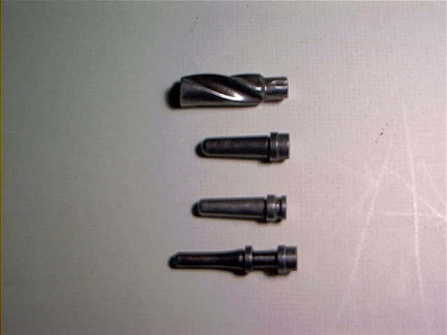

Re: Need Dimensions on a Model 14 Follower
For information!
(The second one down is the most common)
.35 Caliber followers in this design run from .472 - .487
(I consider .472 undersize)
.25, .30, & .32 followers in this design run from .430 - 442
(.435 would be "about" normal)
The two lower ones both measure around .442 and were used on late Model 14 rifles/carbines.............the bottom one only on the Model 141.
The measurments given are for the largest part of the follower or "belt".
The upper or "twisty" follower was used on very early guns and measures approximately .540...........go figure!
Enjoy!
Jim Peterson
Charlotte, NC
