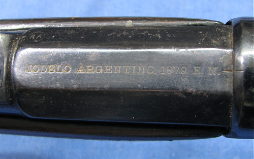

I live and work in Uruguay in South America and found a full rifle like this in Argentina recently. What you have is an action off a Remington Argentine Model 1879 Military rifle. You can still see pictures of this rifle on a recent sale on GunBroker.com (155831041). The 1879 Argentine Rolling Blocks were all chambered for the .43 Spanish round. There were both rifles and carbines in this lot sent by Remington, and all have a unique octagonal section at the rear of the barrel, on the top of which is stamped: MODELO ARGENTINO 1879 E. N. (E.N. stands for Ejército Nacional - National Army). There is also a cartouche on the right of this section with the letters RA (República Argentina). The barrels on the rifles were 36 inches long, and they had a long front stock with three bands as well as a bayonet lug on the right side of the barrel about 4-5 inches back from the end of the barrel. Yours definitely comes from a rifle, not a carbine, because 200 of these 1879 rifles were sent to the Provincial Police of Santa Fe. Santa Fe is both a city and a Province in the north-central part of Argentina. It has a long history that goes back before Argentine Independence. The rifles that were provided for the Provincial Police (not the city police, although the headquarters were in the city of Santa Fe) were never actually used except for perhaps parade or guard duty, so most that are found whole have a wonderful bore. It occurs to me that someone took the barrel off your action because of the good rifling. Yours is a quite rare action, and I would venture to guess that it is worth more in Argentina than in the US. The words in the cartouche on the left side of the action, JEFATURA POLICIA SANTA FE, would translate out: Headquarters, Police, Santa Fe. Any barrel for the Remington .43 Spanish from that era should fit on your action. But there are many other similar chamberings on the old Rolling Blocks, and you could just about choose what you would like to use. If you wanted to keep the 1879 configuration you would need to find a barrel with the octagonal section and the Argentine markings.

I would be interested to know if the number stamped under the Santa Fe Police cartouche is the same as that on the side of the tang - I can't tell from your photos what the number on the tang is. Another piece of info: most of the Military RB rifles we have seen were re-finished (re-blued) by the military arsenal before they were sold, very few are found with their original finish. What I also find intriguing is that several of these Santa Fe Police rifles (or actions) have shown up with that mark still clear, while most other Argentine military guns that were arsenal re-finished had the special crests or cartouches ground off before the re-finishing.
