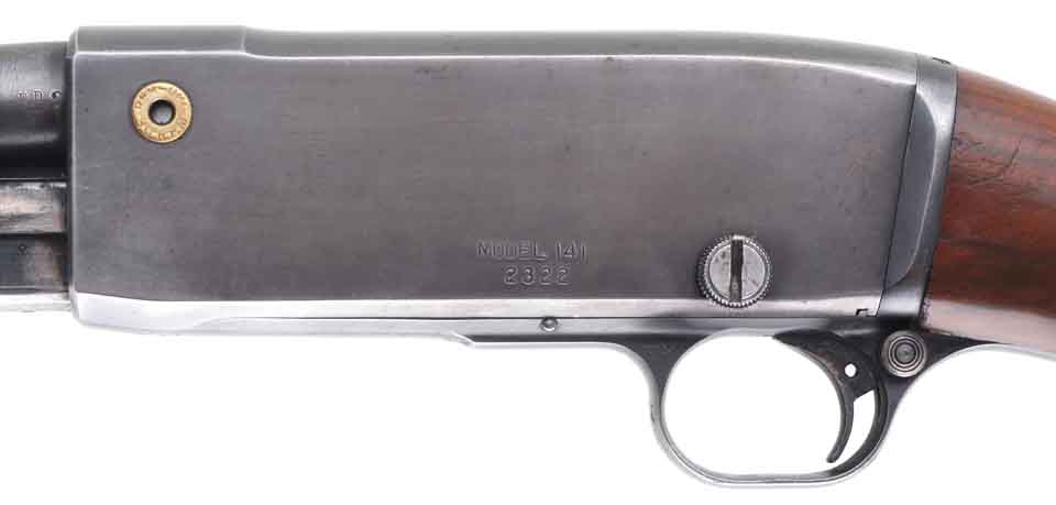

The transition started in mid 1935, when according
to an announcement to the jobbers, Model 14 guns ( 22 inch
and 18½ inch barrels) were shipped with the new Model 141
wood until March 1, 1936. These guns had the Model 141
stamping on the receiver as well as a new set of serial
numbers. Date coded guns of that time frame (mid 1935 to
March 1936) have those characteristics, and fall in the serial
number range of one to approx. 4000. These guns were not
stamped Gamemaster. Based on sales from previous years a
quantity of less than 20 carbines would have been shipped
during this eight month period. They were marked Model 141,
but without the Gamemaster stamp and had low serial
numbers. Carbines produced after March 1936 were stamped
Gamemaster.

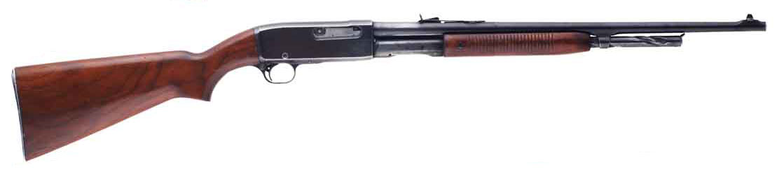

Remington Model 141R Carbine – serial number 28684
There is not much excitement shown by collectors when a
transition Model 141 rifle is discussed or examined. It is frequently
passed off as a gun made of left over parts until the new model
was released, but when a Model 141 carbine is discovered, the
excitement and the price go up by leaps and bounds. The truth is
they were both transition guns. The difference is that the carbines
died in the transition because there were no Model 141 barrels
made in carbine length.

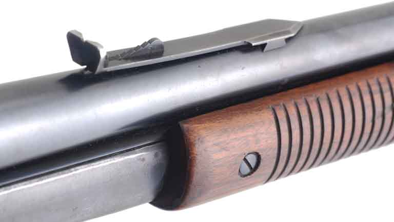

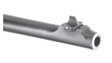

Remington Model 141R Carbine barrel address – s/n 28684
Page 21 3rd Quarter 2008

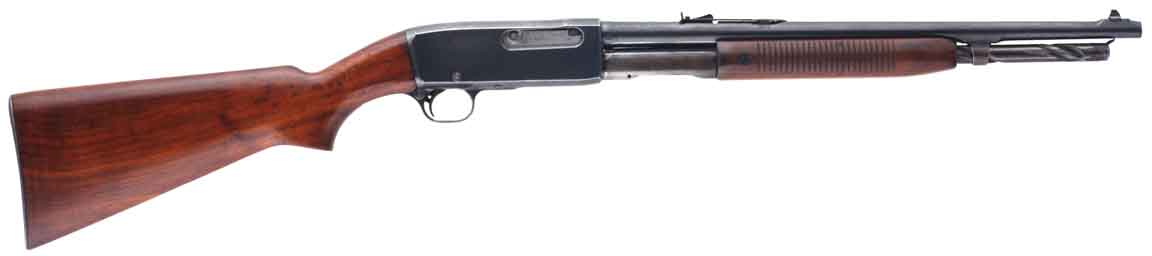

Remington Model 141R Carbine – s/n 28684

Model 141 Carbine Characteristics

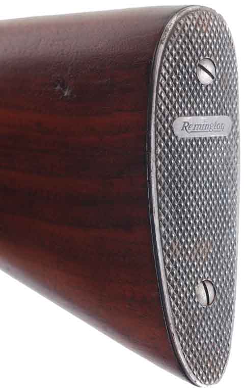

Butt-plate:
Shotgun style made of steel and deeply check- ered to avoid slipping. Has the Remington name engraved inside a rectangular box with oval ends.
Stocks: Plain rear stock with half pistol grip. Front stock is semi-beavertail with 25 grooves cut on the sides. Both are made of American walnut.
Receiver: Slide action, takedown, hammerless, solid breech. The Gamemaster logo and the serial number are stamped on the left side. Early receivers did not have the Gamemaster logo. At the end of 1938 a change was made to the Gamemaster logo, the line Trade Mark was changed to Reg. U.S. Pat. Off The ammunition indicator in the form of a brass cartridge head is embedded on the left side. It has an open center with REM-UMC and the caliber stamped on it.
Takedown: The Model 141R can be easily taken apart for travel convenience. The pieces are held by two vertical grooves that interlock as they slide together. A thumb screw bolt runs through both pieces to complete the lock up. Overall takedown length is 24 inches.
Safety: The cross bolt safety is located in the rear of the trigger guard. It locks both trigger and firing pin.
Barrel: Barrel length is 18½ inches. The caliber stamping is located on the left side near the receiver. At the receiver, on the left side are several codes, the left most is the inspectors stamp if present, next is a two or three letter date code, and next is the assemblers code. Every Model 141 will have a date code indicating the month and year that the gun was completed. Each time a gun receives factory repair another date code is applied with a 3, a code to indicate rework. On the right side of the barrel near the receiver you may find a REP to indicate Remington English Proof, a proof test of a heavier than normal charge. A small triangular mark indicates a magna-flux inspection was completed and the other mark if present would be the gallery mark indicating a function and accuracy test was done. Carbine barrels have the two integral projections called bosses or lugs which support the front sight and the magazine hanger, similar to the Model 14. On the Model 141 rifles these bosses were omitted
to reduce cost.

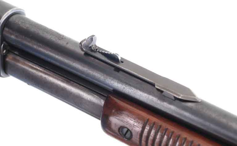

Sights: Remington semi-buckhorn, step adjustable rear-dovetail. White metal bead blade type, old stock Model 14 front sight – dovetailed into barrel lug.
