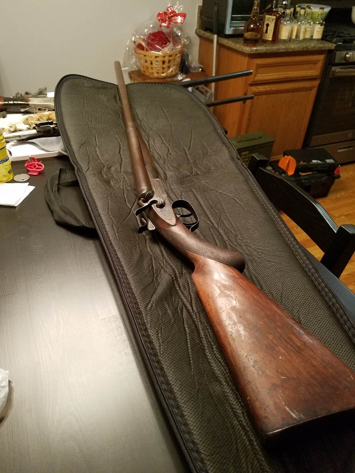

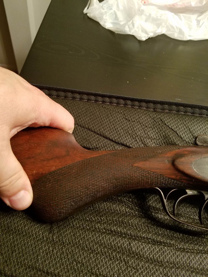

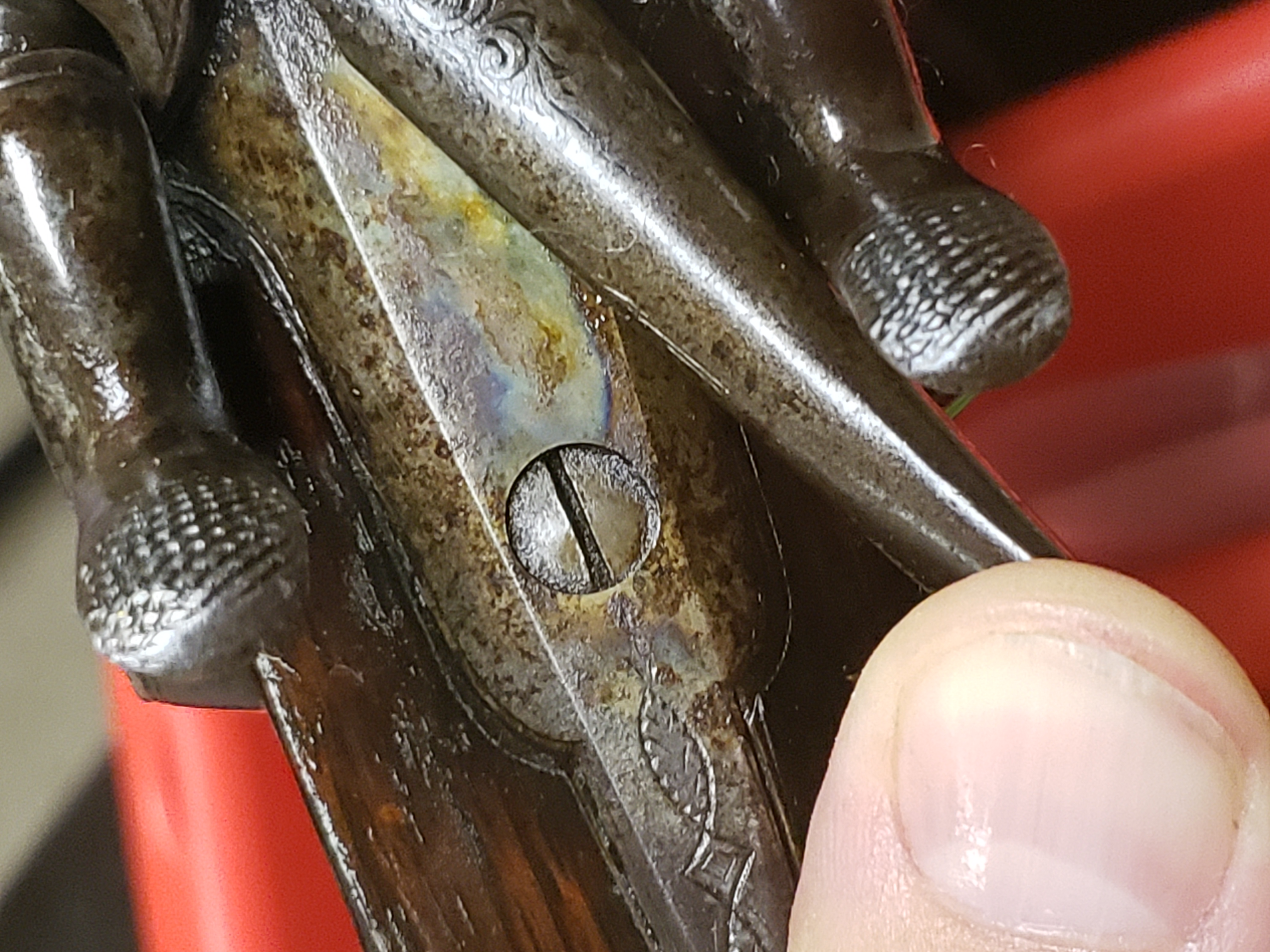

I am looking for resources in Michigan or surrounding areas regarding my recent find. I have a E. Remington & Son Model 1882 Grade 5 12 Gauge shotgun in amazing condition - started to strip the "Brown" off the metal but not sure if I am damaging more than cleaning. No idea on value either as is or restored - or even what it would take to restore. Beautiful engraving everywhere and very clean furniture. Tight and appears fully functional although I wouldn't dare shoot it without correct period ammunition - but have no intention anyways. Any information or dialog appreciated.

The Damascus barrels are suppose to be brown the receiver, locks and forend iron color case.If it is that nice I would leave it be.To me its worth more like it is be careful on you cleaning. Do not use sand paper. Do not refinish the wood.

ANY attempt at a clean-up, done wrong, will substantially diminish the value and collectability of the gun. Simply wipe down the metal parts with RemOil at this point.
Bachelder in Grand Rapids could give you an idea as to the cost of a check and clean vs. a full restoration, and then do the work.

I weekly shoot nitro loads in my 1873, 1882, 1889, and 1894s. Not each one, but one or two of them go to the club where I shoot three times a week. I reload, so it's not difficult to get low pressure loads. Mine are under 8000psi, but there are many loads out there for the handloader from 5000psi and up. The gun doesn't know if it's BP or nitro producing the pressure and Remington use to advertise that all their guns were good for nitro or BP. Bachelder once told me the British brown their Damascus, we Americans blacken ours. He hated to brown Damascus barrels. It's a shame Brad passed away so early in life.

Marty, why do you think it's a grade 5 gun ? Those are quite rare. I noticed the screw in the top tang wasn't engraved and the wood looked quite plain for a grade 5. Show us a picture or the type of Damascus the barrels have and a good view of the locks. Maybe I'm wrong with my assessment.
