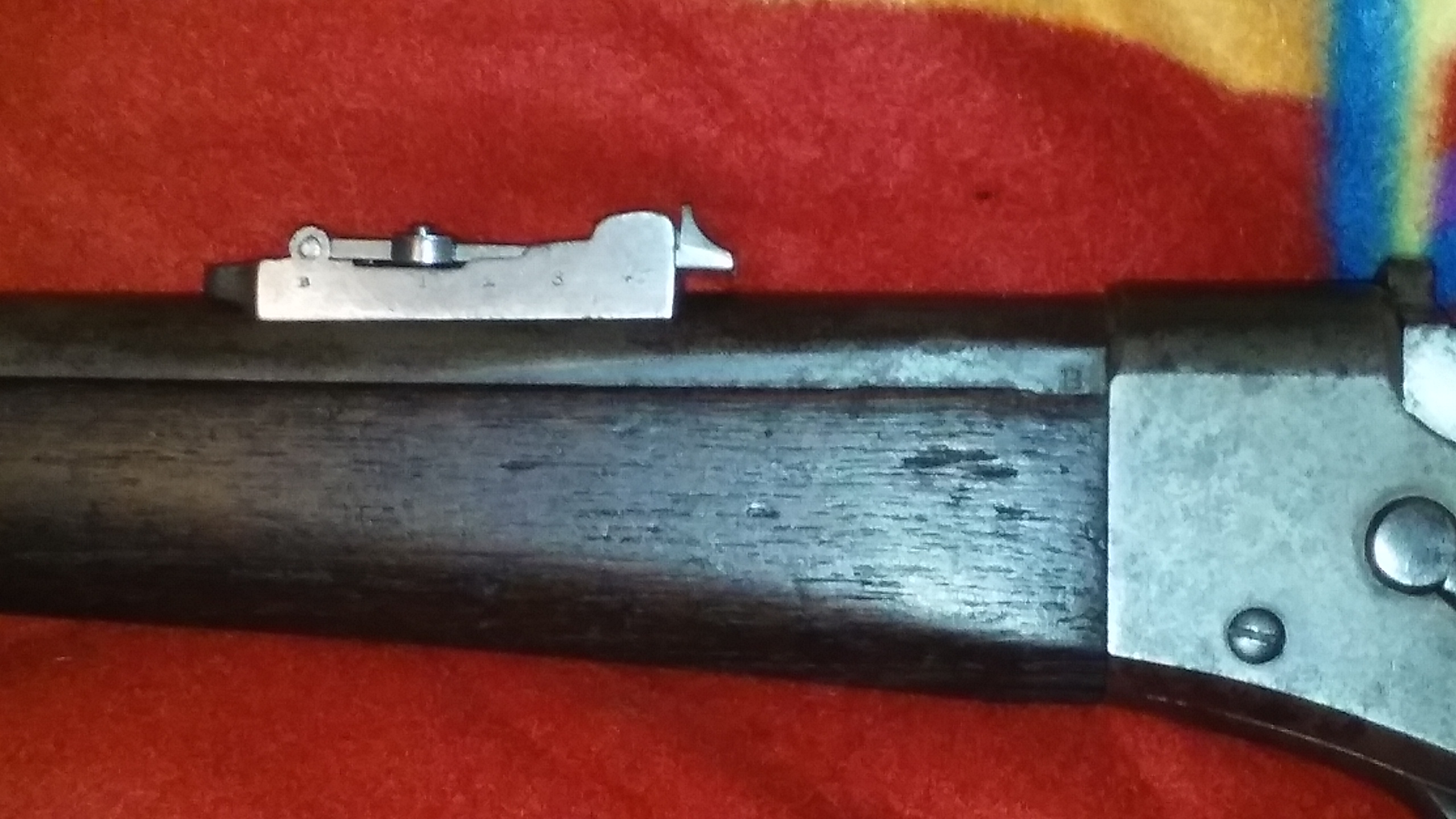

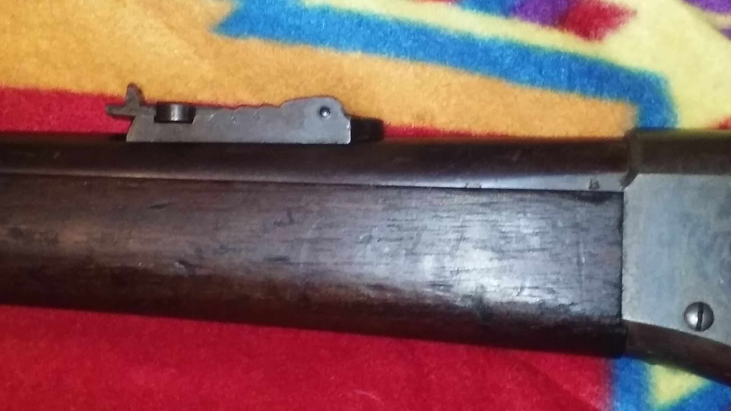

Here are the examples I have:
1st. A Danish made RB with their sight (I believe these
sights were installed by them as part of the 1896 update).
Notice that the pivot is at the front and the ramp is
towards the rear.
Next is a Remington made RB for the Danish contract.
Notice that the pivot is toward the rear and ramp is
towards the front.
Here is an example of the typical Spanish model
with the pivot at the rear and ramp towards the
rear.

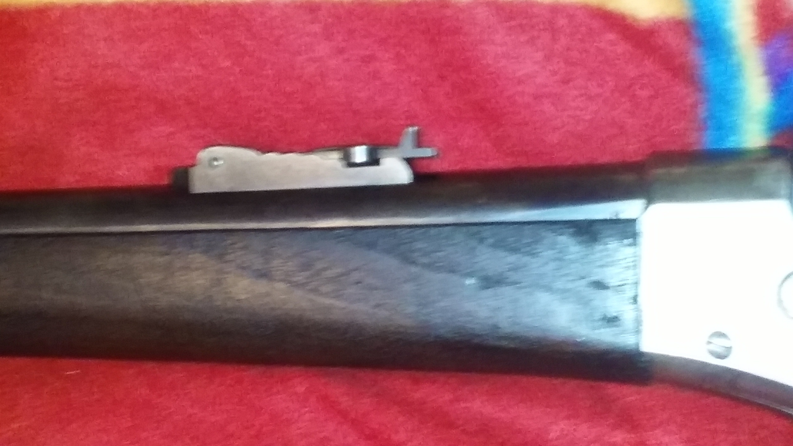

Next is another Spanish model but the sight is oriented
in the opposite direction.
Lastly, is an example of a 50/70 cal. Civil Guard RB.
This one has pivot towards the front and ramp towards
the rear.
As one can see, there was some variation in sight
orientation. Some of this was when sights were
changed by the Country of ownership as part of an
update program but others have the original factory
sights on them with different orientations.
