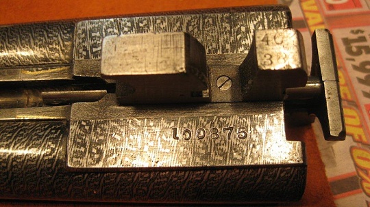

They were pretty common in the first 9000 guns. My Father's AE-Grade in the 103xxx range and a BE-Grade that I have in the 101xxx range are both made in that style.
100875 DE-Grade
100875 DE-Grade

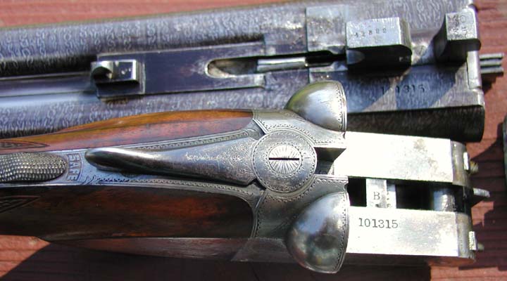

101315 BE-Grade
101315 BE-Grade
101315 BE-Grade 12-ga 07.jpg (61.22 KiB) Viewed 5725 times

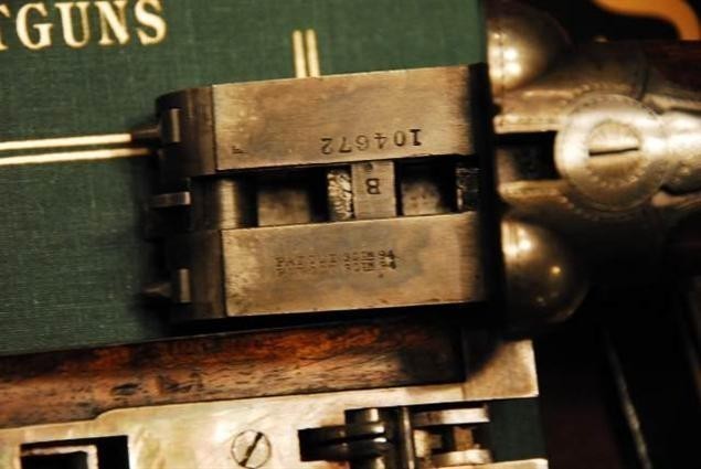

104672 BE-Grade
104672 BE-Grade
104672 BE-Grade 02.jpg (50.07 KiB) Viewed 5725 times

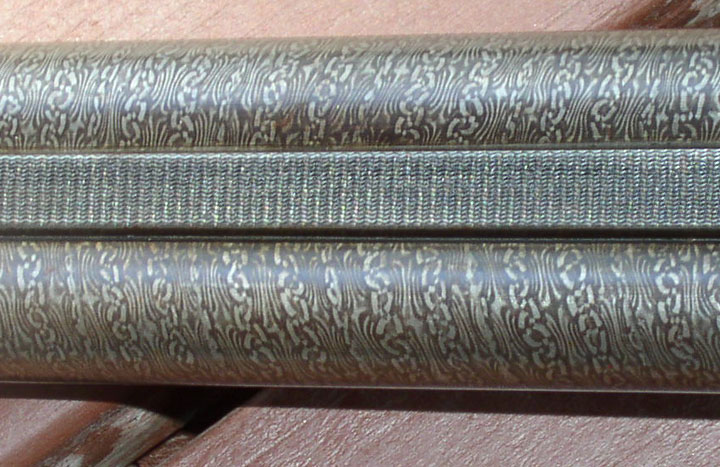

107252 AE-Grade
107252 AE-Grade
107252 03.jpg (560.73 KiB) Viewed 5725 times

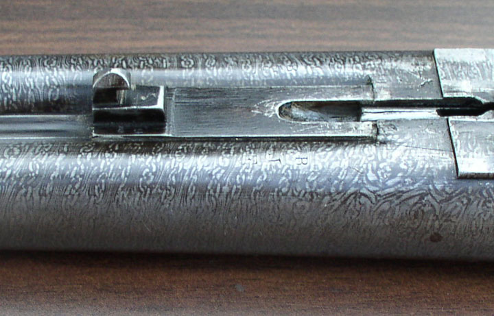

Re: 1894 with an unusual frame and barrel lock-up
My BE-Grade 101315 has Chain Damascus barrels --
101315 BE-Grade 12-ga Chain Damascus 08.jpg (122.63 KiB) Viewed 5219 times
and the bottom of the barrel tubes are marked B J E.
Forearm Loop Early.jpg (97.88 KiB) Viewed 5219 times
In Charles Semmer's book on page 275, he pictures the Damascus patterns salesman's samples, and the Chain Damascus is called CHAIN J. So, I have suspected that the J on my barrels has to do with the barrel material.
The truth is that no one left alive really knows what all the markings on these old Remington doubles mean.

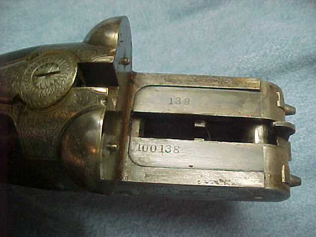

Here is a very early gun, also without patent dates --
100138 10.jpg (58.49 KiB) Viewed 5167 times
