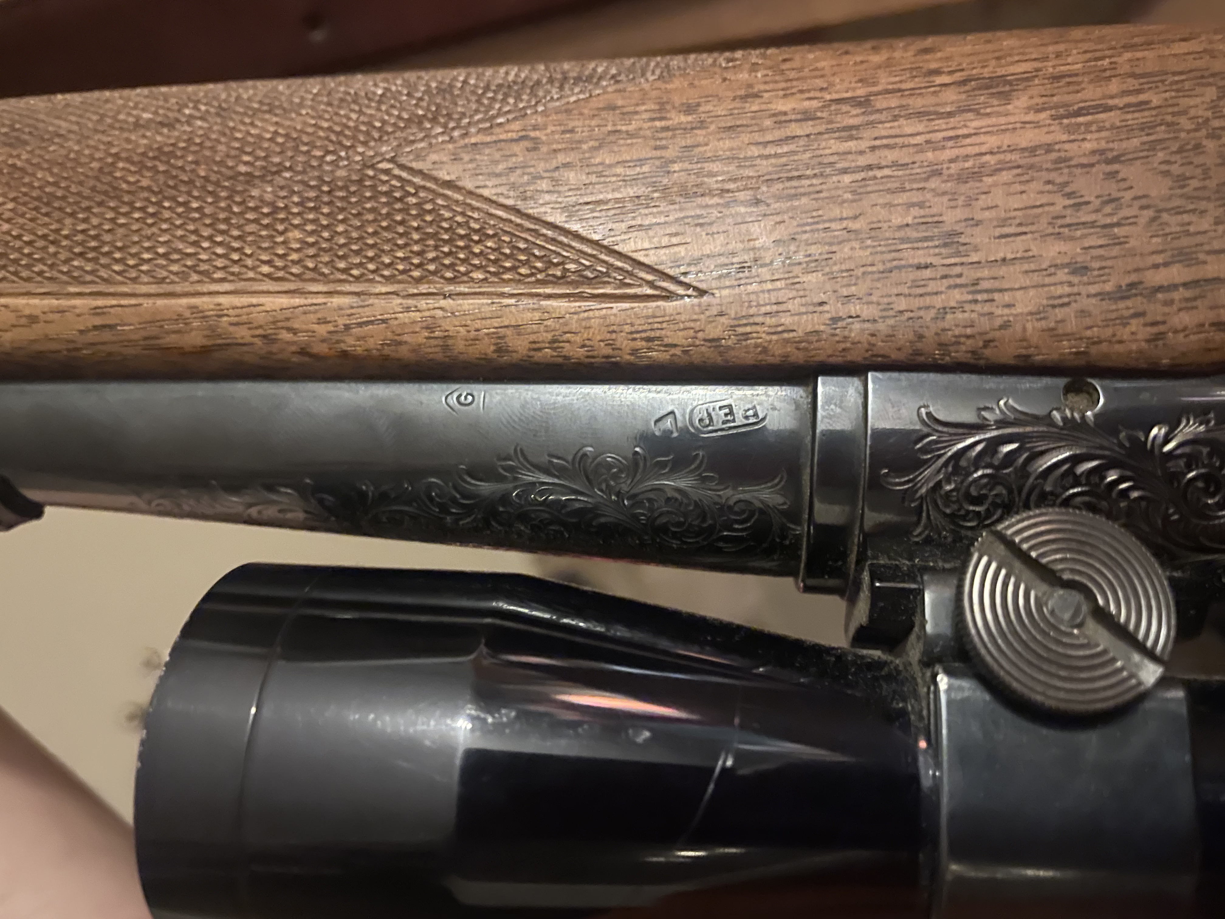

Joined: Sun Jan 12, 2025 6:46 am
Re: 721 722 725 dates of mfg
Post by Lagunita »
Hello new to the forum. Looking for some help to identify the grade of this 725. Based on serial number was manufactured in 1958. Caliber is 30-06 and appears to be factory engraved. Any help is greatly appreciated. Thanks
