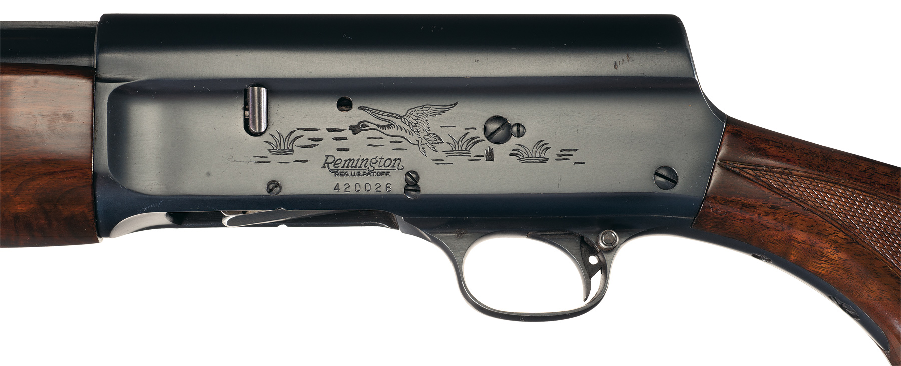

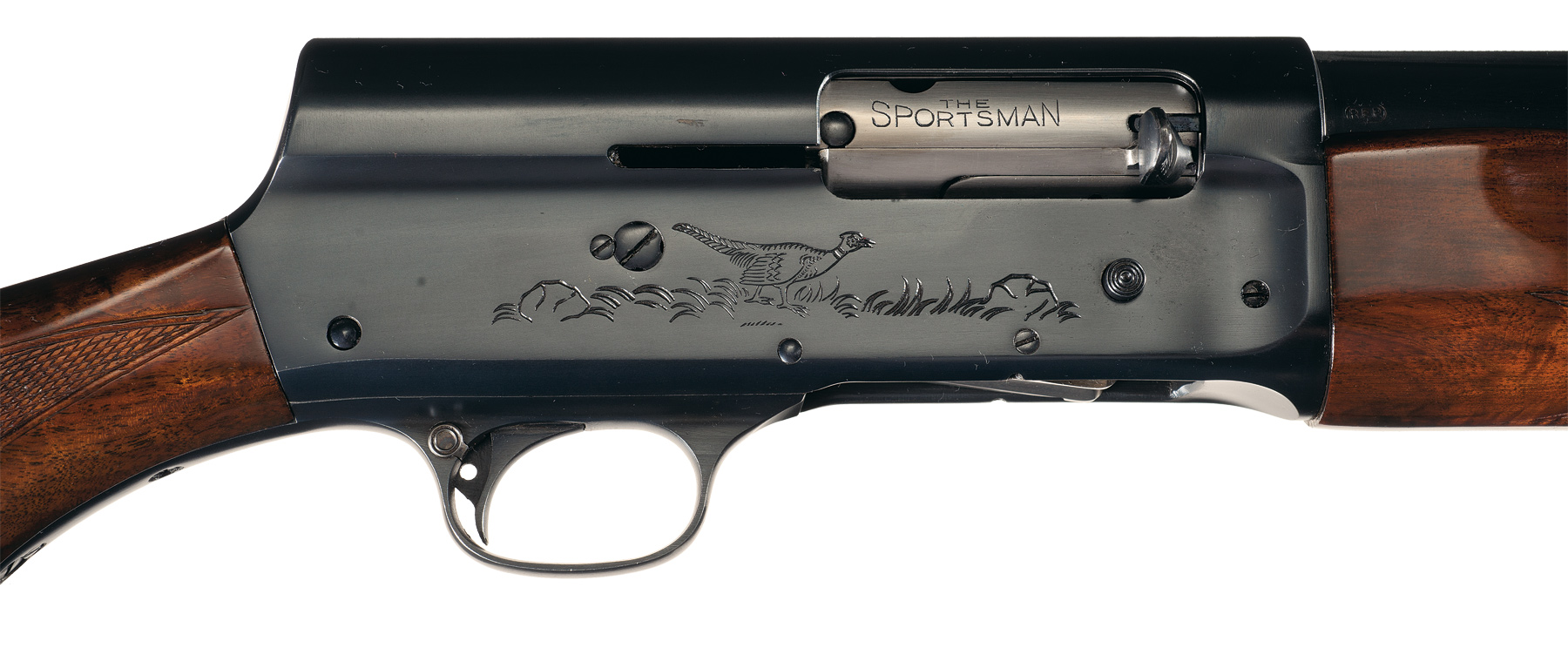

Early on the A "Standard" Grade The Sportsman had a three-bird roll-stamped scene on each side of the receiver and the name The Sportsman roll-stamped on the upper left side of the receiver.
S5164 Sportsman 20-gauge.JPG (378.46 KiB) Viewed 18589 times
Model 11A "Standard" Grades had plain receivers. About 1936-7 the roll-stamped scene was reduced to one bird and applied to both The Sportsman and Model 11

and the name Model 11 or The Sportsman was stamped on the breechbolt.
The Sportsman Skeet Gun right close.jpg (361.07 KiB) Viewed 18589 times
