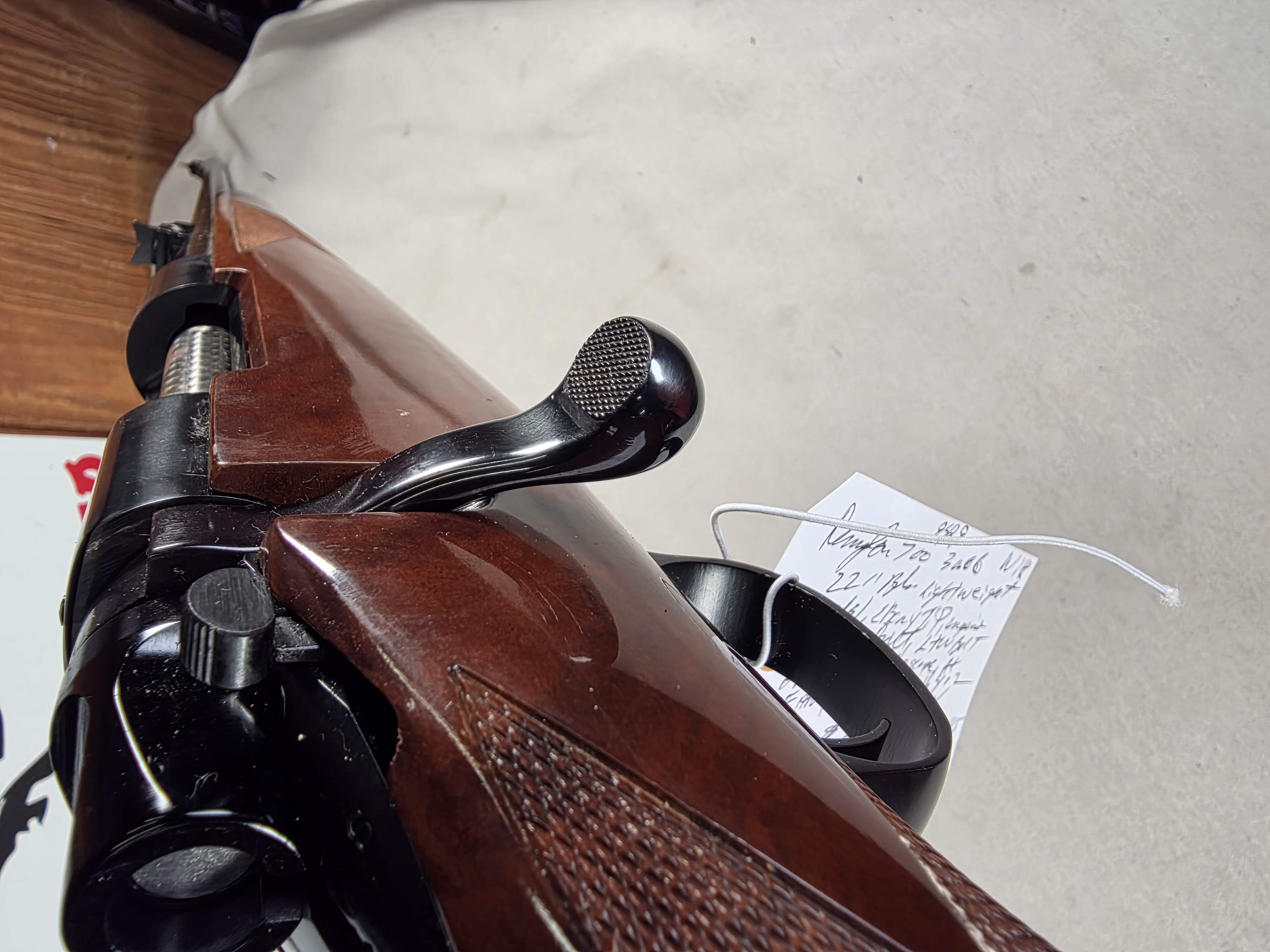

Seller emailed me some pics of the bolt handle, and its definitely different and more Steyr like than Remington like.

Definitely has had work done to the bolt. I can't tell much from this one picture except that I doubt this rifle was modified outside the US. The Stock is a factory stock; you can tell by the pressed checkering and the forearm checkering pattern. A custom shop would have hand-cut the checkering. I can't see the tip, so I have no clue what it might be. The bolt handle looks to be a reworked factory handle. The bolt shroud has been lightened, and the lightening is really nice; I'd guess that if they went to all that trouble, the bolt face will have a bushing as well. From what I can see, which is very little, the rear and front sights look to be early ~ 1965ish. "C" prefix designation was used starting in November 1987 through the late 1990's can provide pictures of the date stamps on the side?

Perhaps the link above will help. As to your assertions, wrong on many accounts. Williams sights like this were never used on a model 700 by Remington.
Stock is not factory, nor is the checkering a pattern one they used and its certainly not pressed, its at least machine cut.
Forend tip is a light contrasting wood with no spacer.
The bolt handle is vastly different from a Rem handle and likely not 'reworked', but a totally new handle welded on.
I continue to believe this rifle with all the foreign proof marks and date codes was likely built overseas or sent as a factory barreled action and built from there, perhaps a one off, but perhaps as a group buy of some sort, be nice to know but barring any evidence awfully hard to prove.

For the bolt, If you say so, but that is pressed Remington pattern checkering; you need only compare it to late 80's though 90's stocks. You provided ONE picture and asked to have YOUR findings verified; you keep mentioning the " foreign proof marks and date codes" but have yet to provide a picture of them. If you're so sure, then why even ask?

No I dont think that is pressed checkering, but I think depending on the angle of the photo and lighting, it does appear in some of the pics as if could be, but I dont think so, with press checkering the points are pressed into the wood as opposed to cut that has the points out of the wood.

Ahhh, my mistake; I do not know why my eyes (and brain) ignored your link to the rifle. Now that I have seen the other picture, you are correct: the rifle is foreign-made. It has both the Italian Brescia Provisional Proof, star above the shield with two crossed rifles, and the star above the PFS is an Italian Gardone proof marks. The two-letter code inside a small square box BD, means that it was manufactured (or proofed) in 1994. The CAT. 616 is an Italian commercial registry number used from 1975 to 2012, another sign it was imported.
The rifle stock is a factory stock and even zooming in (at least to me) is pressed checkering. The ad says it is a " ebony tip" the picture of the tip is very blurry, " so I enlarged the picture of the full rifle, and it looks like a stained end, not one that was added; the grain seems to flow from one side to the other, and the edges are not crisp like they would be if a tip was grafted on. The rear sight is, as you said, an aftermarket, less common Williams Guide Open Sight "SQ"
