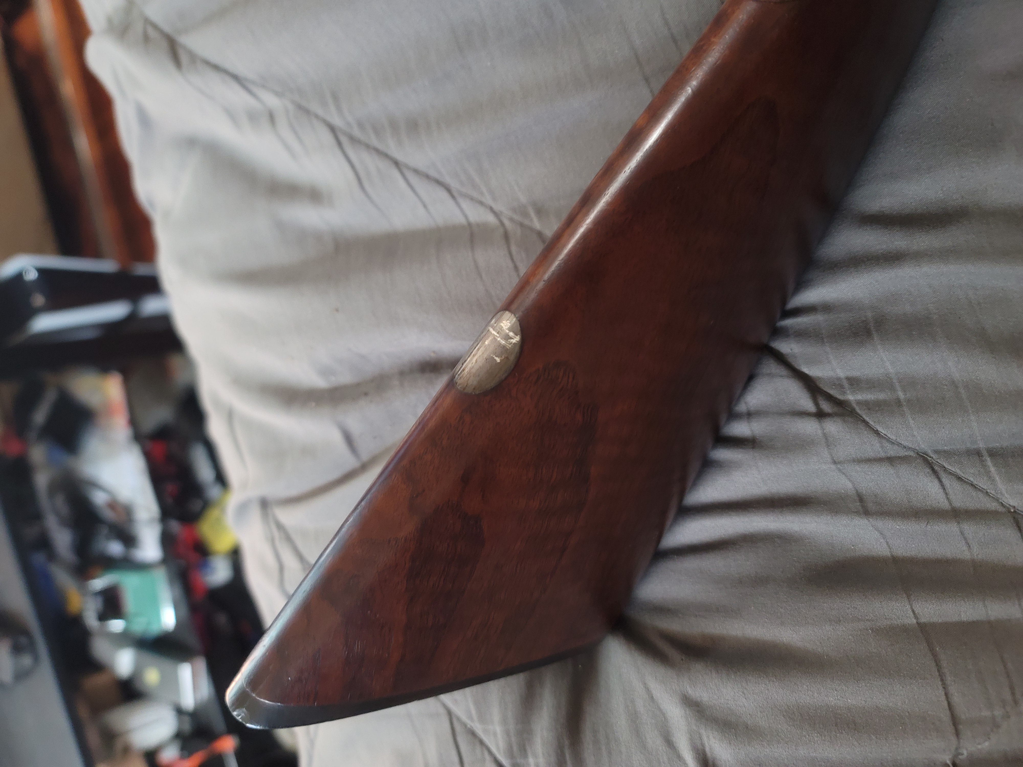

So i have a rem 1894 serial number dates to 1907 i believe ,its a grade c with ordnance steel barrels and ejectors it has a raised matt rib and i believe is chocked tightly along with a silver initial ovel and a pistol grip stock thats fiddle figure barrel marked ordnance i read there was only a hand full of c e o traps made in 1907 and that somone docemented two was wondering if anyone had any documwntation on this one thanks for any help and god bless!

Why would a circa 1907 CEO-Grade Remington Hammerless Double be "rare"? The CEO-Grade Trap Gun had a straight stock. Trap guns from the 1907 Remington Arms Co. catalog --

I believe its rare as they were only produced during 1907 from wat iv gathered the 1907 c e o trap is really rare and there is somone who banks these serial numbers that person stated that theres only two recorded serials for c e o traps and both date 1907, second ik they were straight but could have been optioned with a pistol evrything else lines up with the c e o trap ad, wondering wat those known recorded serial numbers are if somone can get them also wondering if anyone has documentation on this specific serial as only a handfull were made in that year and likly owne by profesional shooters or a close friend or family of the dodges who owned rem at this time obviously a stretch on whos it is but i do beliwve it to be a rare c e o trap can anyone help verify rarity and wat it is and origins thanks god bless!

The gun you pictured has a half-pistol grip of a regular CEO-Grade. The CEO Trap Gun is listed with a straight grip in every Remington Arms Co. catalog from the 1903-04 --
According to the pellet counts on your rear barrel lug your gun left Ilion choked cylinder and improved modified. We know from guns that survive with their hang-tags that if the number on the lug is three digits that is it and if two-digits a leading 3 is implied, so your gun patterned 181 pellets in a 30-inch circle at forty yards from the right barrel and 334 pellets in a 30-inch circle at forty yards from the left barrel.
Twelve-gauge Remington doubles of this vintage were targeted with #8 chilled shot in UMC Nitro Club load X8 - 3 drams of bulk smokeless powder or 24-grains of dense smokeless powder (such as Infallible or Ballistite) pushing 1 1/4-ounce of shot. One and a quarter ounce of #8 chilled goes 511 pellets. 181/511 = 35.4% 334/511 = 65.4%
