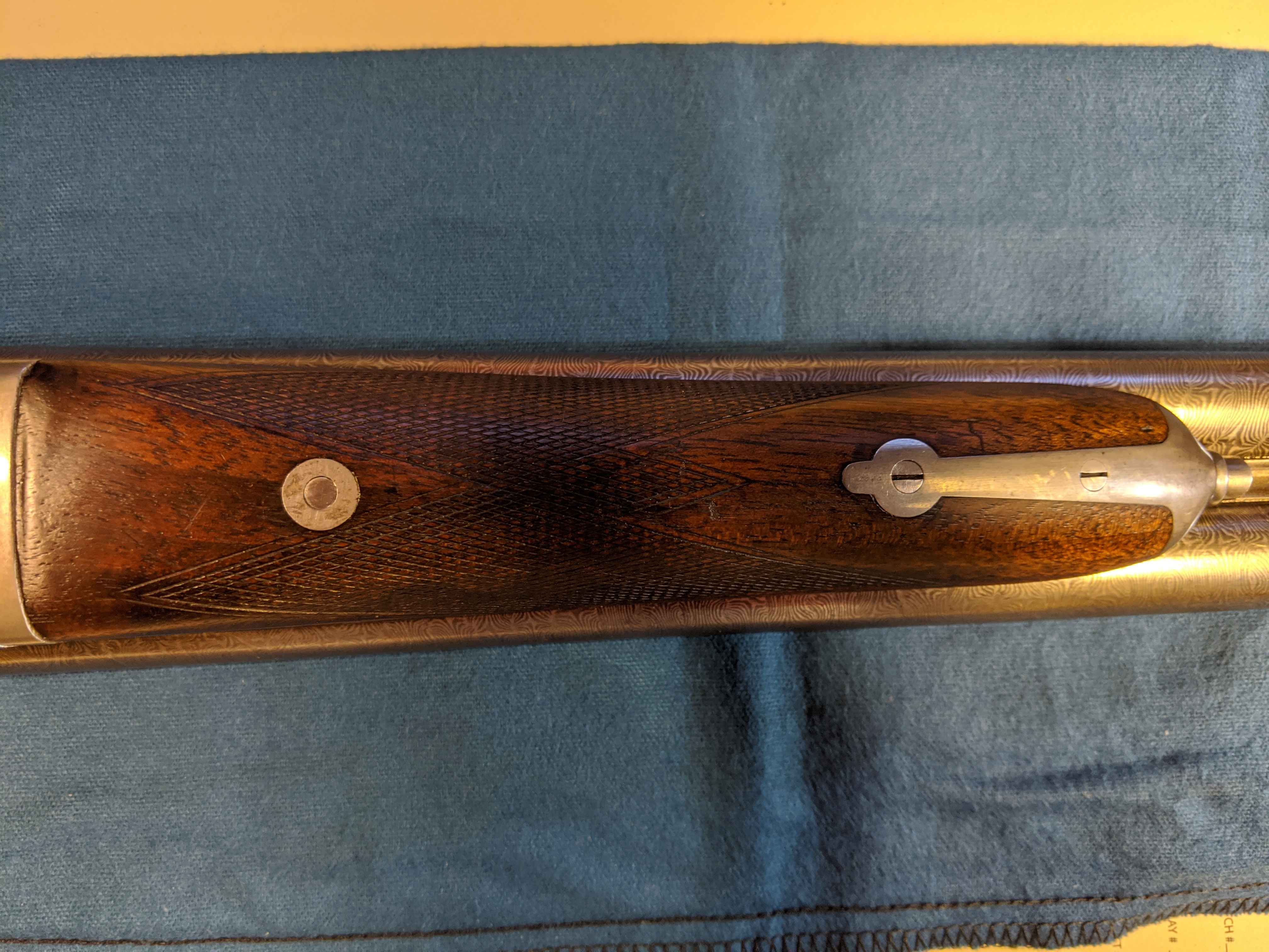

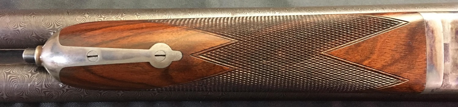

If you have a photo of the forend from a Grade AE 1894 that shows the screw heads both under and outside I would appreciate seeing one. I wish to check the finish on my gun against one that is in top condition.
Posts: 1121
Re: 1894 AE forend photo request
Here are a couple of pics from a pretty clean gun --
107252 14.jpg (207.11 KiB) Viewed 6891 times
107252 10.jpg (226.36 KiB) Viewed 6891 times
cthraen
Posts: 24
Joined: Sun Dec 29, 2019 6:21 pm
Post by cthraen »
Researcher wrote:Here are a couple of pics from a pretty clean gun --
Thanks. Has the head on the rear screw been blued, or did it come blued as in the photo?

dieNusse1
Posts: 433
Location: Mishawaka, IN
Post by dieNusse1 »
I believe blued screw heads are correct.
Posts: 1121
I pulled the forearms on my two highest original condition guns, CEO and DEO and on one that little wood screw is color case hardened and the other blued like this gun?!? On my only AE-Grade, the gun my Father shot for over forty years, that little wood screw is replaced by a machine screw and escutcheon. Same on my FE-Grade Trap Gun.
cthraen
Posts: 24
Post by cthraen »
Researcher wrote:I pulled the forearms on my two highest original condition guns, CEO and DEO and on one that little wood screw is color case hardened and the other blued like this gun?!? On my only AE-Grade, the gun my Father shot for over forty years, that little wood screw is replaced by a machine screw and escutcheon. Same on my FE-Grade Trap Gun.
Thanks. This is the information I was looking to find. On my AE, the wood screw has also been replaced with a thought screw and escutcheon. Nicely done, but likely not original. Finish and color as with the barrel latch.

cthraen
Posts: 24
Post by cthraen »
Sent from my Pixel 3 using Tapatalk
Will you post a photo from your father's A. I will do the same and we can compare the style.

cthraen
Posts: 24
Post by cthraen »
AE from 1899
Posts: 1121
The machine screw and escutcheon were a repair my Father made to his gun in his late years of using it. Charles Semmer shows two similar repairs at the bottom of page 224 of his book that I'm sure were done many years after the guns left Ilion.
