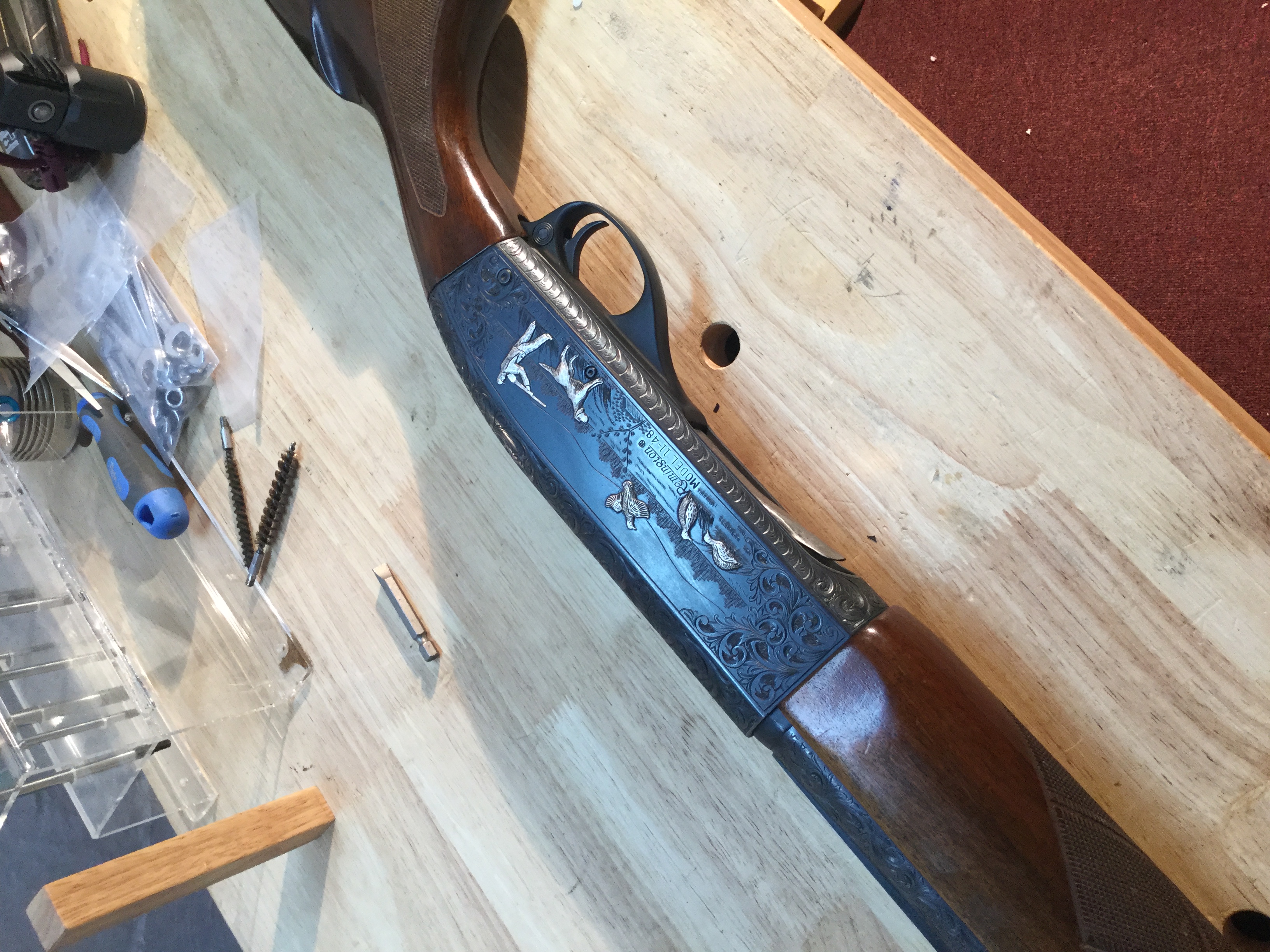

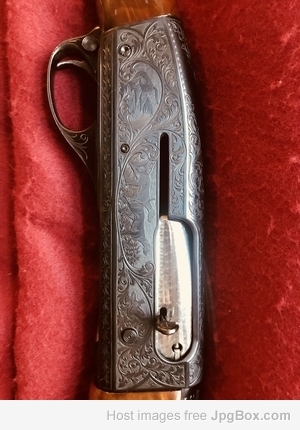

Was able to get some pics today;

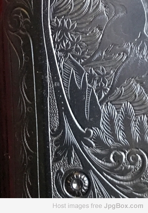

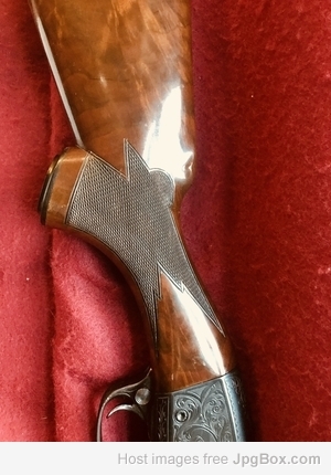

Post by Foxnut »

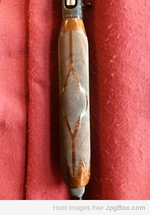

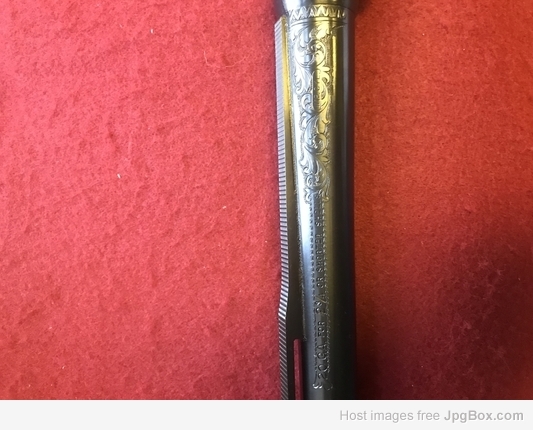

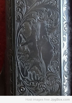

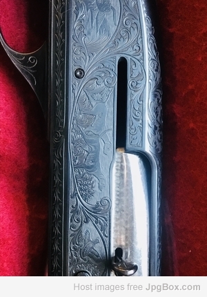

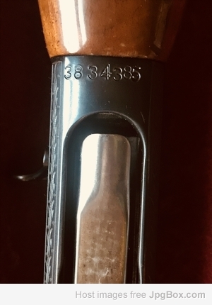

Addl Pics:

Re: Remington 11-48 F Engraving
Post by GeneM »
Excellent photographs.The RSA Research Team has been researching the Remington Archives in Ilion. The slanted "E" is Master Engraver Carl Ennis's signature. He retired from Remington July 31, 1978.
There are a few records of Carl's early work. Several india ink engraving "pulls" on oil cloth are in a private collection. Sportsman 48F's serial number 3834385 was done 12/1953 and serial number 3834386 done on 1/1954.
Bob Runge, also a Remington Master Engraver, kept detailed records of his work. His Log Books are in a private collection. Sportsman 48F serial number 3834384 was done by him 10/16/1953.
It is interesting that the serial number on Sportsman 48F, sn 3834385, was stamped as most Remington Custom Shop engraved firearms had hand engraved serial numbers. Guess one can never say never about Remington Firearms.
