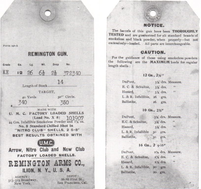

The first catalog listing of 26-inch barrels for the K- and KE-Grades is in the 1908-09 Remington Arms Co. catalog. The KD- and KED-grades were never offered with 26-inch barrels. The late Charles Semmer showed this hang tag for a 26-inch barrel KE-Grade --
372340 Hang Tag KE-grade 1908.jpg (198.27 KiB) Viewed 5324 times
in his book, Remington Double Shotguns, and according to his serial number chronology it would be a very early 1908 gun. There is a good chance the boys and girls on the factory floor at Ilion were making them before the folks in the office got the information into the catalogs.
Of note about this hang tag is that by this time UMCs NITRO CLUB shell with Load No. X 8 was only offered in a 2 3/4 inch shell.

Researcher, thanks, I missed that hang tag - but it's right there on page 260. So I guess the answer to my question is yes, the 1900 was made with 26" steel barrels although probably not until well into the gun's production history. But here is evidence that by early 1908 the shorter barrels were being made.
You are an amazing source of information on these things. Thank you!
