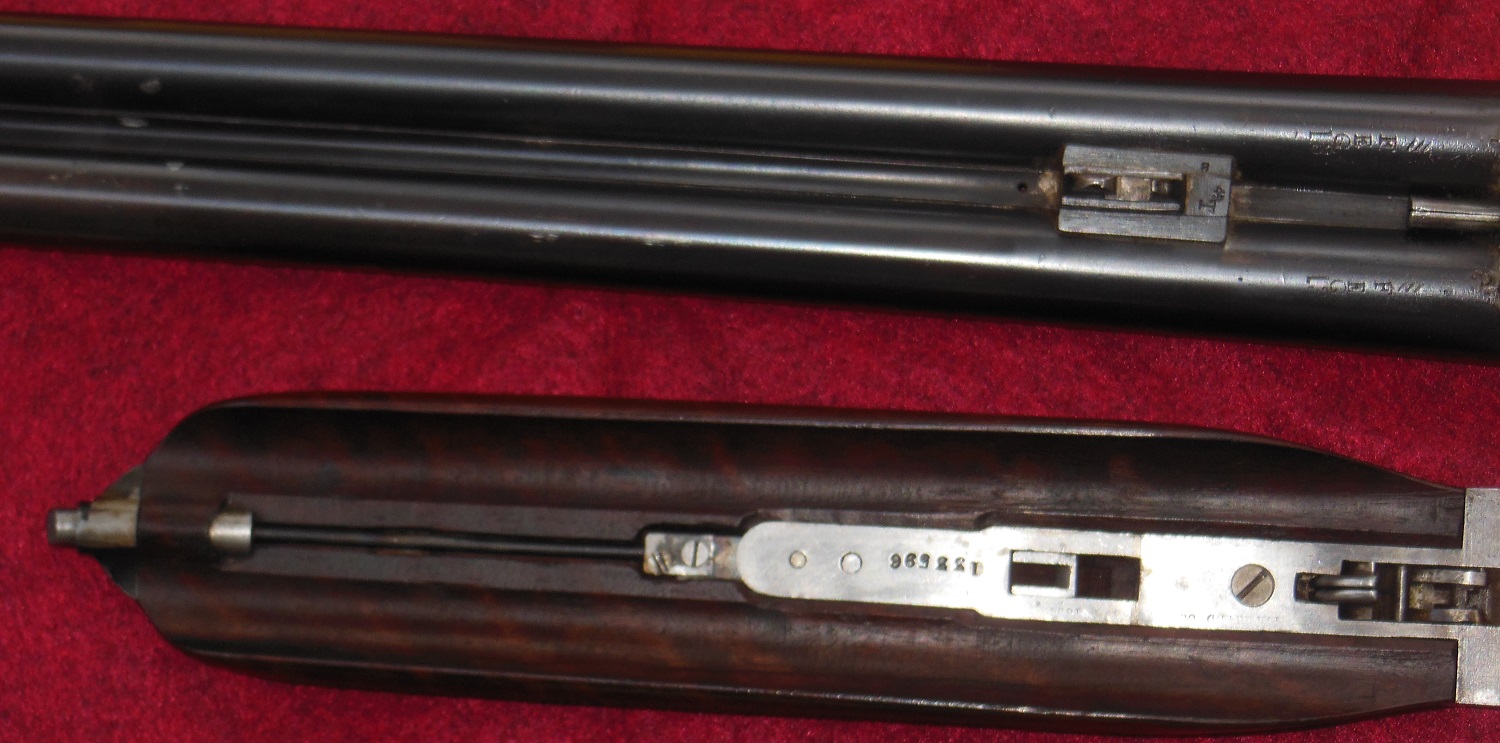

The lowest FE-Grade Trap Gun serial number I've recorded is in the 1329xx range, which falls in with Charles Semmer's serial number chronology for mid-1905. So, only about 8200 guns made from their introduction to the end of production, and if they were 10% of production, 820 guns. I have one that was owned by an old Pennsylvania pigeon shooter, 1 3/8" drop-at-comb by 2 1/4" drop-at-heel by 14 1/4" length-of-pull. Those are the kind of dimensions hard to find in old American doubles. Downside is he'd opened the choke in the left barrel to .018" and the gun is fitted with a nice, but certainly not original, beavertail forearm.

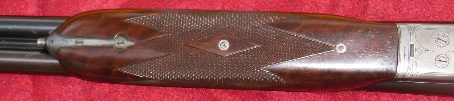

Parker Bros., Ithaca Gun Co. and Hunter Arms Co. all began offering beavertail forearms on their doubles in the mid-1920s. After shooters felt the big forearms on their single barrel trap guns they wanted something similar on their doubles. The A.H. Fox Gun Co. didn't ever mention beavertail forearms in their catalogs, but they were included in the first Savage-era Fox catalog (1931) and from then on. Surviving production cards do show a few A.H. Fox Gun Co. beavertails during the 1920s. I was forty years into my Fox collecting when I saw my first righteous A.H. Fox Gun Co. beavertail. I don't believe Remington Arms Co. ever put a beavertail forearm on one of their Hammerless Doubles.

Here are a couple of pics of the beavertail on my FE-Grade Trap Gun --

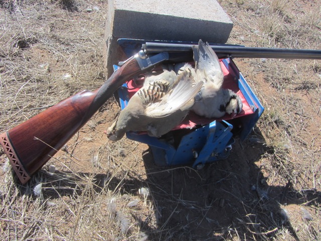

The "Pigeon Gun" lives! We had a great live bird shoot at the ranch, I shot my restored Remington FE. I didn't win but did real well! It was a blast shooting a historic bird gun at a bird ring shoot!
The chukar's were terrific out of the boxes.

You said in your post The Pigeon Gun Lives It is not a live Pigeon Gun it is, a F Trap. The 1902 Remington catalog list Pigeon Gun it is for live Pigeon shooting it has no safety and Ordnance steel barrels guaranteed for Nitro Powders. Your F Trap is nice I do not like the recoil pad its not original a Silvers pad yes. Sorry just getting technical sorting things give us something to talk about. I am in trouble now.

You got me....
I went with a Heart Hawkins pad, I like to shoot 3 dram 7 1/2 Federal Gold Medals for birds--second barrel it's nice to still be on the stock!https://www.trapshooters.com/threads/th ... ds.232322/
