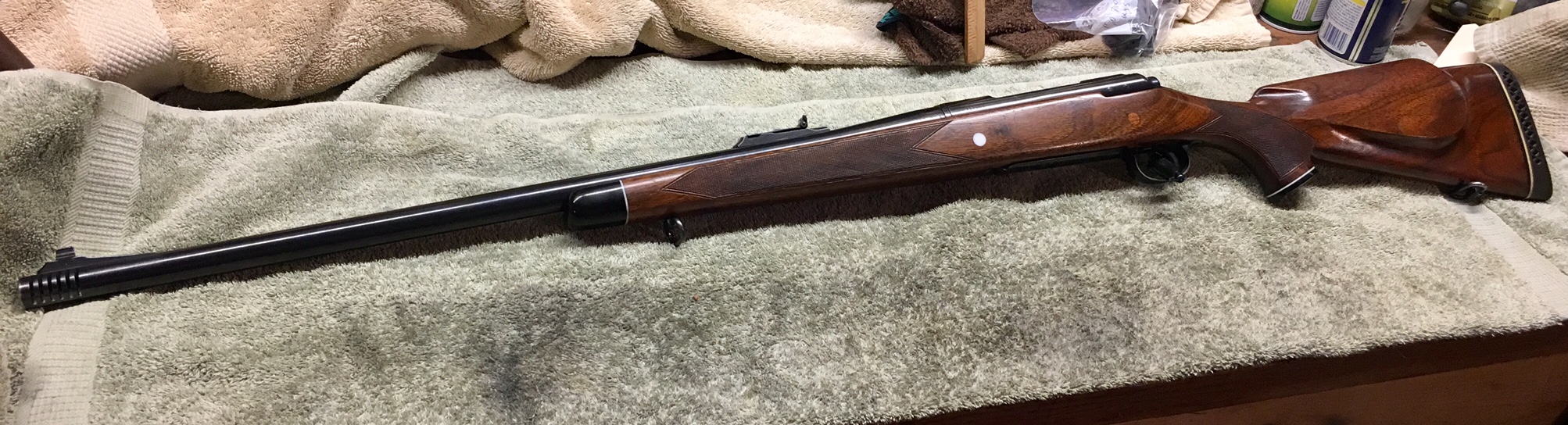

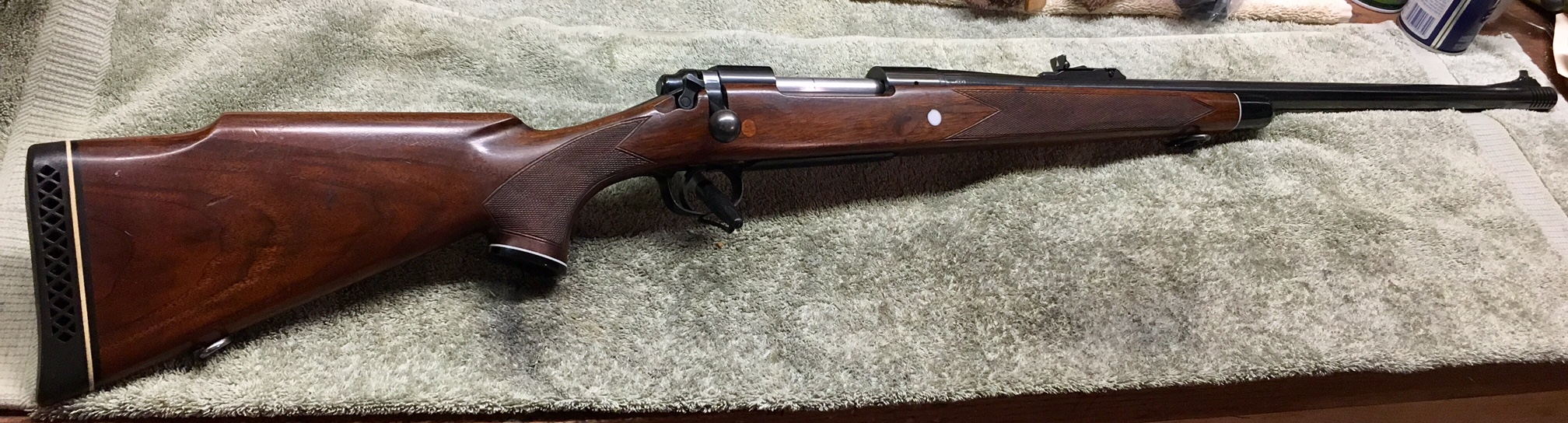

Hi John Taylor here I was reading back in the archives and came across this thread. I have a very similar rifle. This one is in 375 H&H

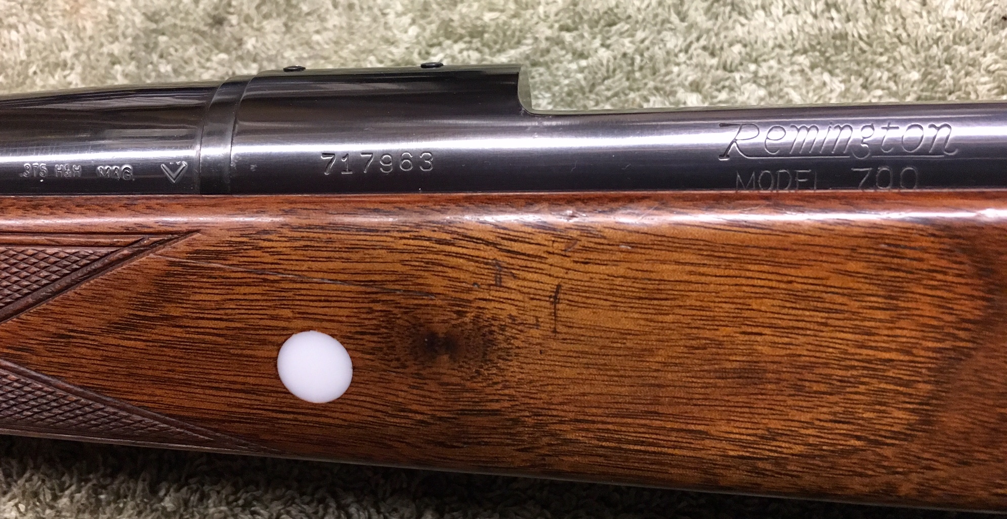

Notice the 725 serial number "next picture" and the Remington is stamped into receiver but the Model 700 is hand engraved also the white lug cover.

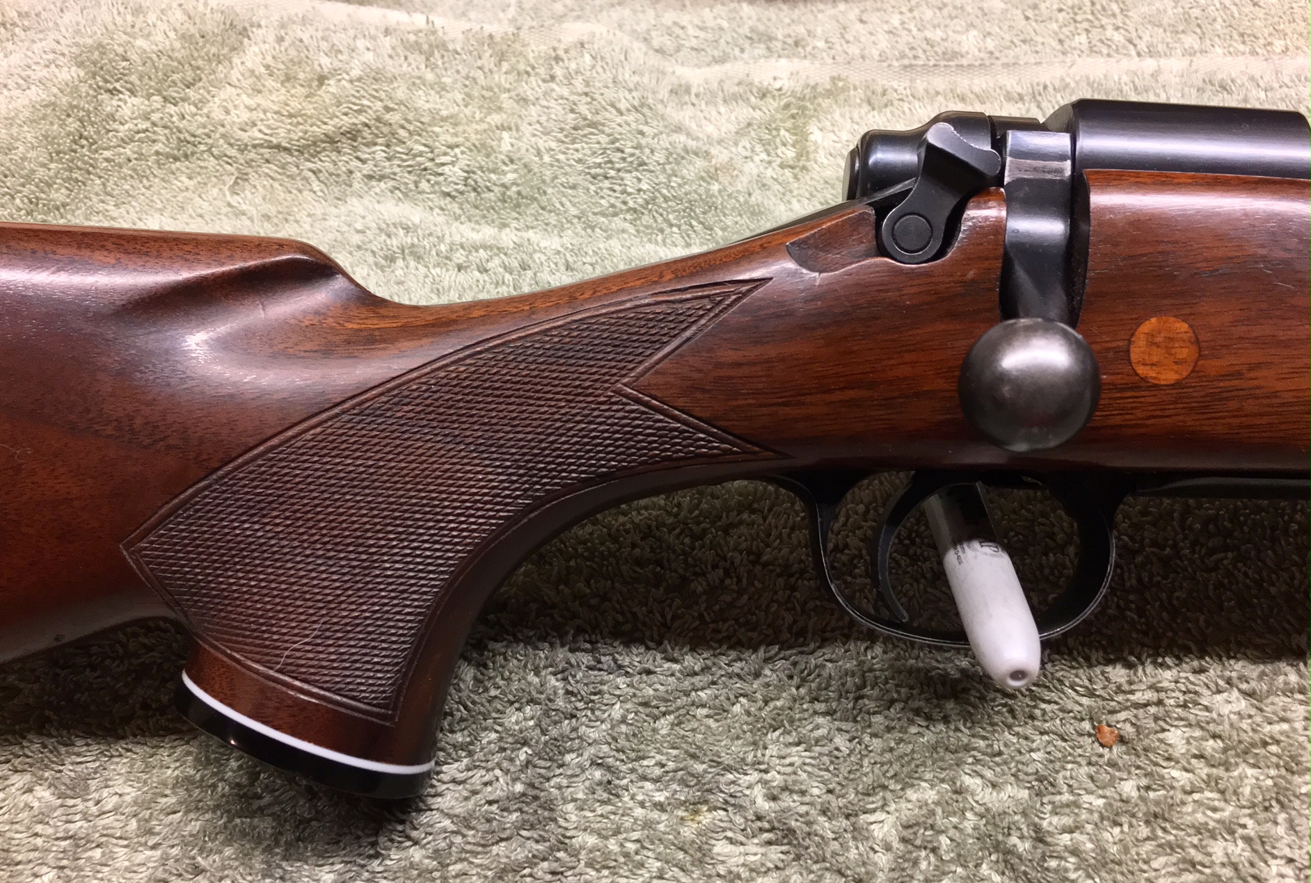

Next pic shows the 725 style saftey

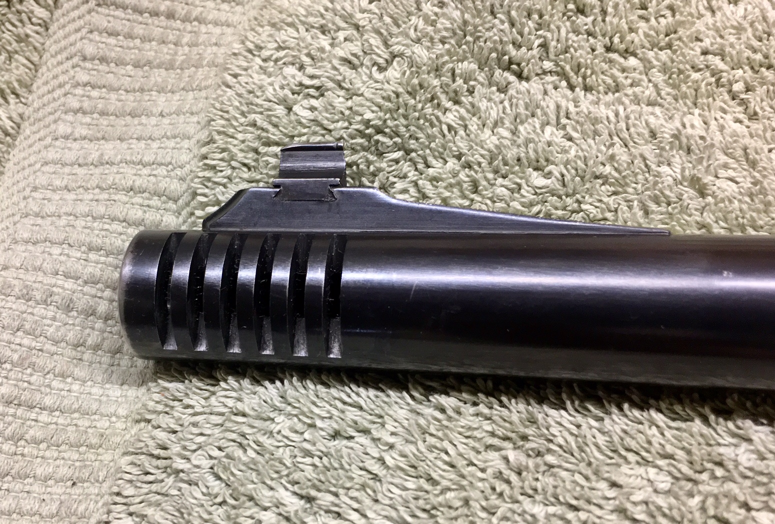

Also has the 725 Kodiak and early 700 Safari style muzzle brake.
