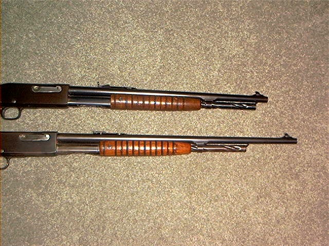

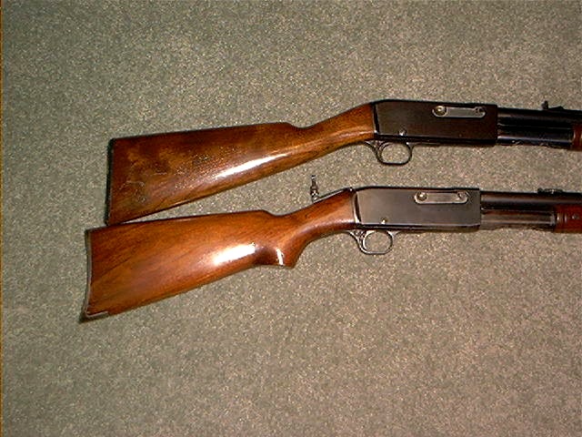

My Camera sort of sucks but hope these pics post.
For "Oldeadeye", that is a carbine on top......note barrel length. Also almost all carbines had straight stocks and not pistol grip style.

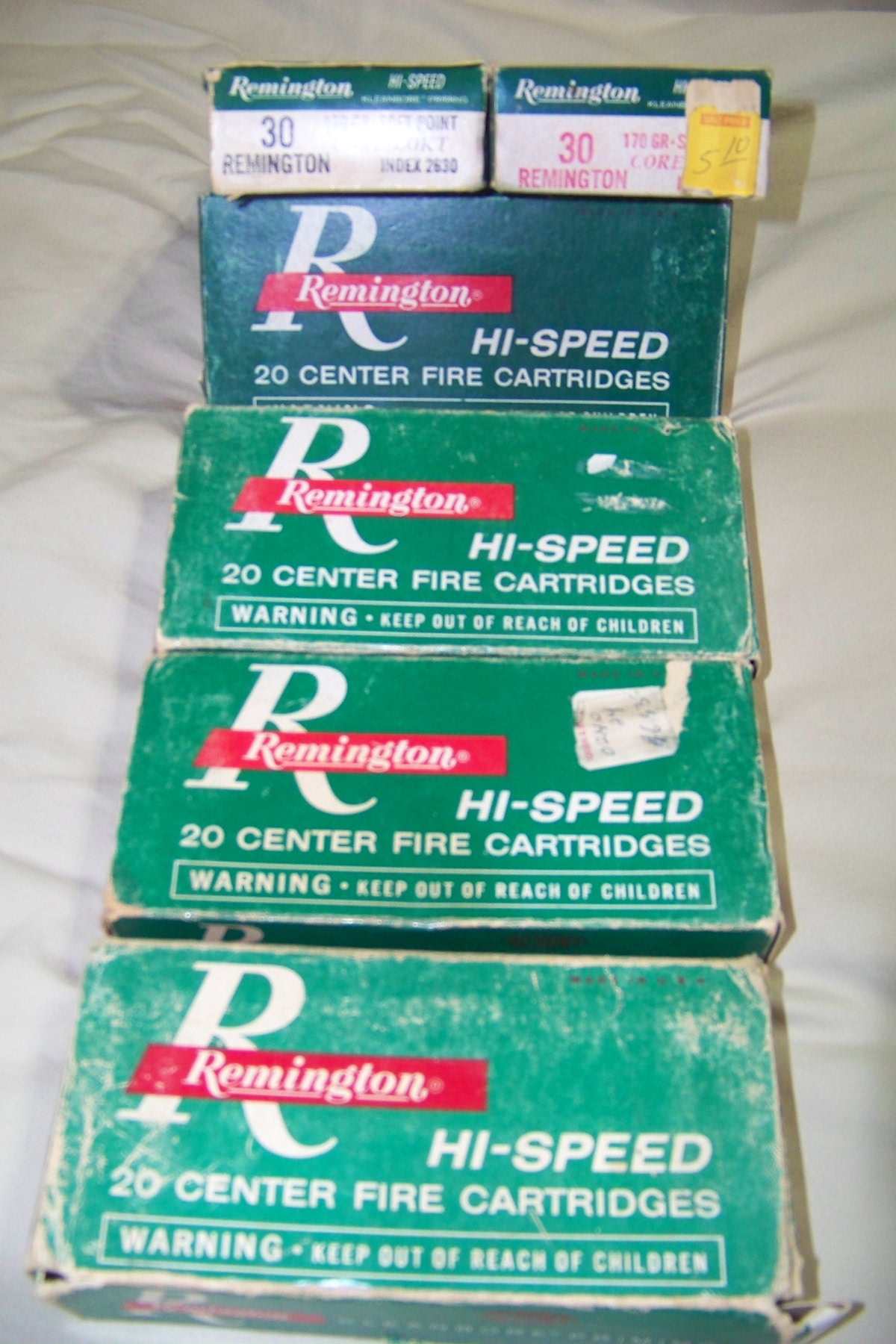

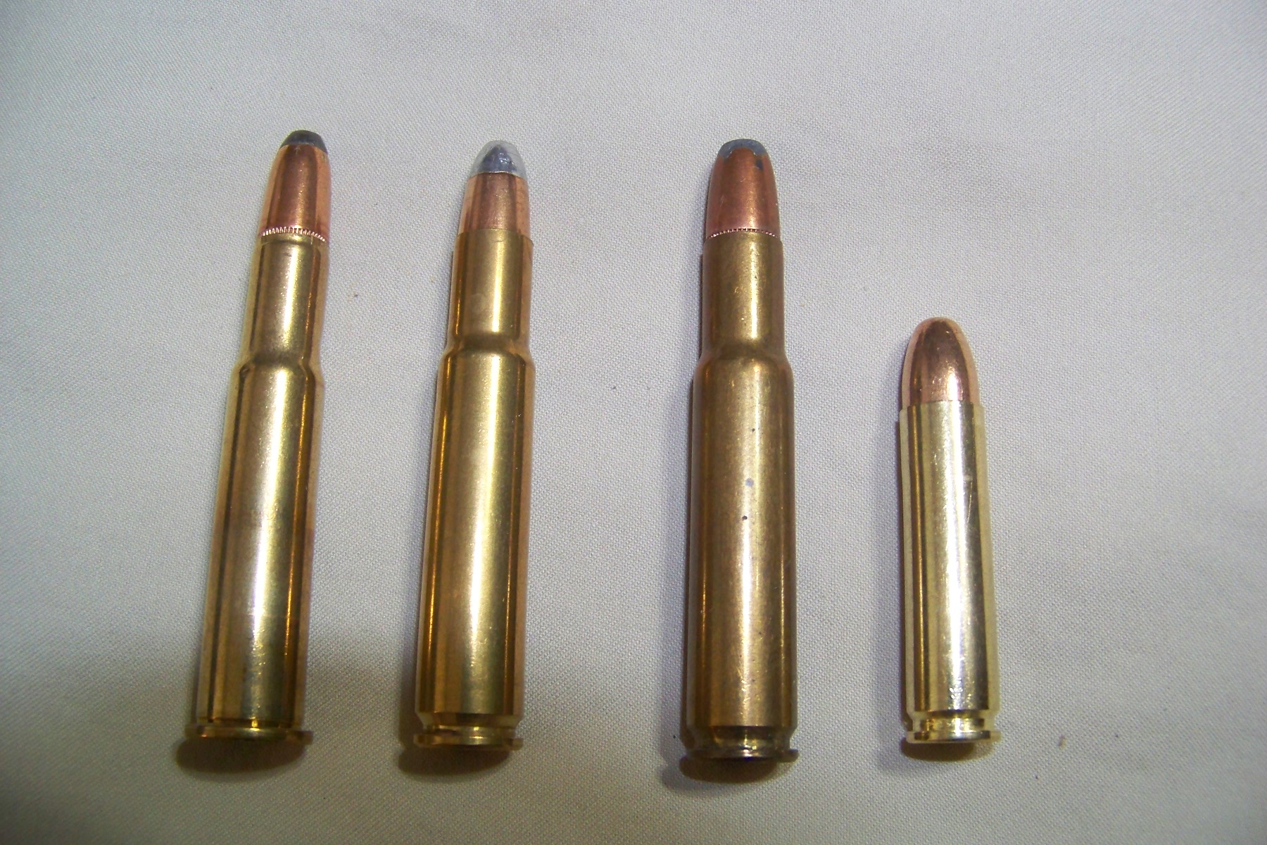

I also have a 14R and here is the ammo for this rifle. I inherited this from my Dad who bought it at a pawn shop in the mid 60's. I am also confused about the ammo. I ordered .30 caliber ammo and it is a small cartridge. The ammo I have is 30 Remington and I have 4 boxes that my Dad bought in the 60's. I am not sure I can find this ammo today.
Lft to Right 3030, .30REM, .30Rem, .30 carbine
