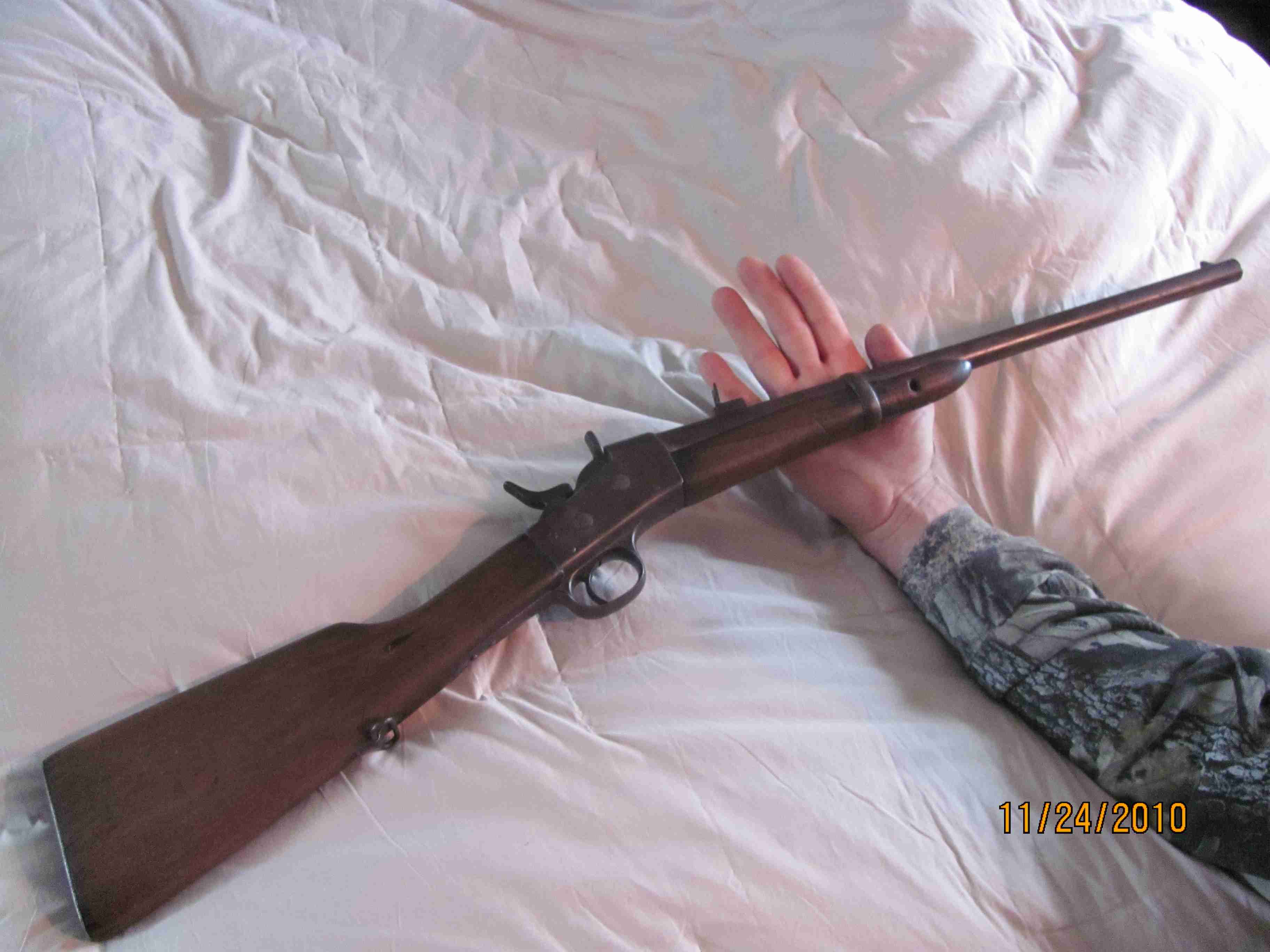

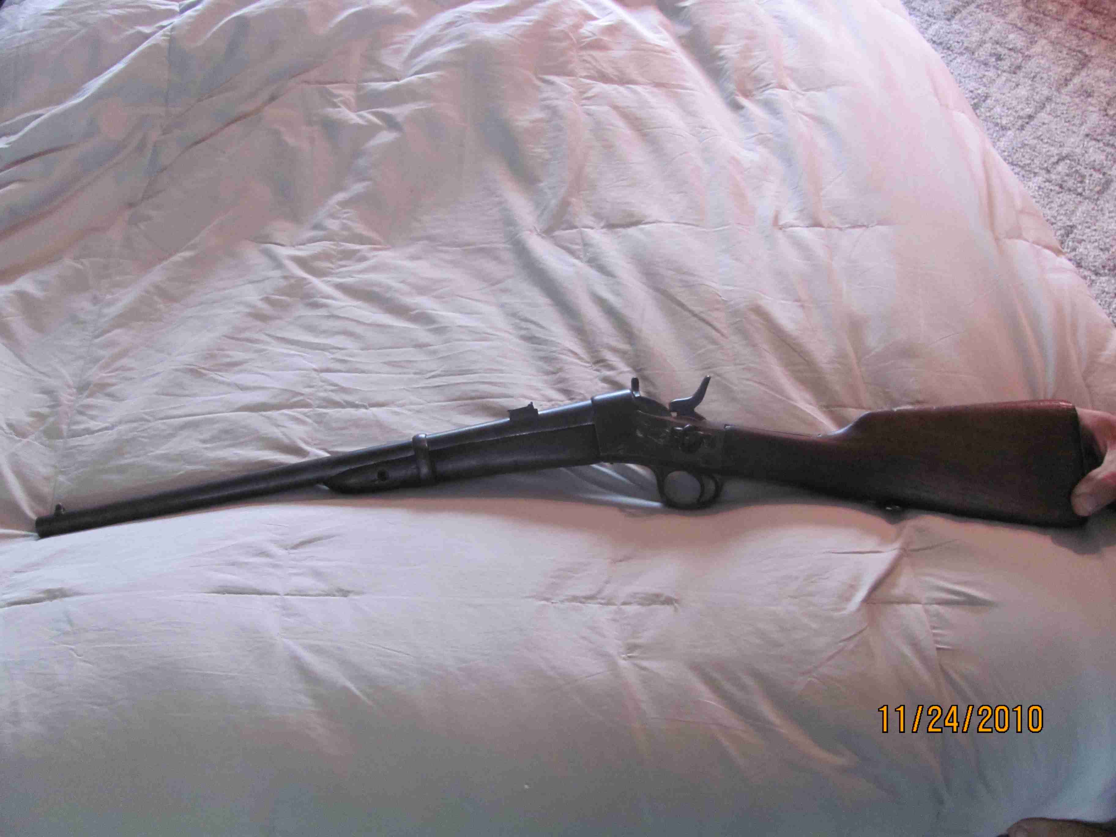

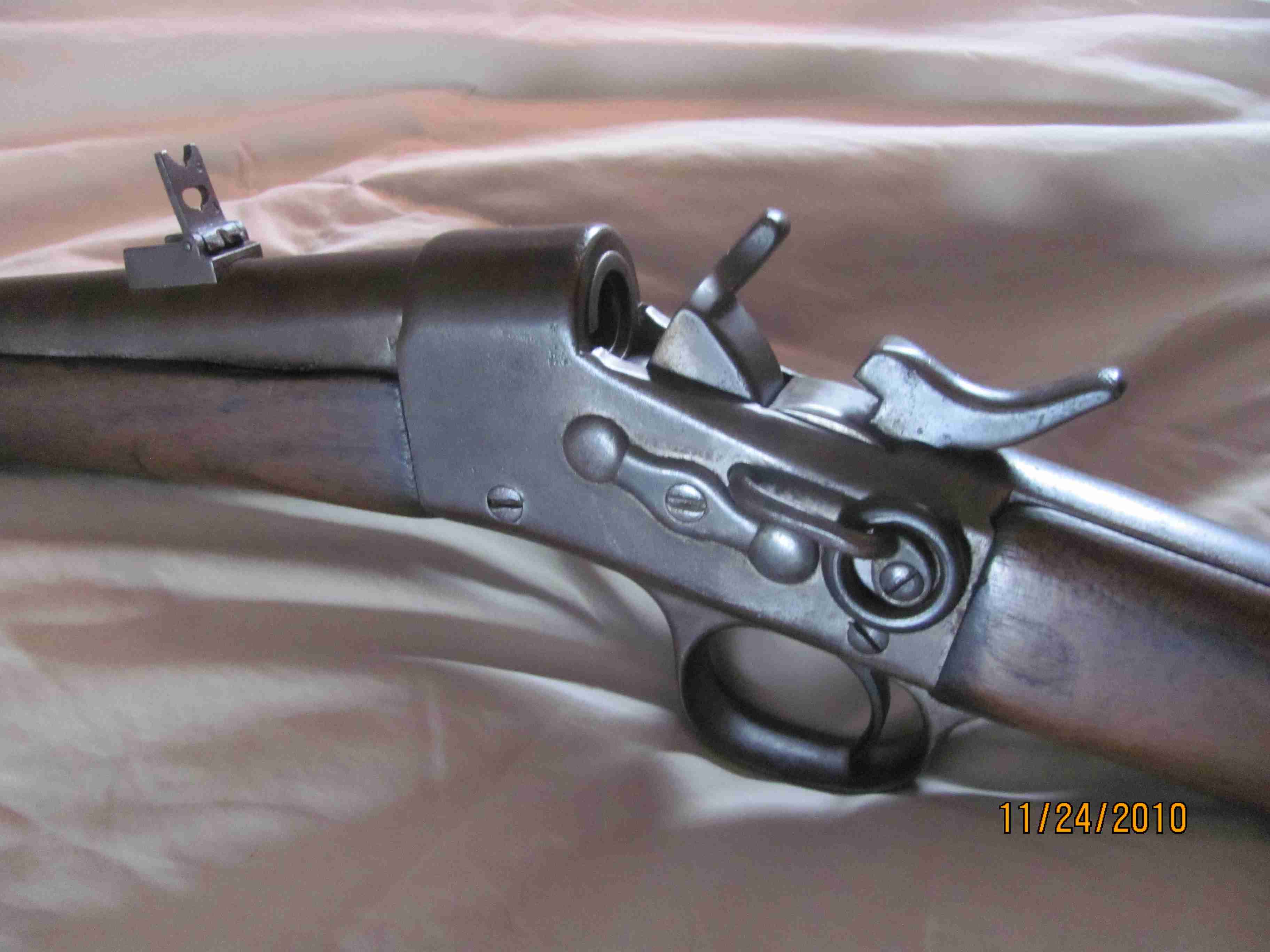

fmx_freak
Re: Remington Light Baby Carbine
Post by fmx_freak »
Hi, I'm wondering if this a remington light baby carbine...
ehull
Posts: 246
Location: So. California
Post by ehull »
Your carbine appears to be a standard military carbine, using the military sized frame (called No. 1 in sporting arms). The buttstock also appears to be from a later smokeless era rifle. Suggest you check the chambering; a .44 cartridge (as in the Light baby Carbine) would have a very short chamber as compared to the .43 Spanish cartridge.
