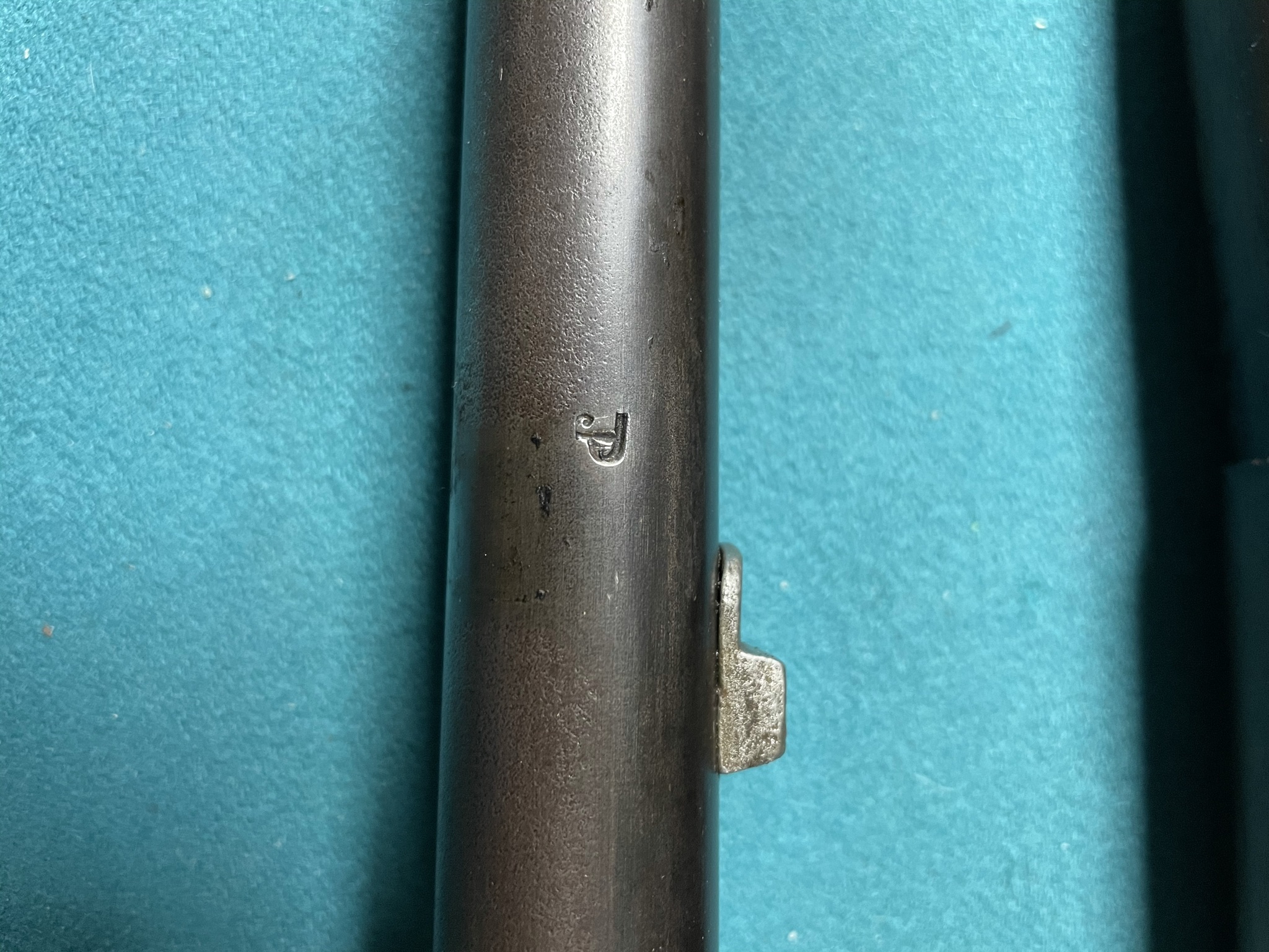

Added second picture of marking on barrel under forearm. Can anyone I’d this marking?

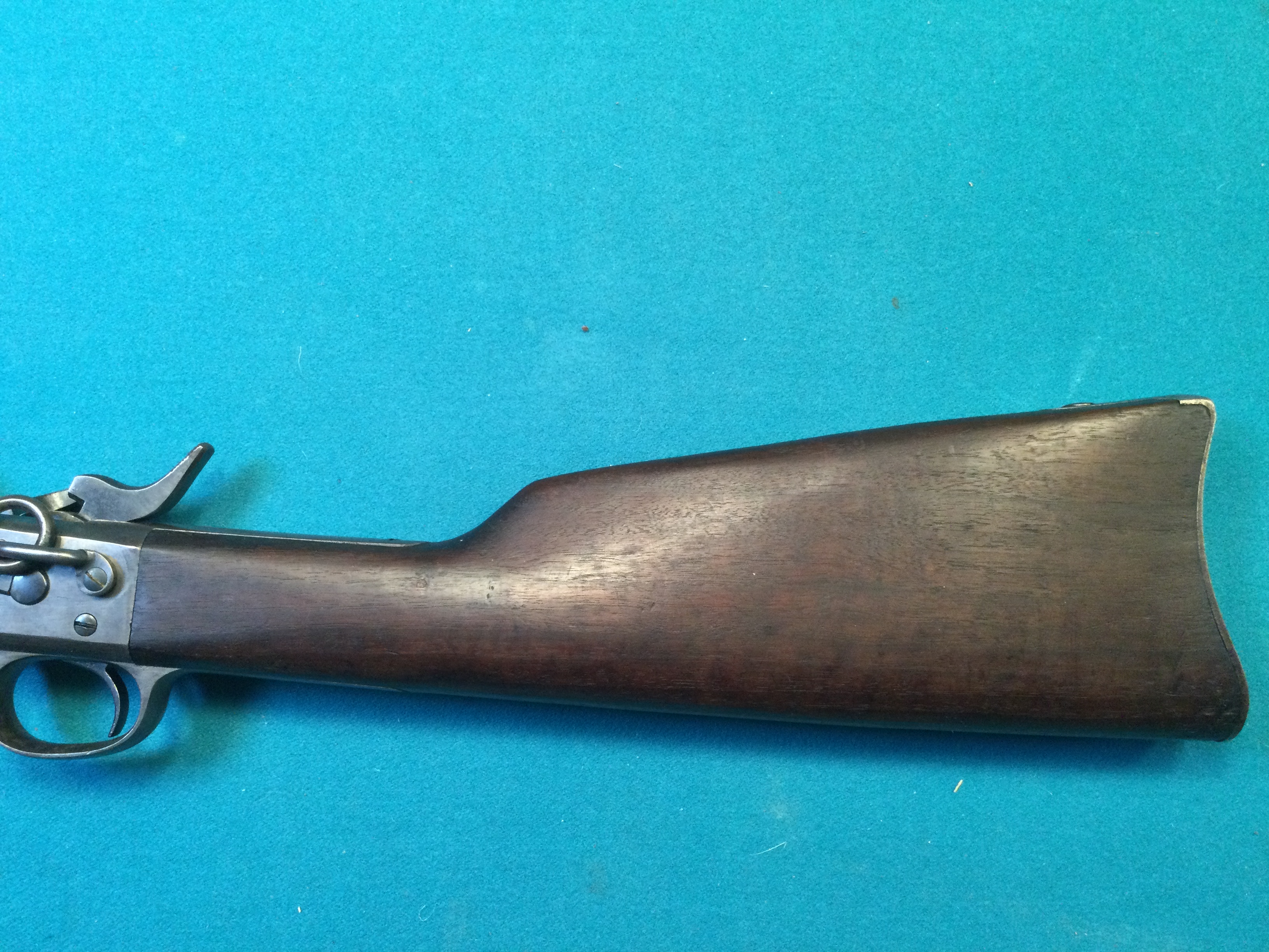

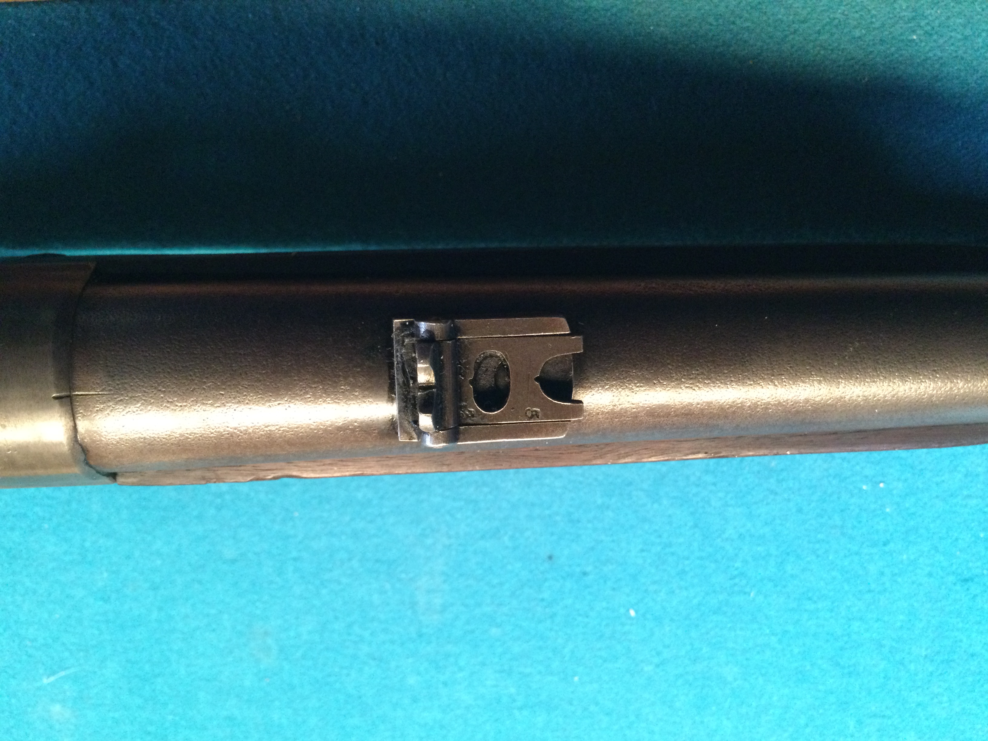

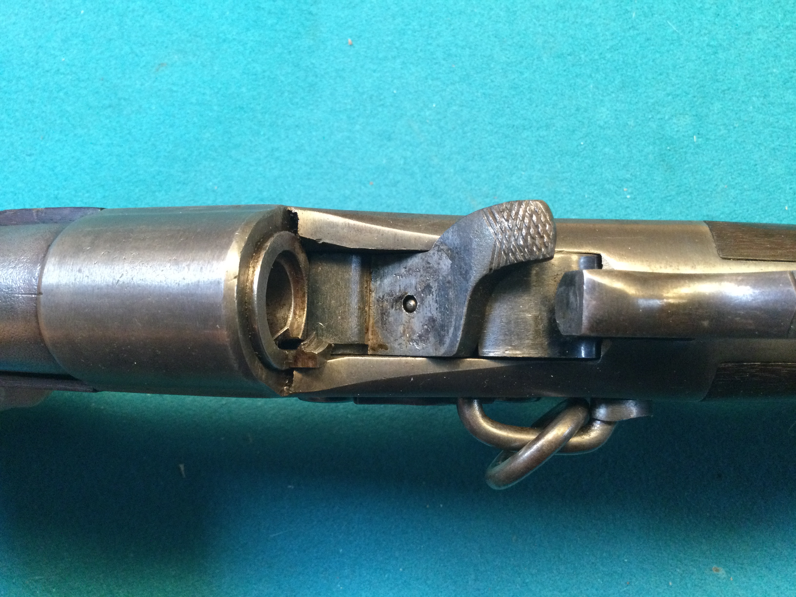

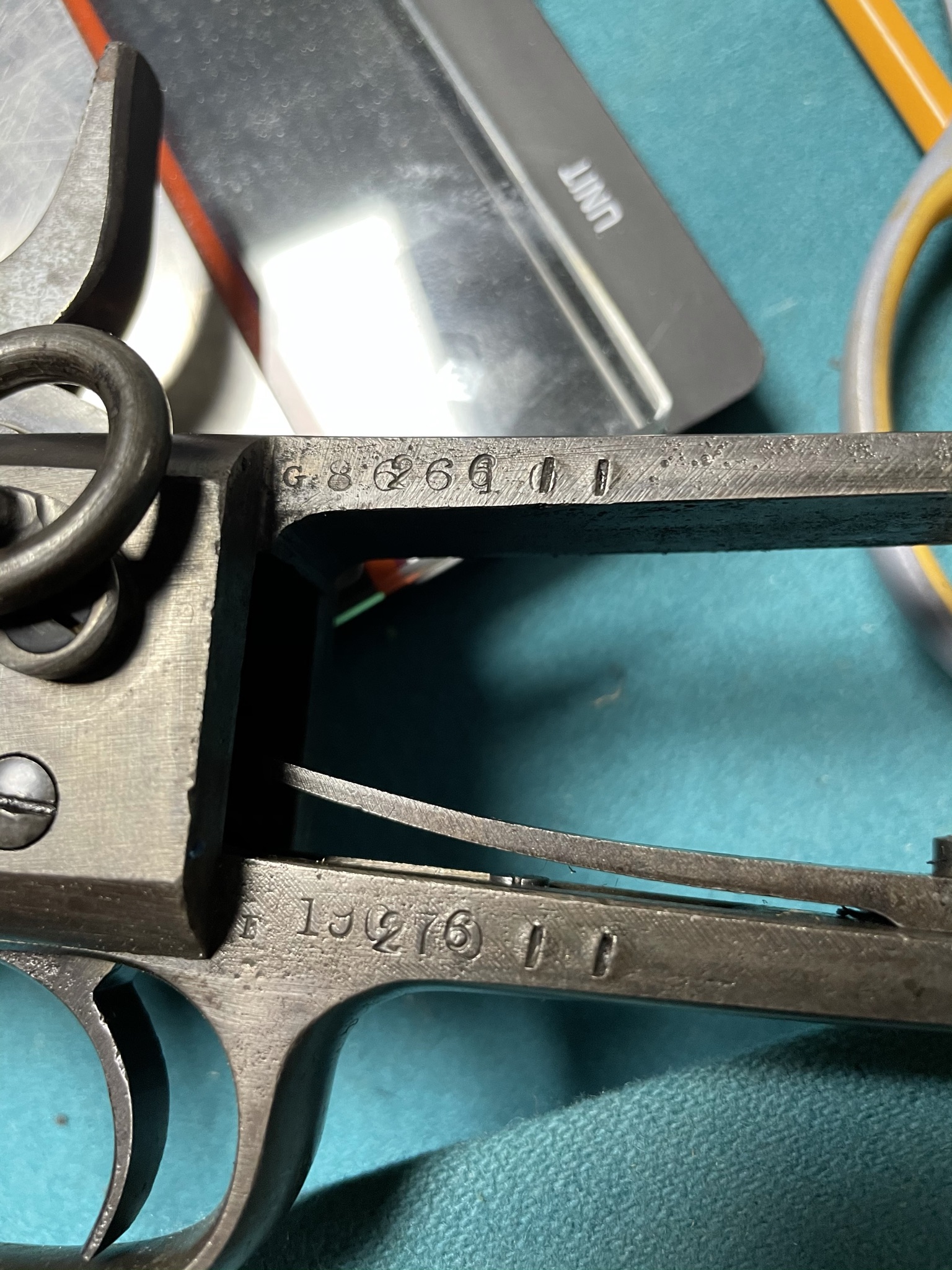

Webb, thank you for the reply, here I am attaching additional pictures.

Re: Rolling block Carbine 43 Spanish
Hi There,
The additional pics help. Unfortunately, it is not a USN
model. In fact the "US" on the left hand side appear
spurious to me. The US marking should be on the right
hand side plus there would be other inspector stamps
all over. Otherwise, it looks to be a very good condition.
This is a late type 2 action. It is believed that the type 2
was phased out in 1871 but this isn't certain. Your breech
block is the flat type which replaced the concave breech
block in August 1870.
Also, your extractor is the bar type (also called the slide
extractor). The USN carbine used a concave breech block
with the early stud extractor.
Your carbine appears to be correct for a factory carbine.
It has the correct front and rear sights and forend stock.
Less than 5% of the Rolling Blocks made at Remington were
carbines. Seeing that your carbine is .43 Spanish, I would
suspect this to be part of the 3rd. Spanish contract or one
of the many Central and South American countries that
purchased Rolling Blocks during the later 1800's.
Seeing the tang markings (which changed over time) would
also be informative.
Good Luck!
Webb

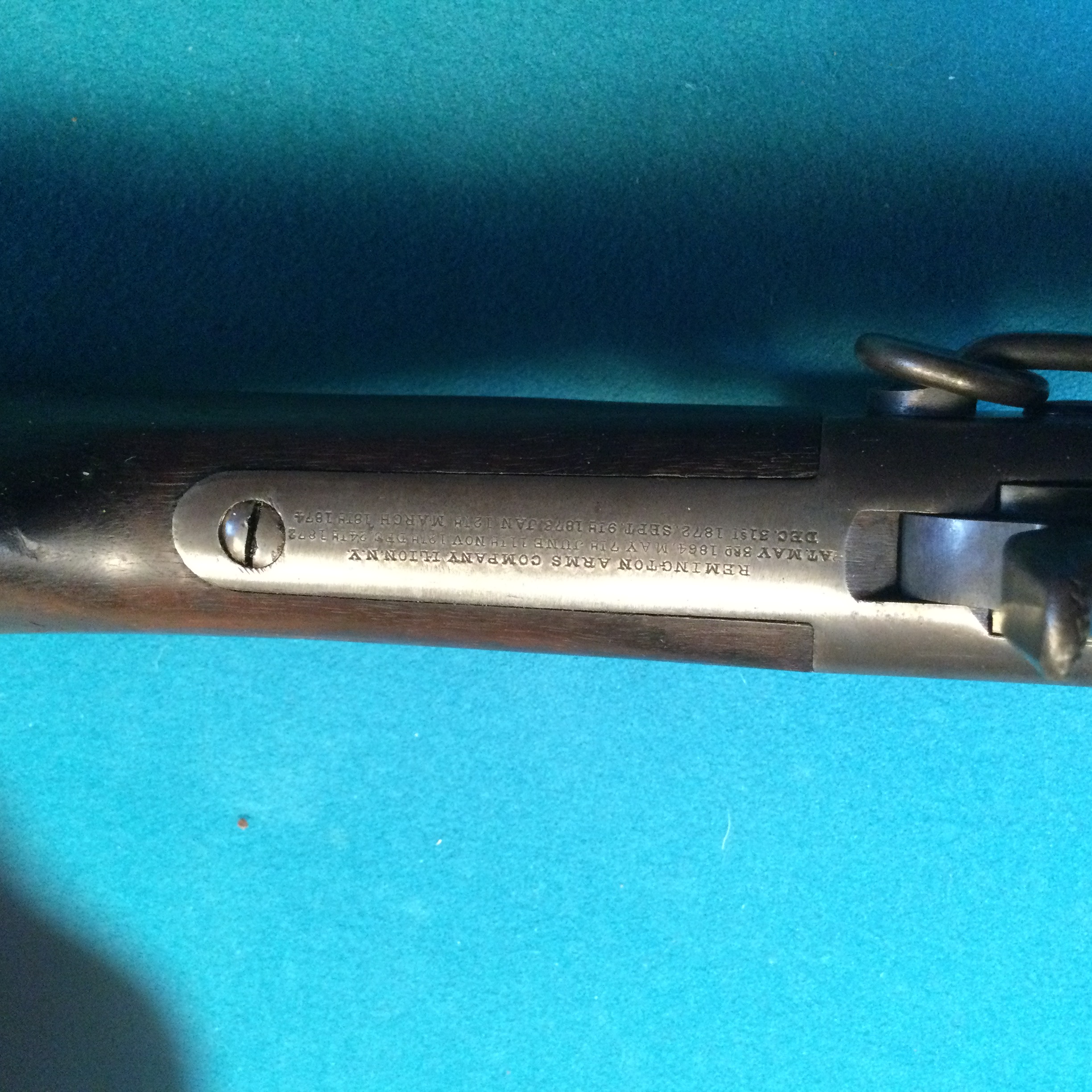

I am attaching a picture of the tang, containing the patent information.
From what I have read, doesn’t the “Remington Arms Company” indicate that this type 2 carbine would have been made after the bankruptcy in 1886-1888?
Do you recognize the stamped mark on the barrel, kind of looks like the letter
“P”? Could this be a proof mark or inspectors stamp?
Hi There,
You are correct that the tang markings indicate an 1888 or
later manufacturing date. It is unusual to see a type 2 action
that late. By that time, the type 4 action was well into pro-
duction (having been brought out prior to the bankruptcy).
Do you have a micrometer or a dial caliper to measure the
thickness of the receiver? I am wondering if your carbine is
possibly a light weight carbine (A.K.A. "Baby Carbine"). These
were thinner than the standard #1 (which measure about 1.312"
in thickness). They were built on actions that are about the
same thickness as the #1-1/2 action (which I believe was about
1.14" thick).
There isn't that much known about the light weight carbines.
They first appeared in the Remington catalogs just prior to the
bankruptcy. Many of the Remington records were lost during
the transition of ownership after the sale. At that time, both
Whitney Firearms and Remington were making this light weight
carbine and both companies fell into bankruptcy and were
purchased by the same investors (Marcellus Hartley and Winchester).
Winchester's motivation for investing was to stop the sale of the
Whitney-Kennedy lever action rifle and eliminate it from competition
(Winchester wanted to be the only manufacturer of lever action
guns and buying companies in bankruptcy gave them control of
the patents on those other lever action rifles).
Measure the thickness (if you can) and report back.
Good Luck!
Webb
