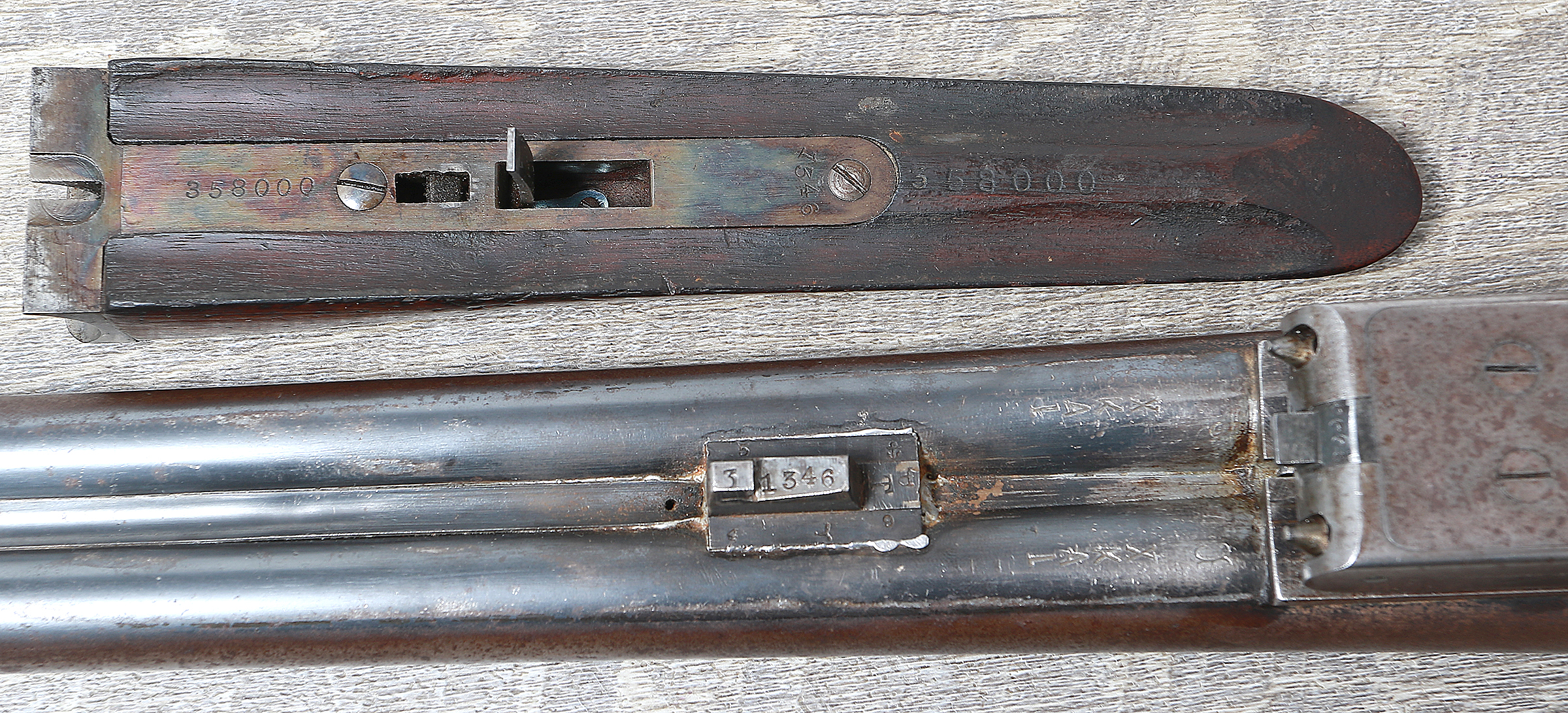

I have a model 1900 16 gauge, with markings and serial number Q358000? Does anyone have any info please? I'm selling it for a friend of mine on Gunbroker. First time on this forum and I don't know how to post a photo?
- 15.jpg (3.22 MiB) Viewed 3457 times
